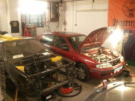

The Micra with the donor Primera:

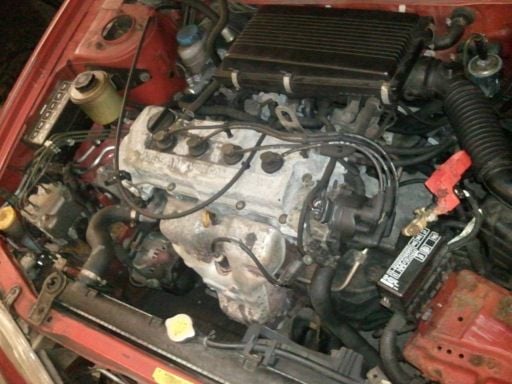

The Doom Buggy's new heart!

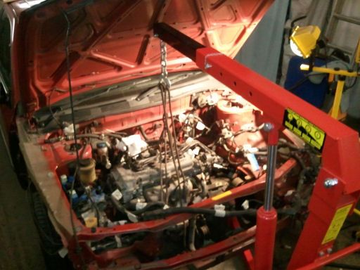

Out she comes!

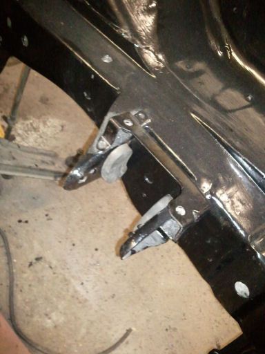

Driver's-side Engine mount:

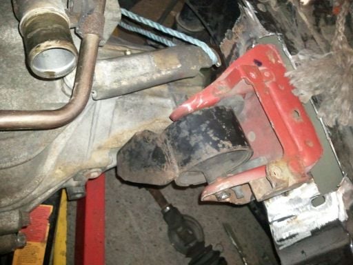

Passenger-side Gearbox Mount:

Mounts fully-enclosed, welded and painted!

Nice work, scary amount of cutting on the chassis though. Was there really no other way of moving the engine over a bit?
Thanks very much!
RE: the chassis - Tell me about it! :/
I wasn't happy about it myself, but the adjuster that comes down from the belt pulleys, as well as the pulleys themselves were a pain to get in. I've reinforced that whole side with 2x 2mm steel plates, so it's pretty sturdy.
There was a reason why I couldn't move the engine over, but I can't remember what it was! Something to do with the mount if I remember correctly. Besides, if all goes well, it'll be a lot easier to work on the engine!

2mm plates wont have the same strength as a box member chassis rail tho eh steve, cant you add some reinforcement on the other side of the flitch ?
Ah fair play. I'll be doing one of these soon. Will be interesting to compare notes. I'll be following this with interest :)
Ha! You're the expert here! But I'll help out with what I can! :)
I know, I'll just have to see what happens I guess!
I have a large 2mm plate on the engine side and on the arch side so there isn't too much movement one way. Anything you could suggest to beef it up?
