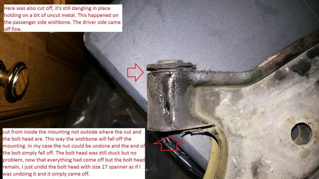

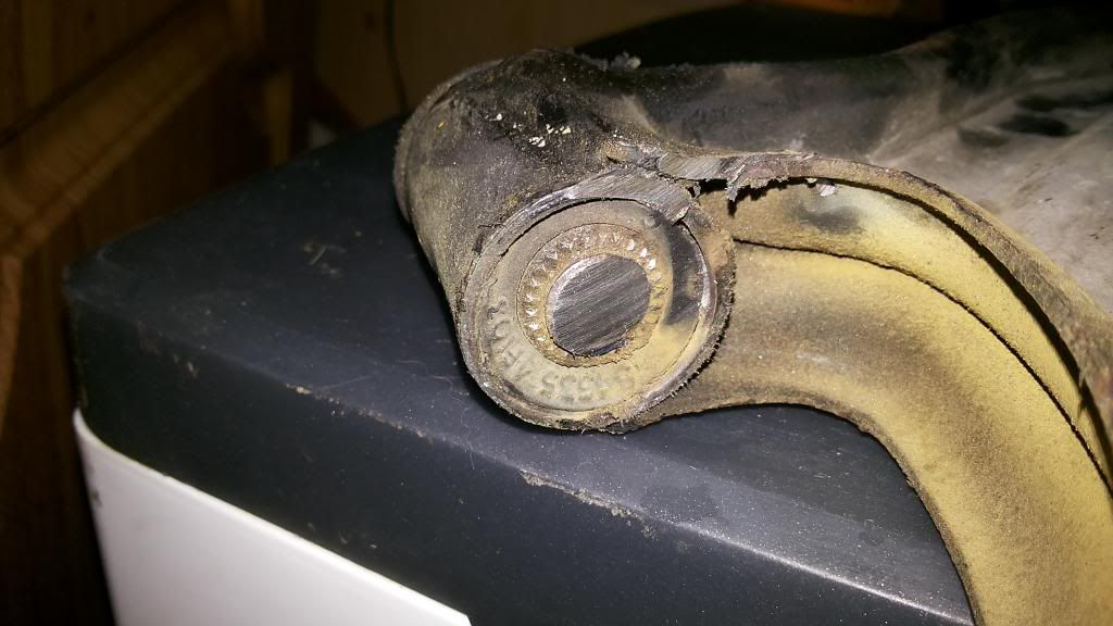

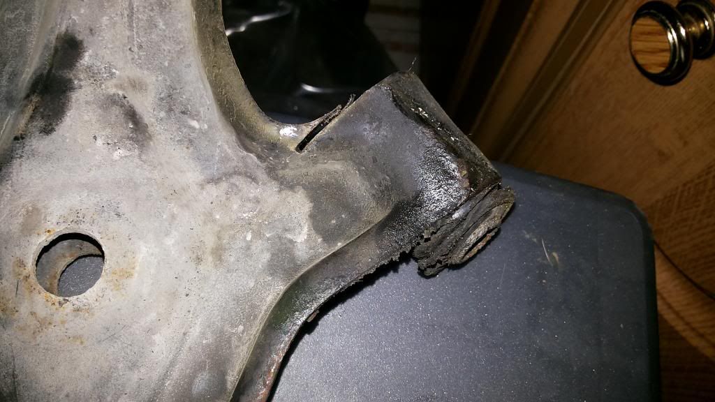

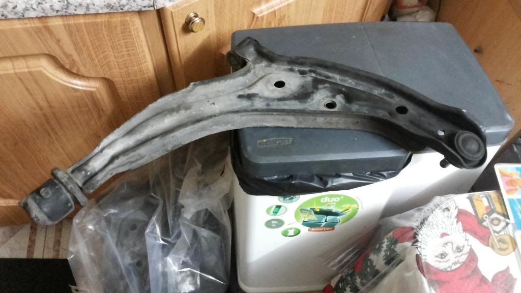

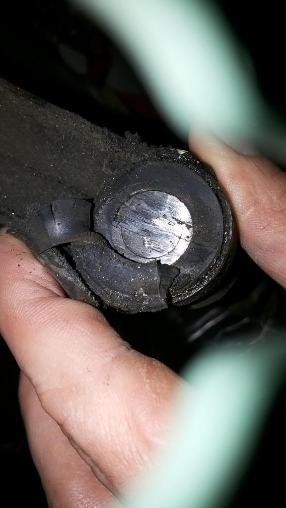

eyy man sorry for taking long to reply. No worries abt hijacking anything. Just did mine yesterday, turned out piece of cake. I've taken some photos to show from where we had to grind the bolt that was fused inside the bush. BTW this only happened on the passenger side thankfully :) . Important to cut the bolt's body from inside of the mounting not from the outside where there's the nut and the head, since in my situation the nut did come off ok. this way the wishbone will drop off upon cutting and then the bolt's end falls off where the nut goes and the head was still stuck but this time not attached to it's body I simply unscrewed it with size 17 spanner as if to undo it and it fell off too.
bolts I bought stainless steel 12 body thickness and 70mm length, but the ones I found had all the bolt's body threaded and I worried that the bush would be damaged resting on a threaded surface. So I got galvanised ones which had half the bolt's body smooth and the rest threaded also 70mm and got new nuts with nylon the new sort of nut nowadays.
fused bolt inside wishbone
Cut off bolt from inside of the mounting
Cut off both sides of the wishbone mounting without damaging the mounting on the car since the new one must fit in place
