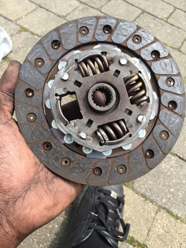

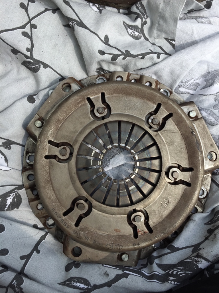

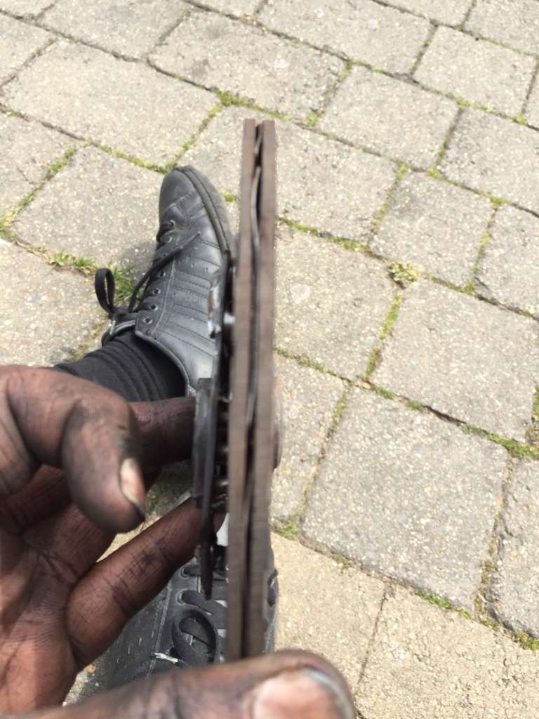

yikes, well there's ur problem :p looks like the clutch plate dampening springs have snapped oddly, u or mom done any aggressive launches in it? :D
also looked like the release bearing travelled too far (applied too much cable tension in attempt to compensate for the broken clutch plate that's not allowing it to fully disengage?) & struck the PP

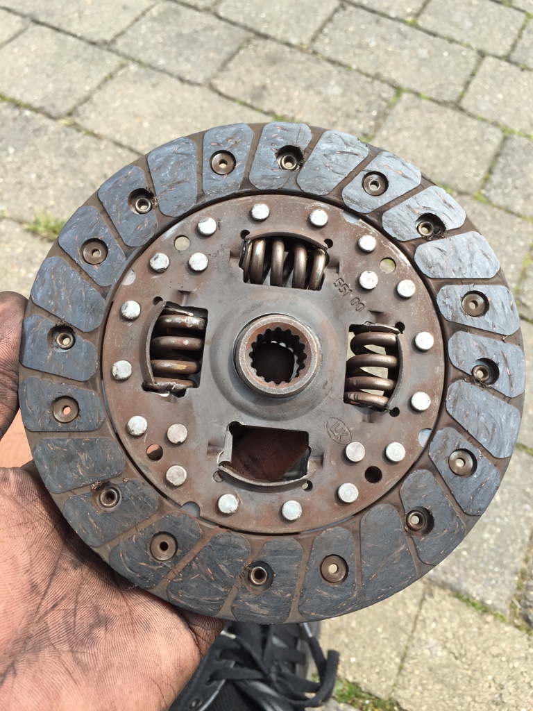

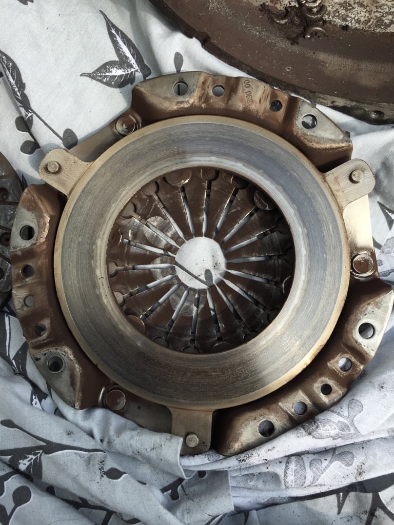

@pollyp pp came out so the clutch came out same as pp came out. Now I forget which side that I need to put the clutch face to flywheel
the flatter side of the plate faces flywheel so nothing should foul the flywheel bolts, the side with all the hub/springs etc petruding out points to the gearbox

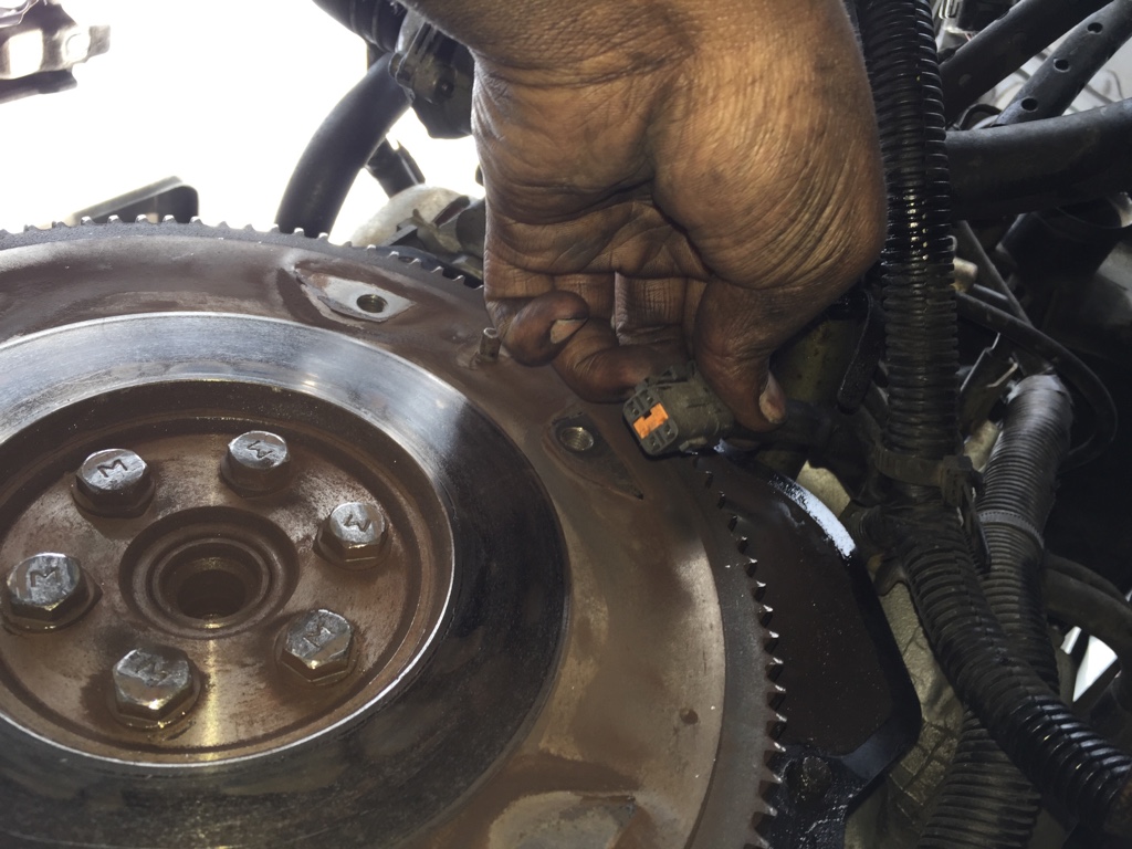

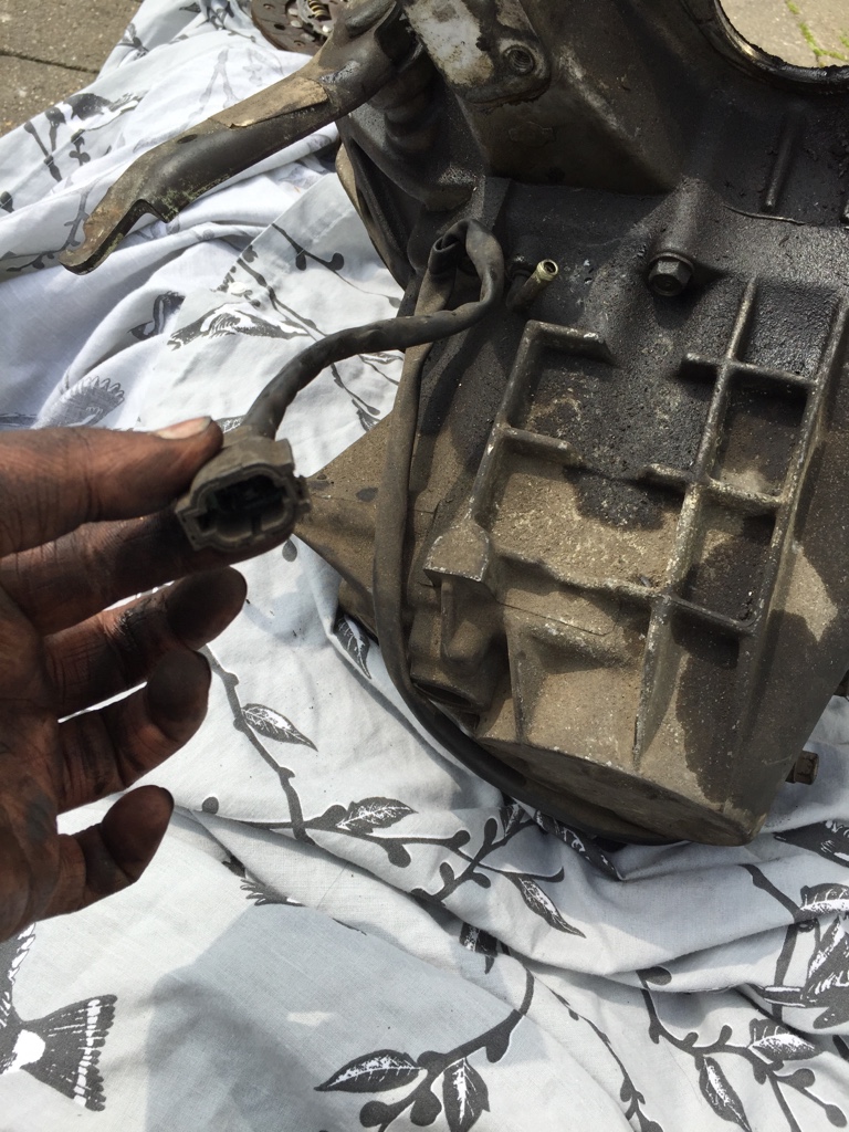

Cos reverse plug is on the gearbox.
How can this gearbox reverse plug to other plug. I don't see other plug so will have a look now
jeez that plates messed up, no wonder it's not working properly cos the unbalanced warped plate was constantly wedging between the PP/flywheel
Flywheel looks ok yea so will need to clean brake cleaner. Its luck clutch kit so it look like fitted last year before mum mum bought
Ok I am off to get new clutch kit and parts. Will regrease in this present gearbox but will follow on Haynes manual k11 PDFs
Last thing. How can I clean this flywheel? I can use this retainer clips on new clutch bearing and regrease around that area.

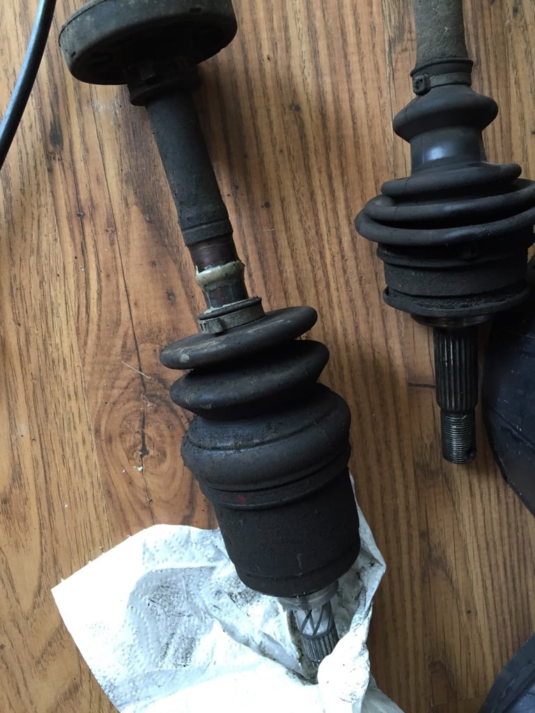

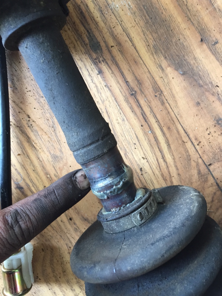

Is it possible if I can clean this gearbox inside and outside with using wd40. These driveshaft inputs got covered by thick tissues. Oh yea driveside driveshaft inner got disconnect so is it possible if I can reboot or not?
maybe I need to reconnet this clip on that above line
urm u clean flywheel with a rag & brake/carb cleaner till it's shiney?

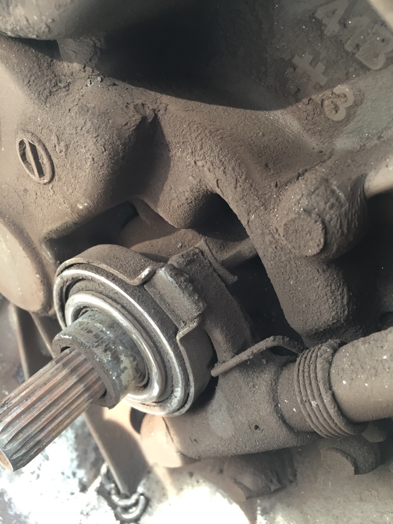

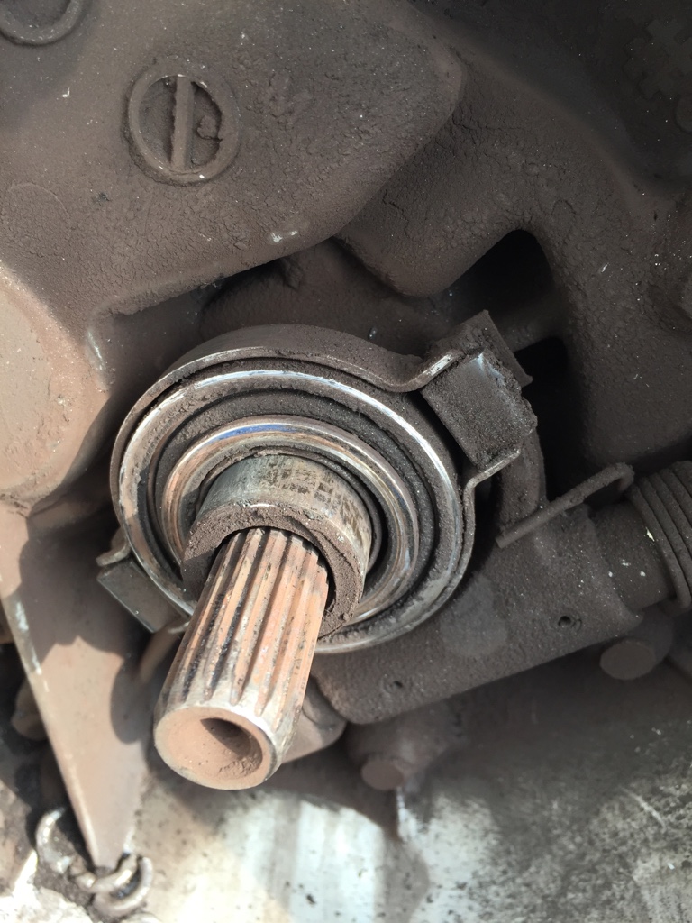

remove old release bearing, swap retainer clip onto new one.
wipe clean all the dirt off the input shaft collar, input shaft splines, clutch fork end,
smear some grease on input shaft collar, input shaft splines, clutch fork end, where release bearing touches the PP.
also a drop of oil into where the clutch arm pivot swings on the bellhousing.

ermm did you yank! the driveshafts off the gearbox via pulling on the shafts & dislodging the inner boot rather than follow haynes guide on carefully levering the inner CV out the gearbox via a small access gap with flat-head?
and for the reverse switch plug, if the plug u found fits, it may work. most of the time I find the loom plugs are unique to their sockets.
