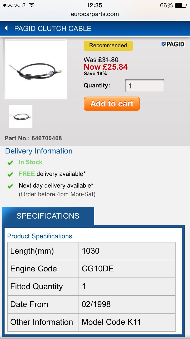

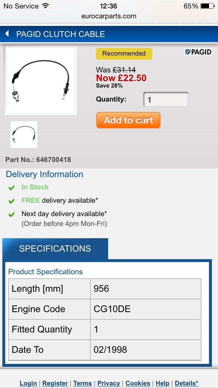

956mm or 1030mm clutch cable ?

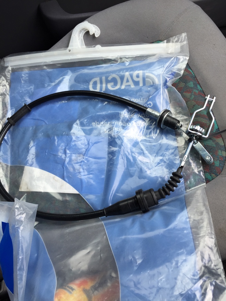

New clutch cable is here so will need to put starter motor back now.

U know new clutch cable so do I need to put some wd40?

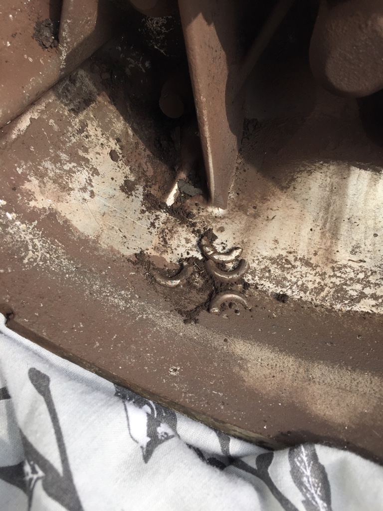

also another thing in that pic, was there a long rubber tube attached to that breather port at the top of the gearbox? cos if the gearbox was overfilled and the oil expanded alot when hot, it could spew out the exposed port and cause the oil stain mess in the pics
Old cable that I can reach to the end of thread. This new cable that I can't reach to the end of tread. The beer cap is very hard to adjust its burning my finger. So I am taking a break now to drop my sister, I will be back within a few hours.
This rubber tube wasn't connected, so I will need to chop the bottom part which is split.after that I will reconnect it.
