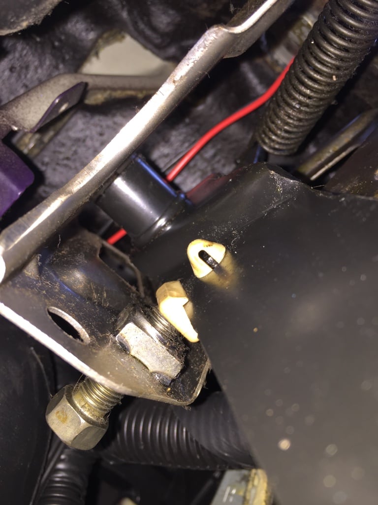

The nut and beer cap was close each other at the end (where it's rubber mount in with bracket) . I tried to adjust about a few cm front so it was nothing happen. This clutch pedal was become loose as well.
I tried. It's hard to select these gears. Only reverse gear was crunching noise so I had to put neutral
this clutch pedal is still connect to this clutch cable. if i loose it then the clutch pedal will be loose as well. i had to put it back then this clutch pedal came in normal way. still it wont let me to change these gears tho.

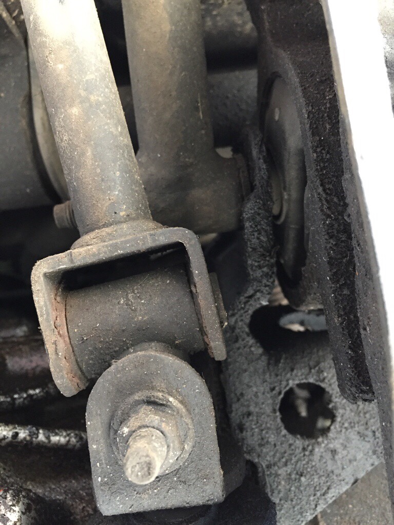

if just the selector rod bushes were worn loose, you should still be able to engage 3rd/4th if the clutch was fully disengaged whilst running engine.

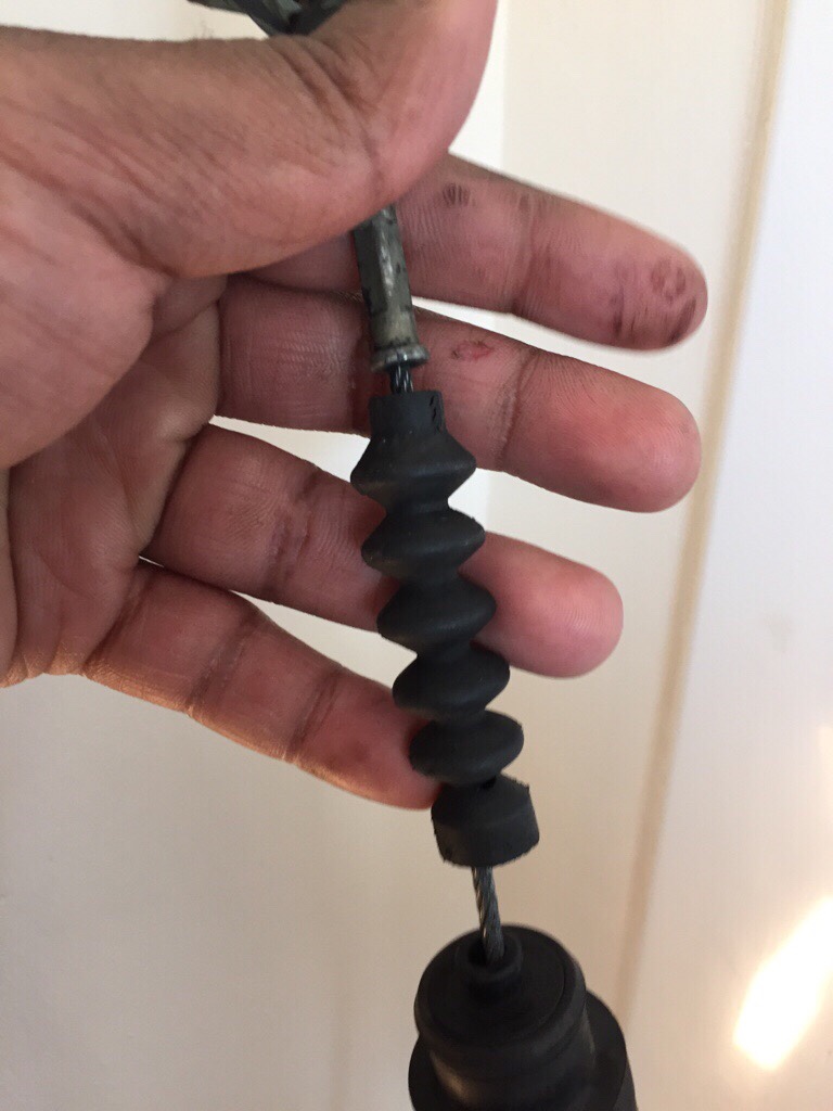

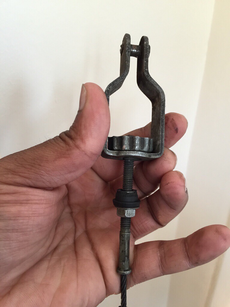

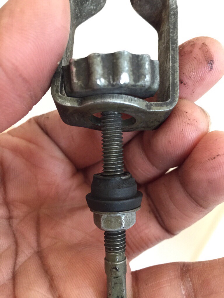

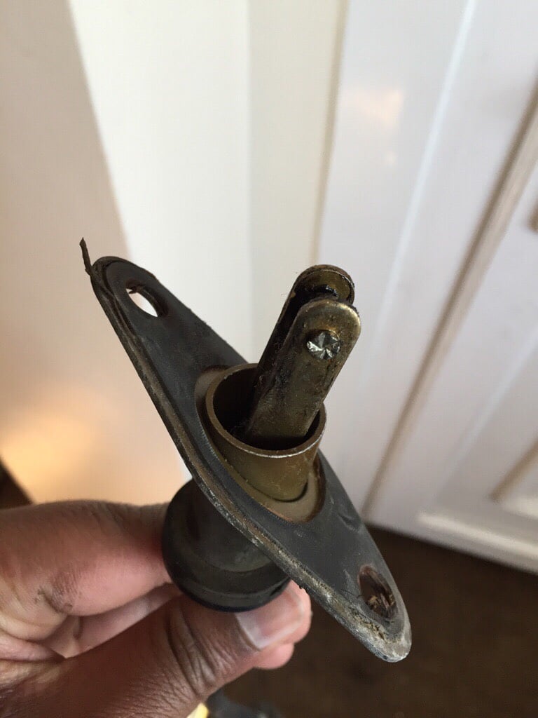

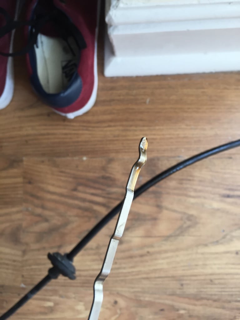

Sorry guys, my phone was broken so I managed to get another phone. I managed to get this clutch cable out so I will upload pictures of this clutch cable in an hour time. ( I am out atm) I will need to do regrease this linkage and also gearstick ball tomorrow. Oh yea, will need to check rear mount so it was bouncing when these gears was changed around.

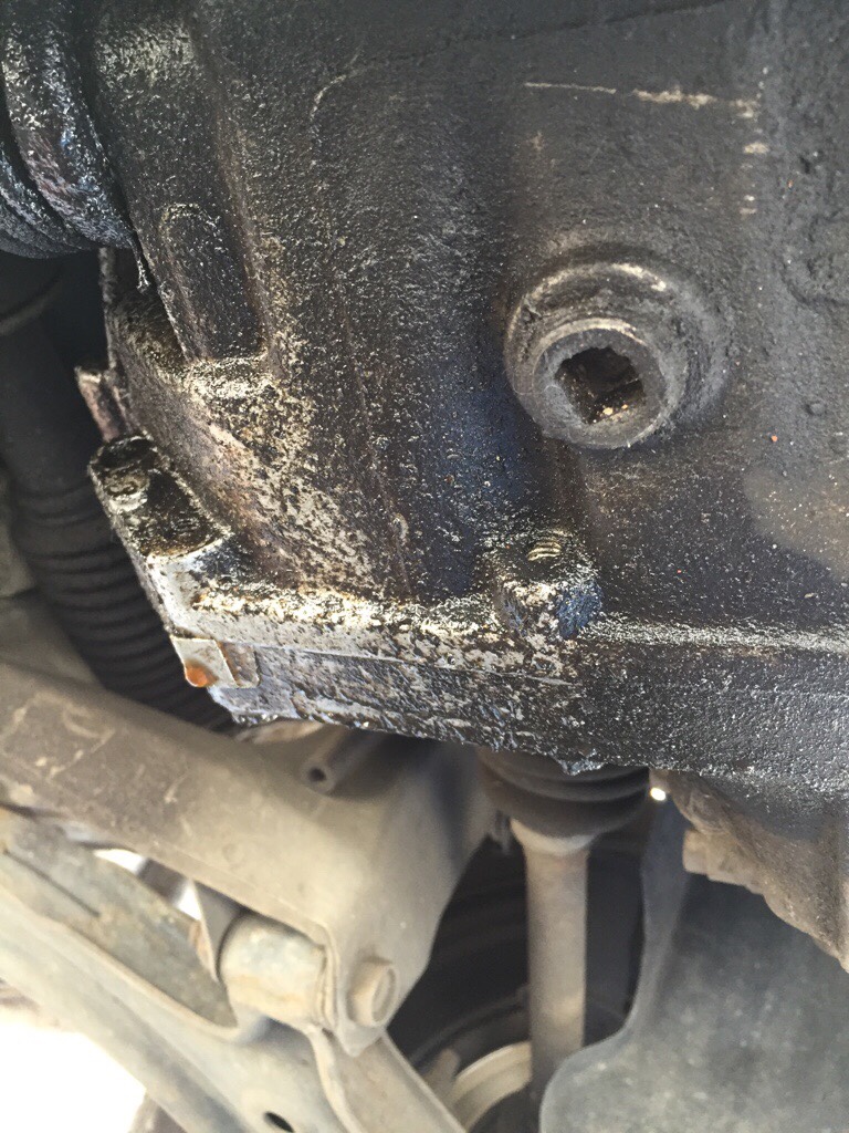

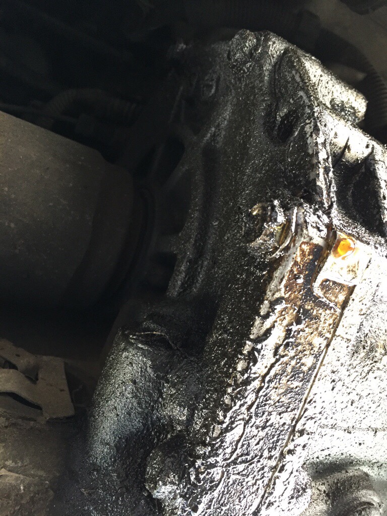

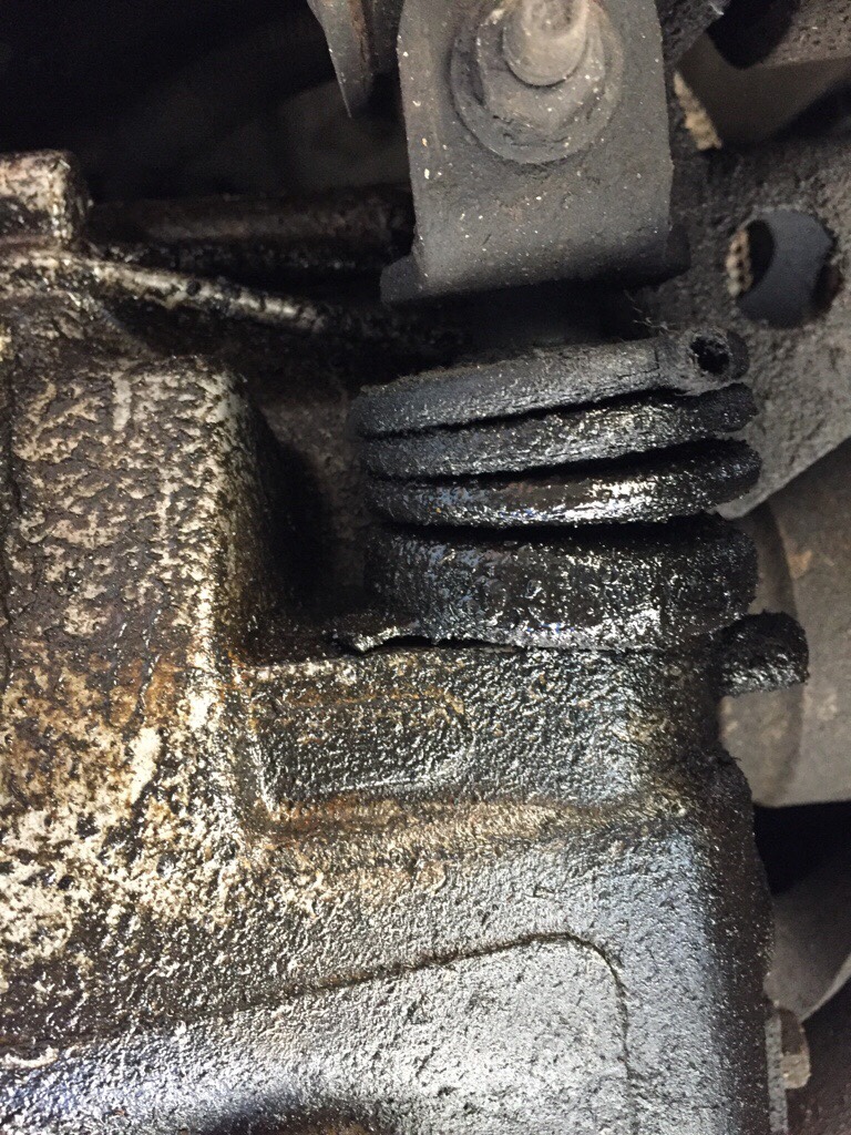

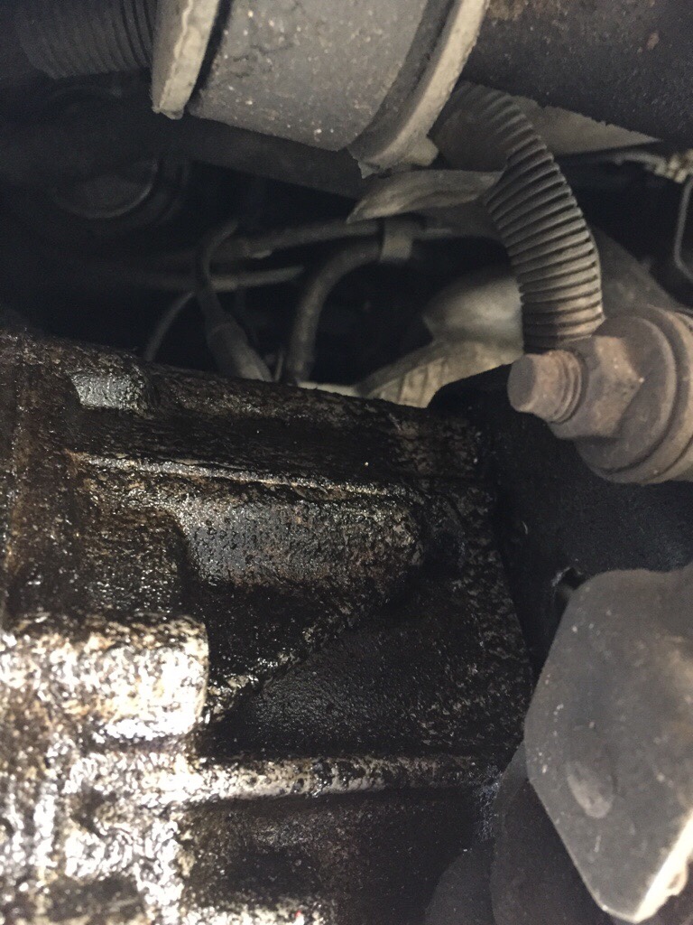

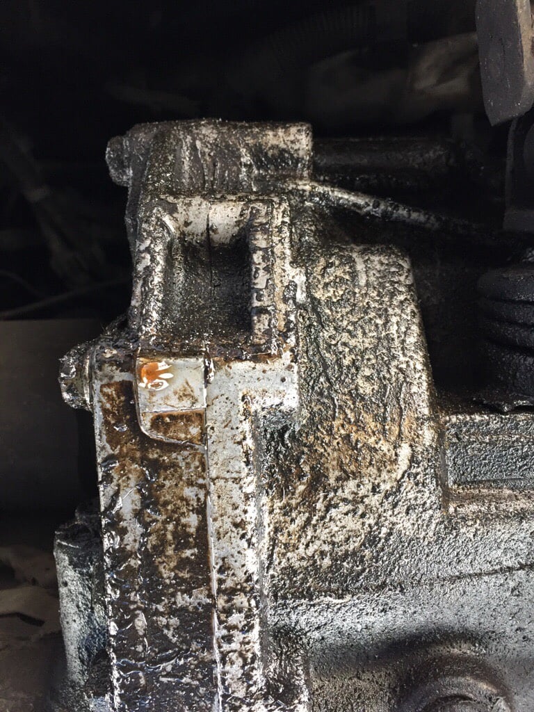

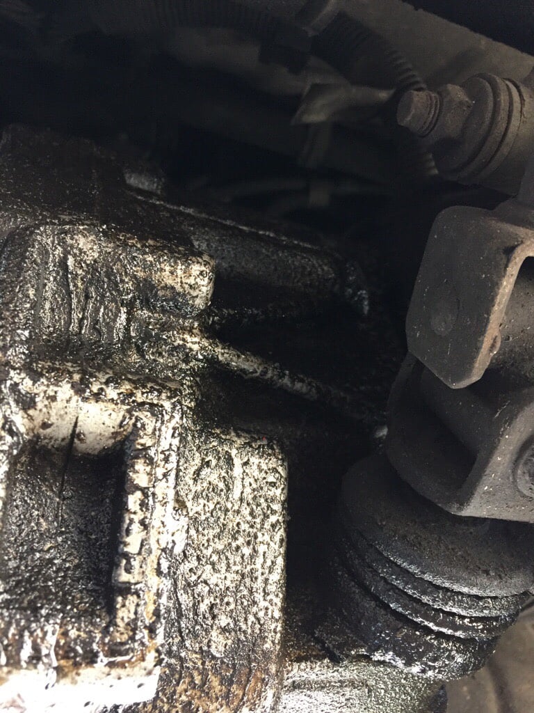

Update. I think this oil is coming out from the top of Gearbox speedo. (It wasn't tight properly) Still it's not working so it won't let me to change these gears again. I think this clutch cable could be stretched. I called my mum to change these gears around so I looked at this beer cap hook on the top of gearbox. Only gear one is move but others are not move. Shall I get new clutch cable then?
as well as stretched clutch cables, bent clutch pedal / clutch arm brackets, out of spec new clutches, worn loose selector linkages, another thing that could cause difficulty selecting gear whilst running are worn gearbox synchro clutches (unable to match gear speeds), worn synchro teeth (unable to slot into or engage the teeth) or worn gear selector forks (unable to move far enough to fully engage the gear).

I don't like how it's leaking that much gearbox oil, it ain't good and if the oil level gets too low, all the bearings/synchros/cogs start to get hot and irreversibly wear faster and whine etc.
has this gearbox been worked on or disturbed before by a garage? overfilled oil?
first thing imo is make sure there's enough gear oil inside. that looks like a 1L gearbox whereas I have a 1.3 but the way I check is remove the speedo pinion geear unit out the gearbox, and stick the engine dipstick in the hole till it hits the bottom and read the oil level same way as the engine oil.

try moving the beear cap adjuster to it's highest tightest shortest position on the clutch cable thread and see if it can disengage the clutch.
if it almost disengages the clutch, u could get afew mm more by moving this locknut all the way up, remove this rubber/metal cusion bit, put a washer between the locknut and the clutch cable bracket (to prevent the nut simply going through the big hole in the bracket), then u can tighten the beercap even higher.

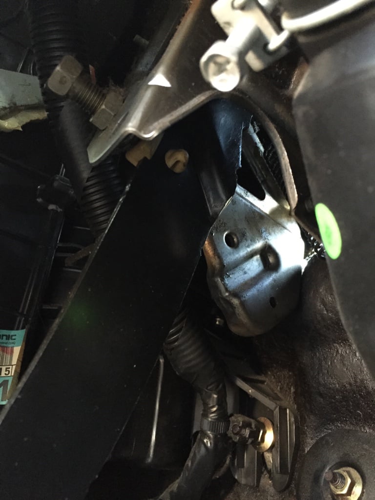

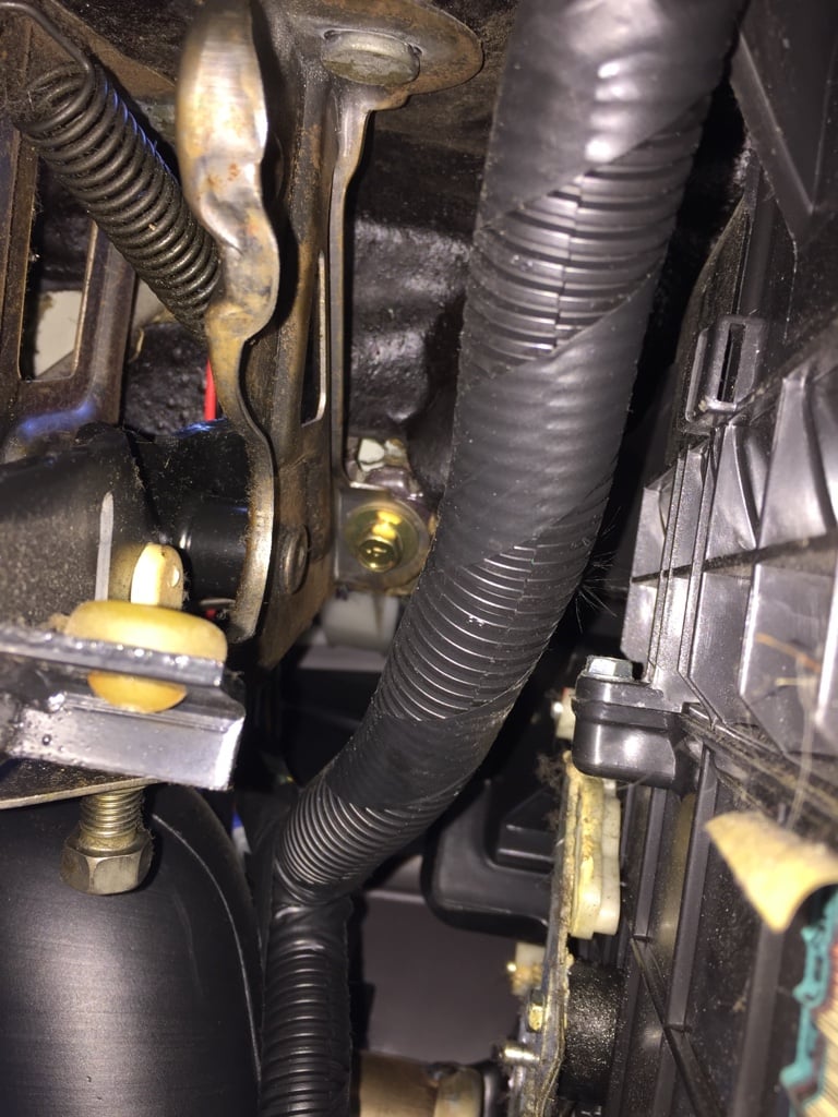

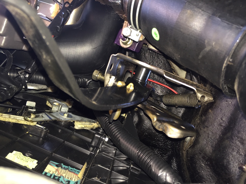

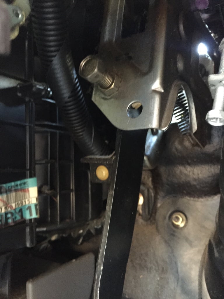

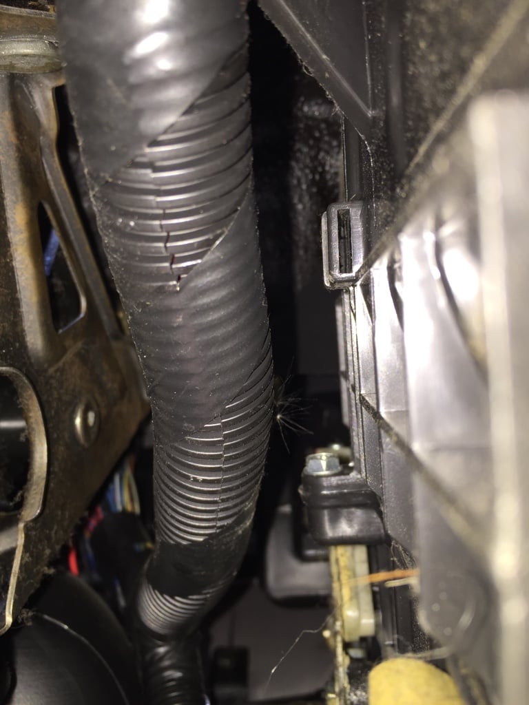

check the clutch pedal box ain't deformed (could u photo the clutch pedal bracket mountings?)

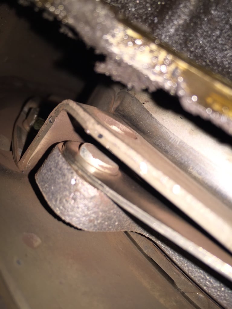

check the clutch pedal box ain't deformed (could u photo the clutch pedal bracket mountings?) I will take pictures now

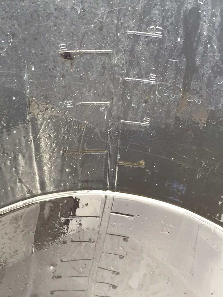

It looks like to put too much gear oil from previous last owner's mechanic. It got new split pins so it looks like previous mechanic must do something with this driveshafts and gearbox.
Anyway will strip this gearbox out now

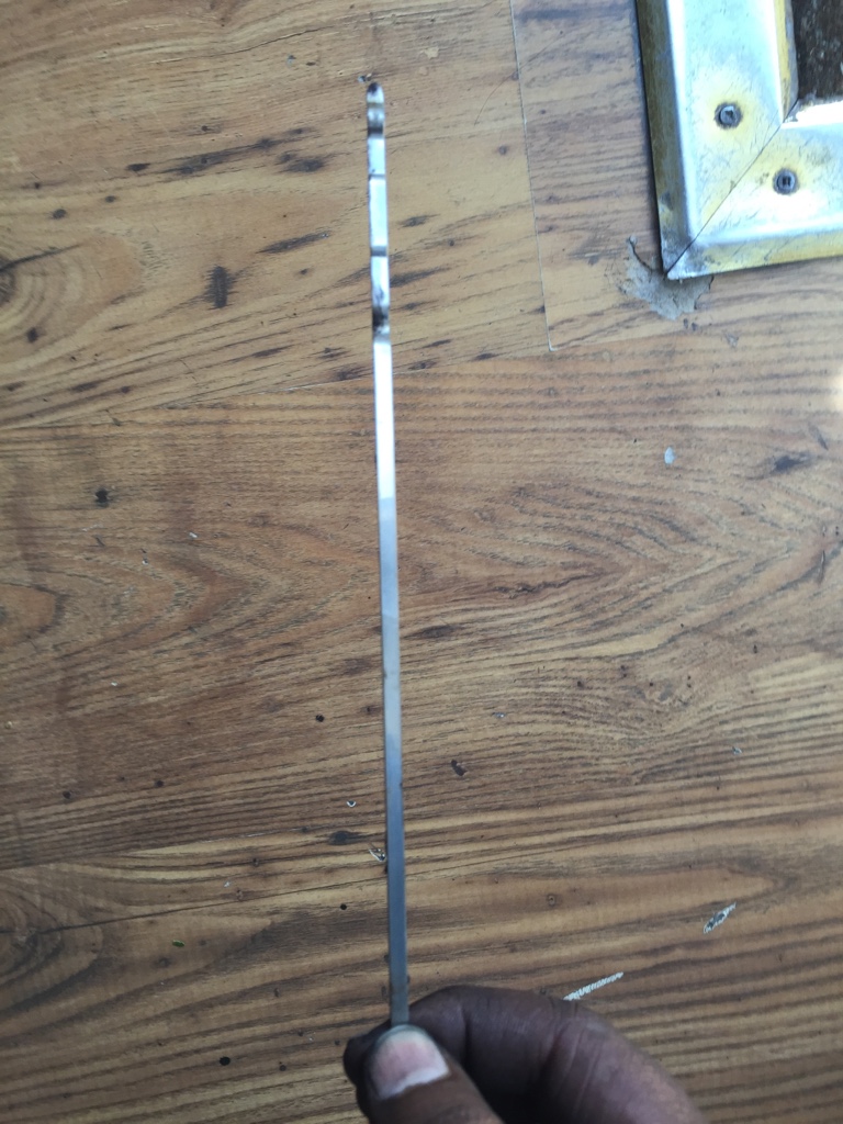

Already remove this starter motor so I managed to put oil dip stick in through there. From the bottom to my finger
So no oil ffs. Will need to take this gear oil out to see if there is more fluid or not
It's exactly two litres of gear oil so shall I put it back the top up up to 3l. My mate is on the way to drop 3l of comma 80/90 gl-4 gear oil.

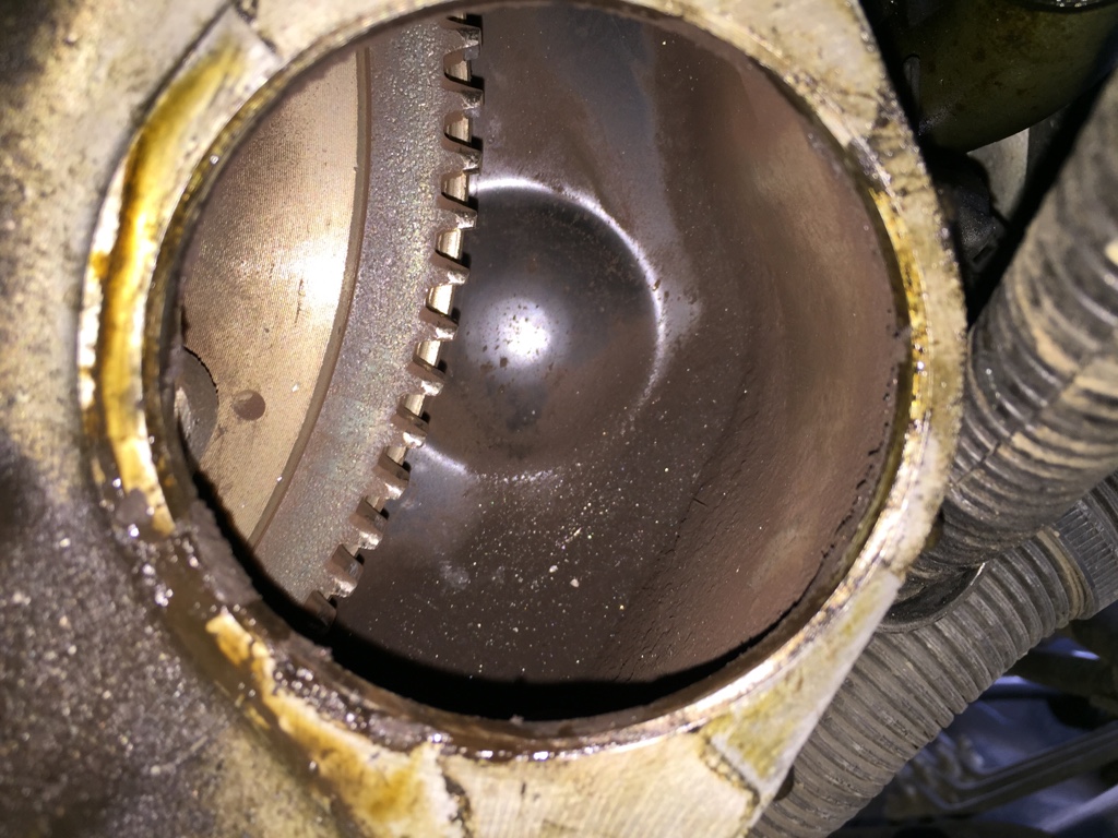

clutch plate looks pretty new n thick, can still see the groove edge.

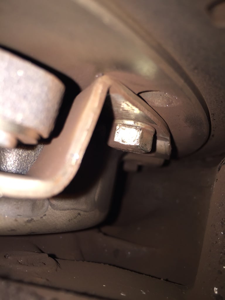

I was looking at the pedal bracket and spotted this low bit where it attaches to the bulkhead
I dunno if it's the thickness of the soundproofing that's blocking the view,
on a normal manual gearbox chassis (like on my first blue K11) there's this 10mm spacer bracket that's formed on the chassis to space the clutch bracket 10mm away from the bulkhead surface.
now on my current grey K11 it was originally auto, then converted to manual and the ppl forgot bout this spacer and it made the bite point feel really low etc cos this spacing really affects the clutch cable mechanism geometry.
I fitted some diy spacers
to space it out and fixed the issue

try remove ur clutch bracket n check if there's some form of spacer there?
Ok I will have a look on this clutch pedal now so what do I need to do gear oil? To put it back in through speedo cable. I will be back in a min so I can see clutch pedal very well

check pedal bracket spacer, if intact the cable could be stretch..replace n test again
