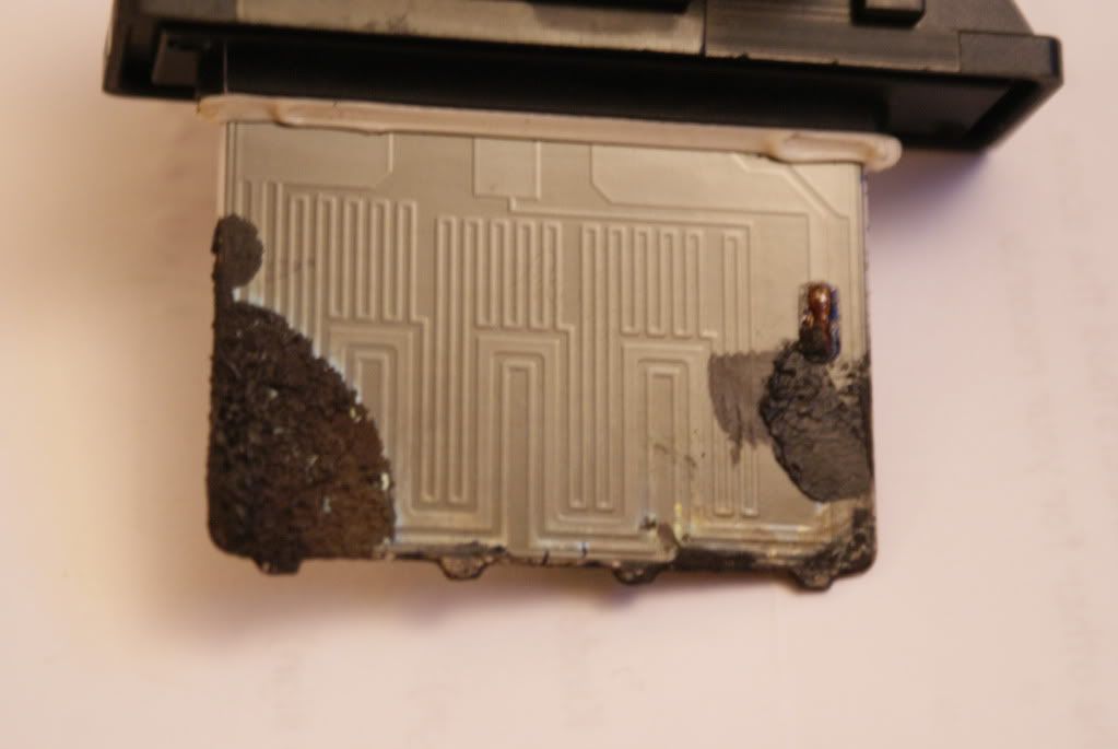

All week i have had a funny smell in the car, bit like a burning smell. Anyway tonight my heater stoppped working again so i took out the card to have a look...and got a shock. The card has been melting at the edges nearly setting on fire, the holder is a bit melted as well.
no i checked the voltage, its ok. the old card i pulled out only failed as the resistor had gone with no other damage. I am presuming the card was faulty and over heated. Im taking it back tomorrow and i expect a replacement otherwise im kicking off. My wife has to drive the car with the kids and i dont want anything to happen to them.
have a look at the pics and tell me what you think:
that ones smaller than anyone ive seen, youd be better going to the scrappies and pocketing it for all its worth. just make sure it works before you take it lol

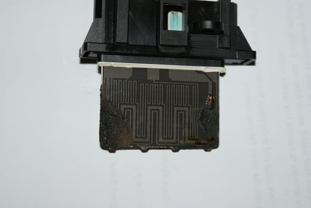

ok got the new one last night, so the heater worked fine.
This afternoon its gone again. I cant see any damage on the card at all, even the resistor. Heater only working on 4 again.
Now im stuck. They will not swap for another, dealership says they will have to take my car in to see what the problem is. to be honest i only work part time thanks to a redundancy and i cant afford to pay dealership prices.

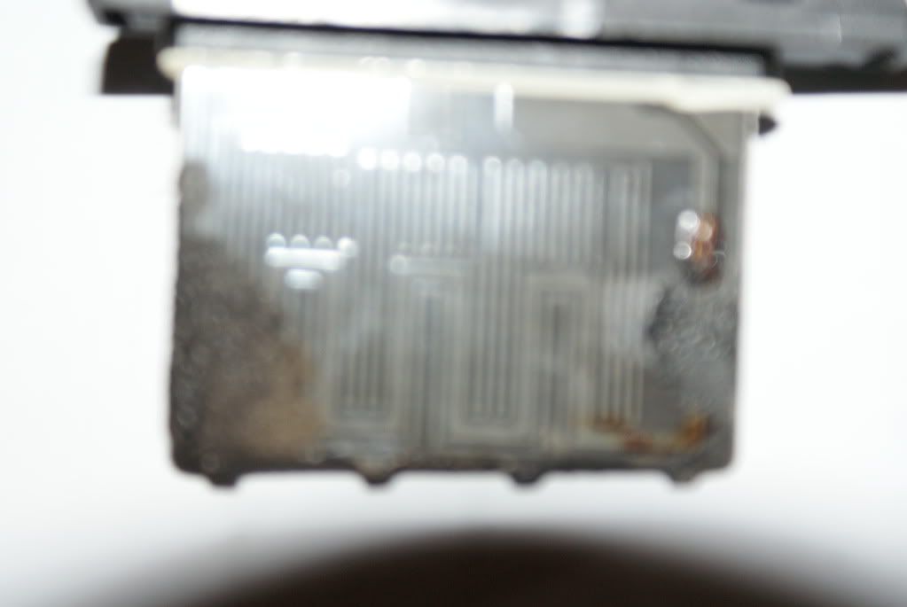

well this last card has not burned like the last one but it looks like the small resistor has gone. is it possible to resolder a new one on or even just put a lump of solder on the card?
The 'resistor' is just a lump of solder. If the blower draws too much current, it will heat up and melt breaking the circuit. If you just resolder, it will probably just melt or burn the card out again.

go get your money back because that is a joke, i get mine from the scrappy i have so many that i bin them now and again. there is no way that was worth £45
they are putting in a card from an almera or a french micra, the card is not long enough to get decent cooling from the fan.

i didnt know it had to be cooled by the fan, i thought it was a bit short.

Normally the tracks next to the solder blob corrode. Scratch either side to reveal clean copper.
Add solder to the clean copper until the 2 sides join.

well ive took my time :p but i fixed the card resoldering it back.
so far it has been fine but i have fixed it back next to the proper enclosed place but on the outside. It does not seem to be overheating but im keeping my eye on it.
