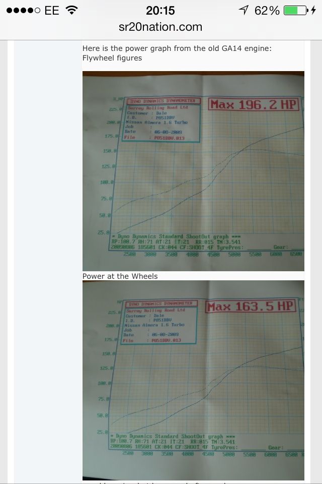

Very laggy indeed. I'll grab one of the other det GA graphs that shows them in better light :)
Hp is nothing without torque though :)
mine had 80lb/ft @2100 rpm tho andy (pre-nistune/stock ecu) and baguete,s (nistuned) @ 1500 rpm
But whereas these drop off torque pretty much as it peaks.
A GA will climb in torque and hold its peak torque throughout
Edit: the second graph shows that 80lb/ft isn't reached until 3250rpm?

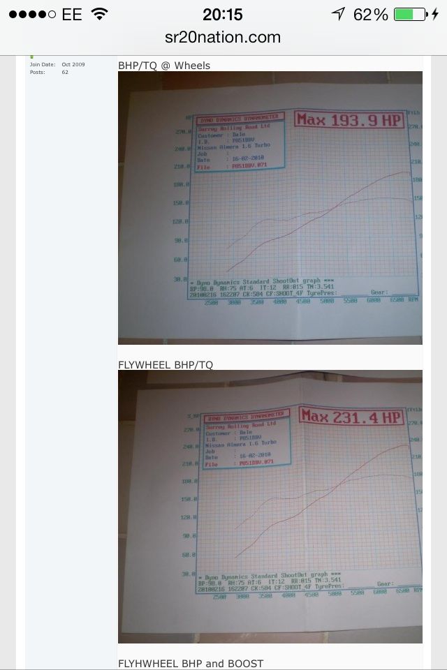

Ive just had a read at dales blog and he says that graph is from the ga14 engine and not long after he broke a piston. Then he built a low comp ga16 for it and run a little more boost and made 193whp
The extra 200cc in my eyes would see him the added 30hp at the wheels
I've got em all saved in my reference folder :)
Impressive to know that a GA16 can handle almost as much power on stock internals as an SR (de)
