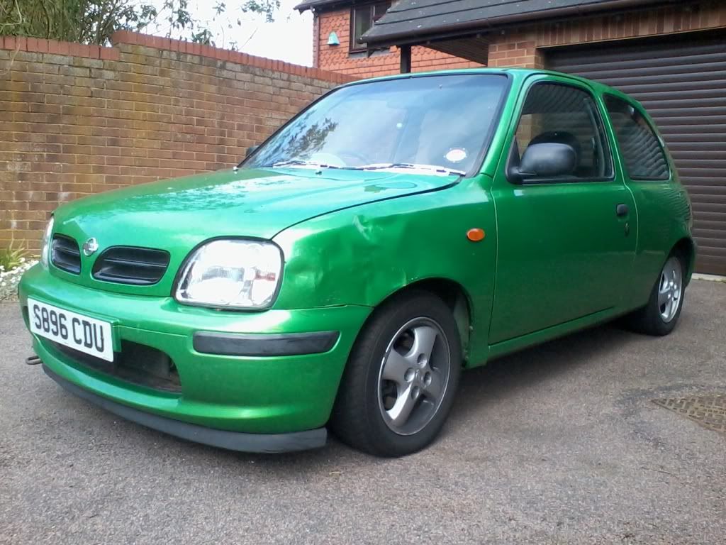

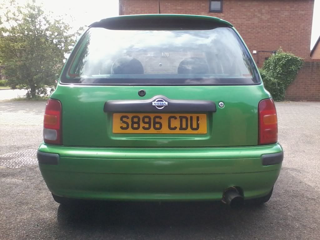

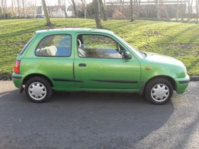

So, to get started, here is the only pic I could find of the car before I started modifying it, about 3/4 months ago. You'll soon see that a lot has changed :grinning:.
Unfortunately, I only have a side-view picture, as I didn't take any other pictures of it at the time (maybe too embarassed? :down:). However, I can assure that the car was COMPLETELY standard when I bought it for about £650 18 months ago, and was absolutely mint, apart from a few rust bubbles on the wings (most of which are steadily getting worse until I can find new panels or the patience to fix them :glare:).

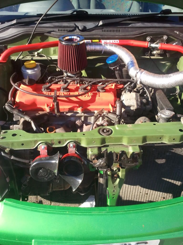

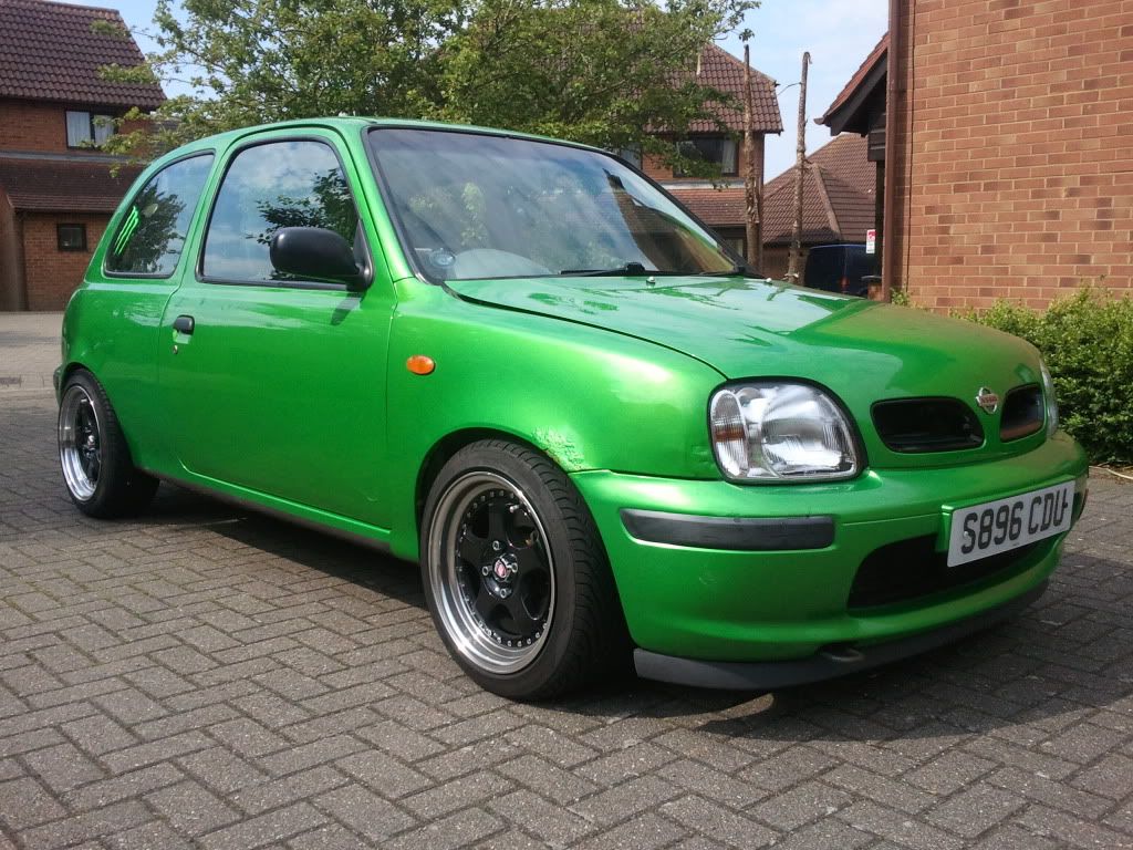

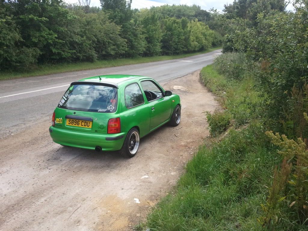

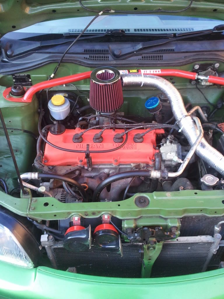

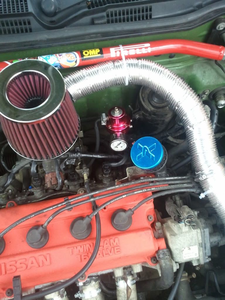

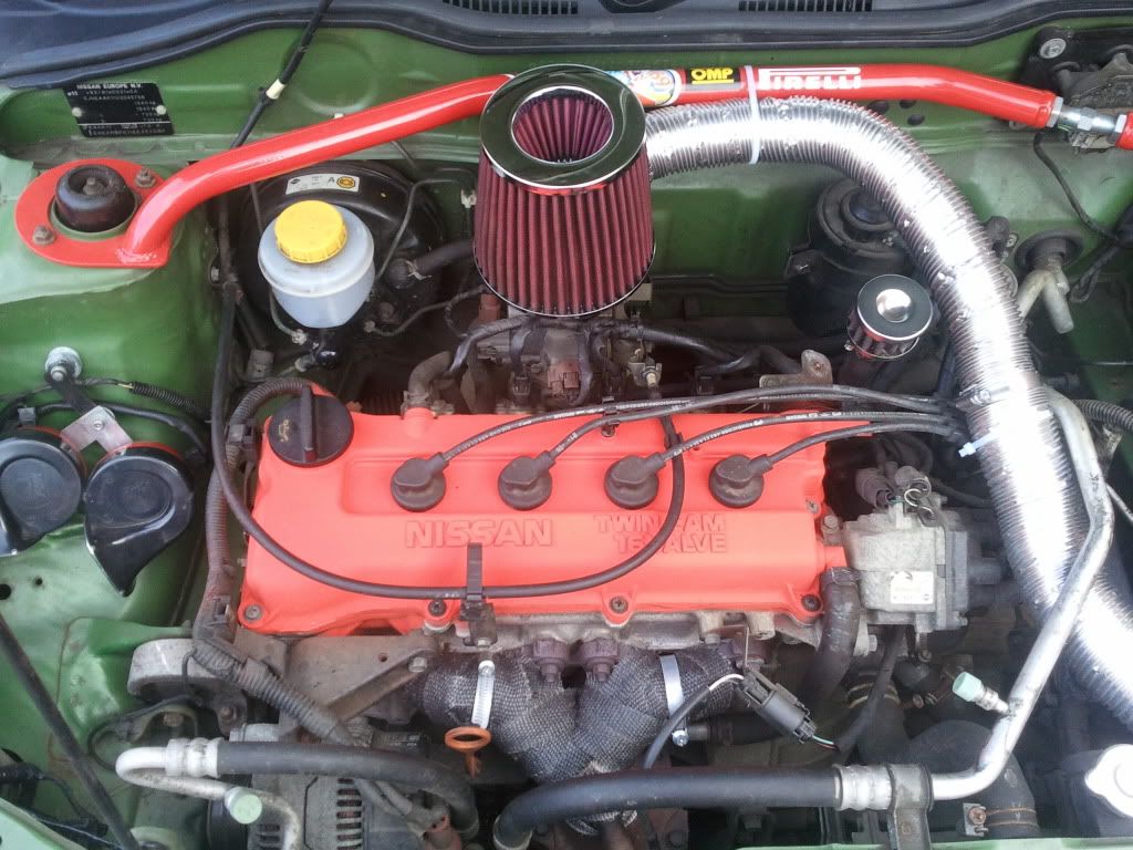

Ok, now for another photo update. This is just to show a few more mods I made - Momo steering wheel, OMP strut brace, fitted the cold air feed and new air filter, new alloys, pre-facelift tailgate handle, lowered her a bit more, and a few other little bits.

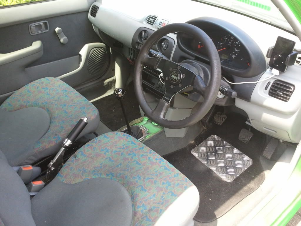

Interior modifications

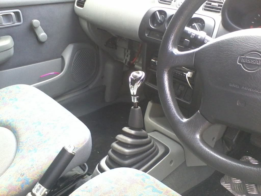

Momo steering wheel
Momo gear knob
Ripspeed handbrake lever
Ripspeed tax disc holder
Ripspeed mats
Ripspeed seatbelt pads
Ripspeed door sill protectors

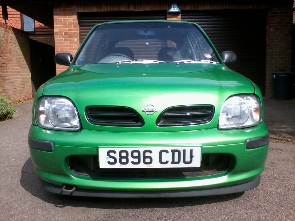

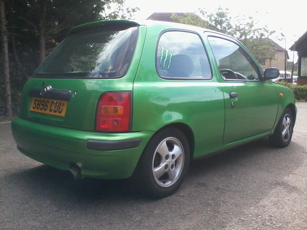

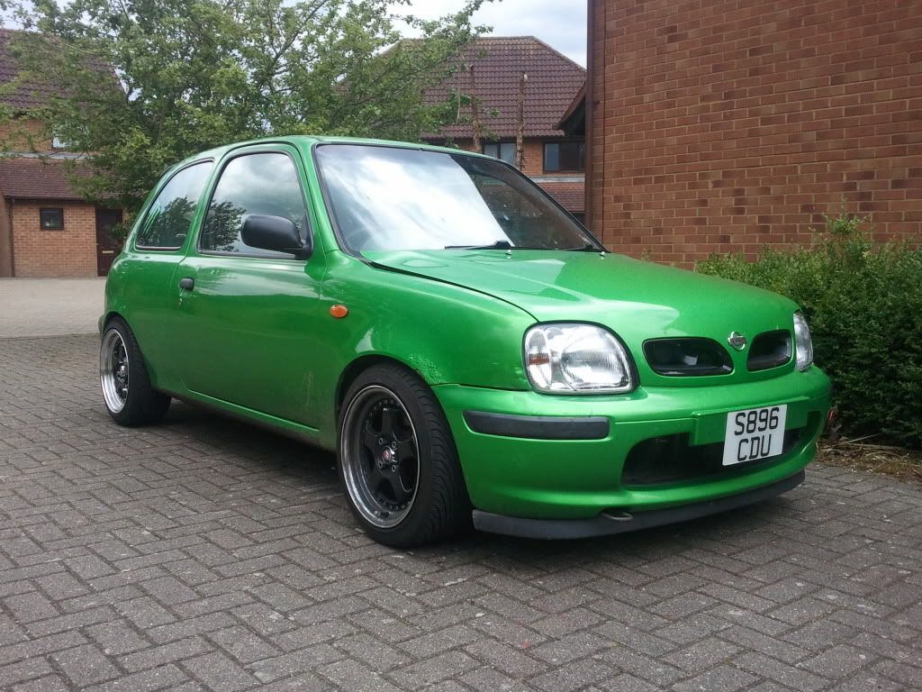

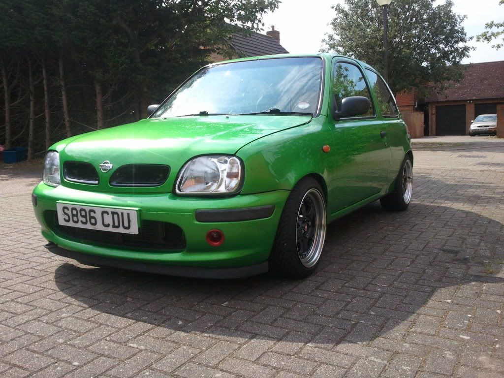

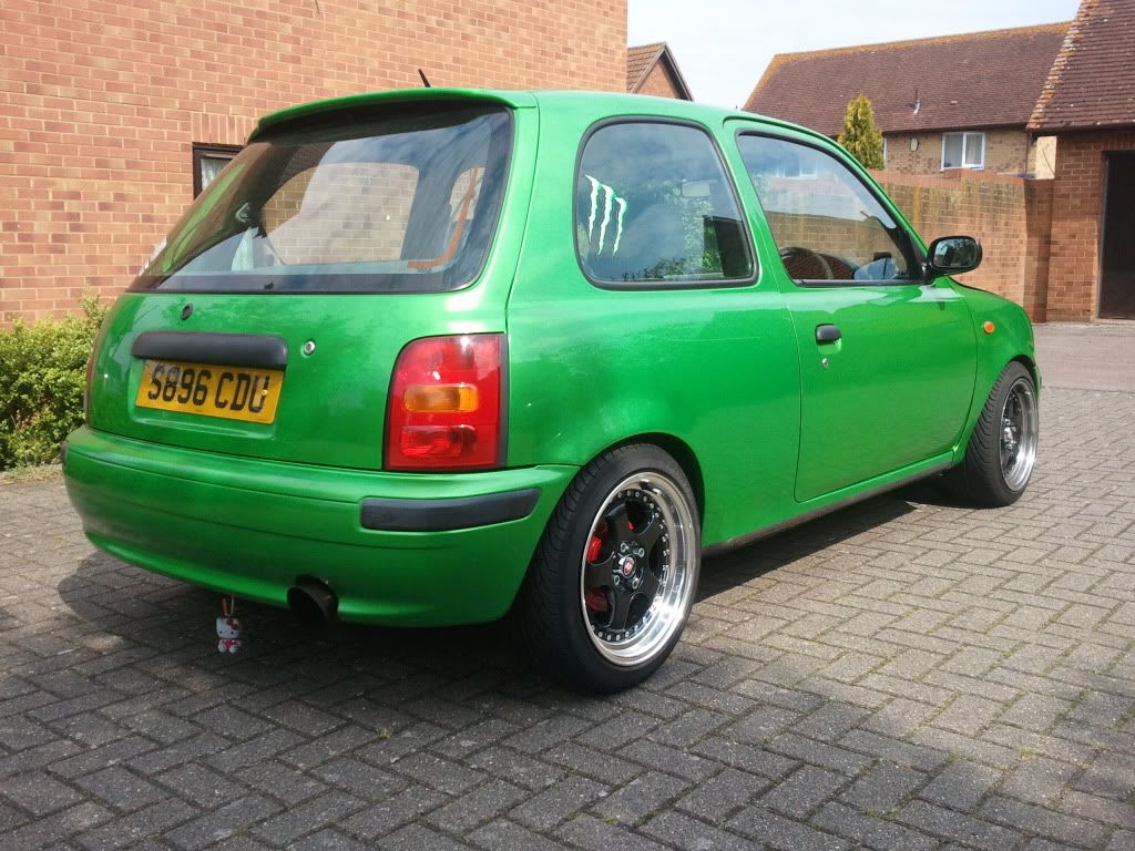

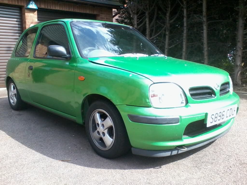

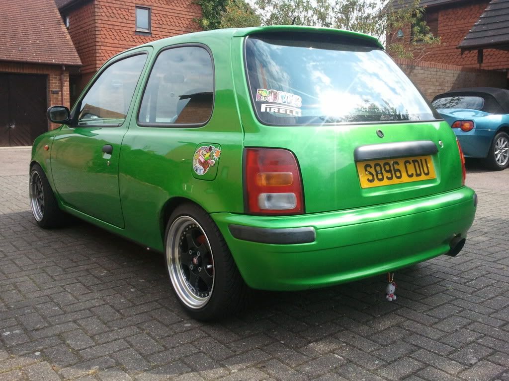

A bit of photo whoring today after gave her a good clean :wasntme:. A few stickers added, sprayed my rocker cover, Jap-style backbox, but that's about it I think. I did actually fit my Jap plates after I washed her, but my camera ran out of battery. Will take a few more pics on Thursday before I start to take everything apart (Y).
Awesome! My favourite colour by far. Nice stance on those wheels aswell :)
Cheers buddy, is a sweet colour - it's grown on me since I bought it :laugh:. I've not seen many others the same colour as mine, and it's the only one (apart from hooded's) that has these alloys on (Y). I want to go lower, but can't without flaring my arches and getting some serious negative camber - the alloys are 15x8, so the outer rim sticks out a ridiculous amount, even with not much stretch :(. I guess if I went lower though, it wouldn't be practical :blush:
Pre... The better one ;)
Oh, it's like that, is it? Got beef with my facelift turtle???? :laugh::laugh::laugh:

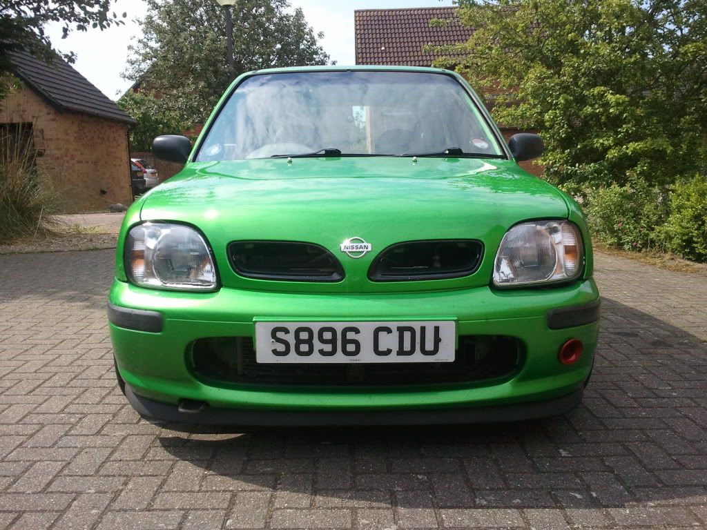

I can tell you now it's a lot easier to make your grill open mouthed than it was to do mine, just cut the whole thing out in the middle, leaving the outside intact, then smooth over with sandpaper and respray. Not sure how to do the mesh though, I haven't seen one done close up. Presumably it's just glued in with Araldite or silicone sealant, as I can't think of any other way to do it. The shape of my 2 upper grills meant it was really hard to make them open mouthed, and still retain some rigidity and keep the holes for the original bolts. They didn't come out too bad, but could do with smoothing over and respraying again. Was just to see if it could actually be done.
Really easy to cut out the lower grill though, but does take a lot of patience to get it smooth :glare:

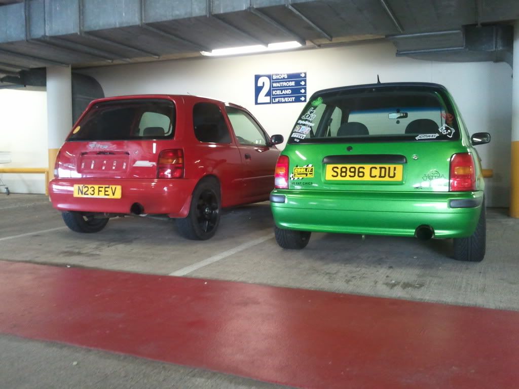

Parked up next to a fellow modified Micra, a pre-facelift SR. Anyone know who belongs to this K11? I don't think I've seen it on here, but seen it driving around Milton Keynes a lot.

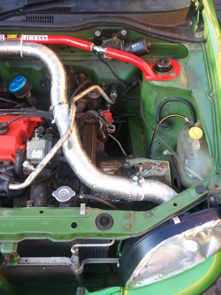

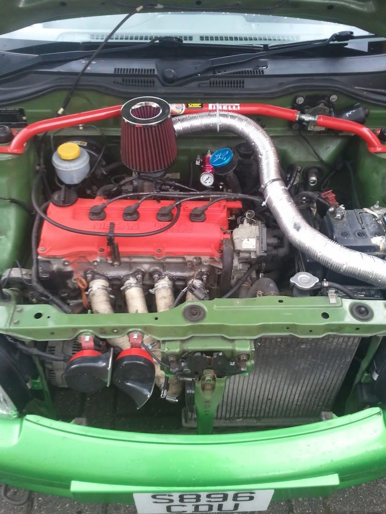

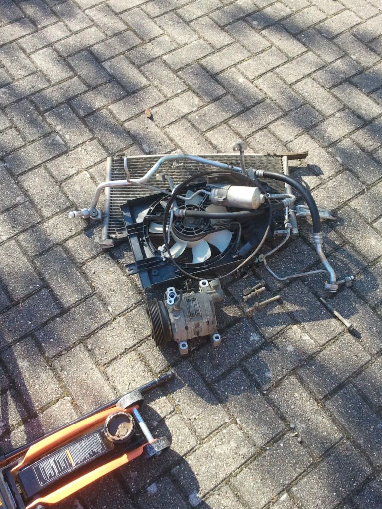

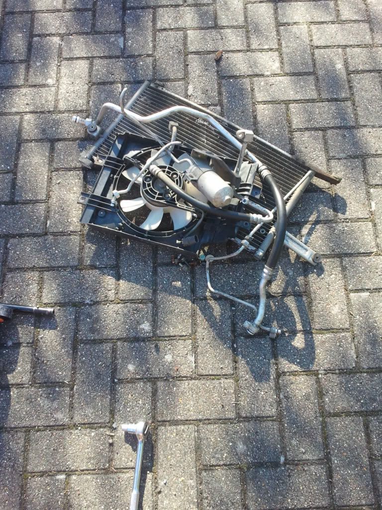

Made an early start on removing my aircon, thinking I'd have to do it over 2 days. However, 5 hours later, and everything is done!

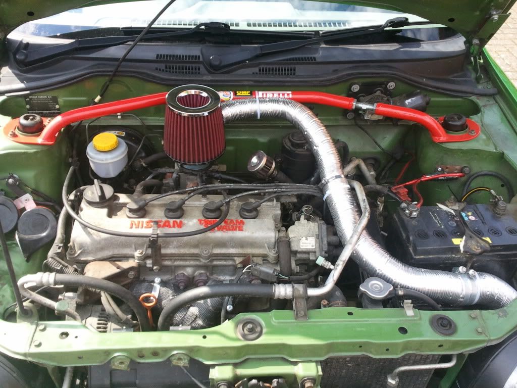

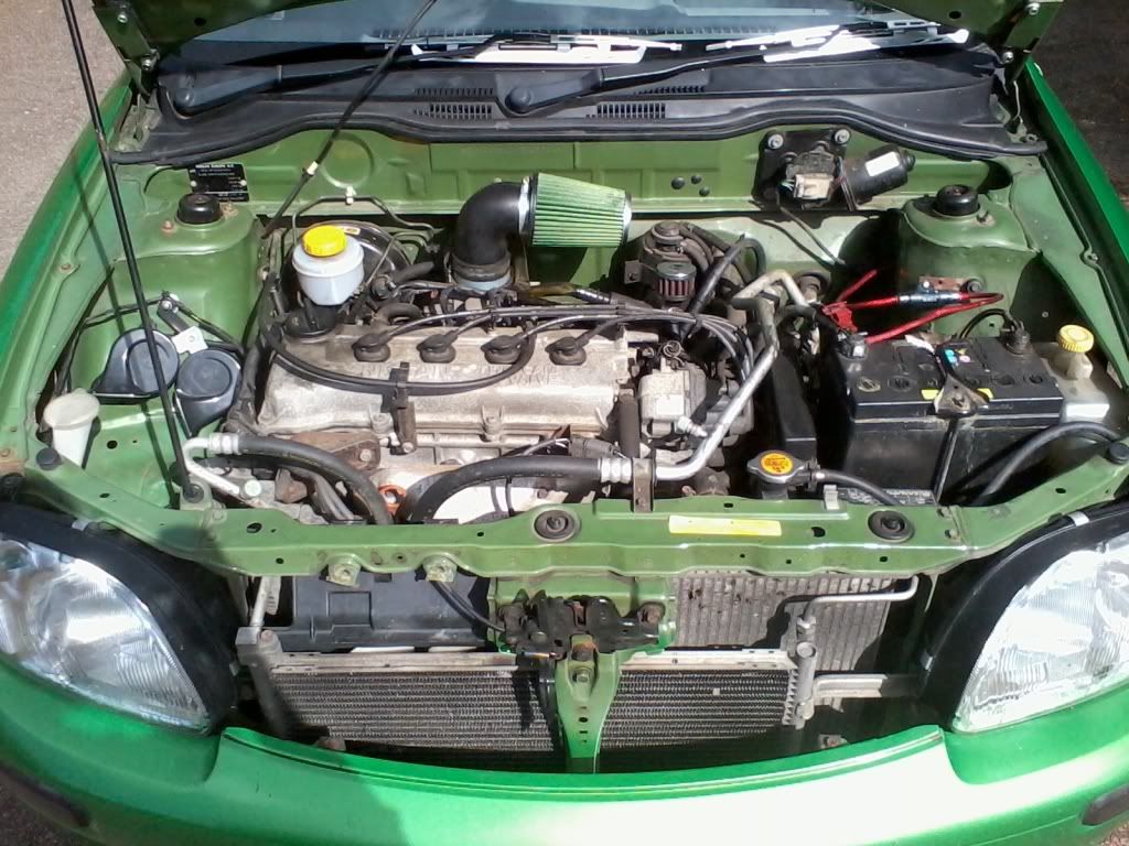

Here's the engine bay before I removed the aircon. Went to de-gas the system, but it turned out that there wasn't actually any gas in it anyway :laugh:. So it seems that my aircon was doing absolutely nothing anyway. Definitely better off without it (Y).
First things first, battery out. Don't want to get myself electrocuted or anything :grinning:.
Cue a lot of hard work, bleeding greasy hands, and an hour later, I've got a pile of aircon parts. Surprised at how much it all weighs, so I've definitely freed up a bit of weight there. And I haven't even got the aircon pump out yet :suspect:.
Ahh, space and a nice tidy engine bay (well, sort of. Could do with a clean :laugh:).
Aircon pump and remaining mounts now removed. Actually couldn't believe how much the pump weighed, especially since it nearly fell on my head while I was under the car grr. Again, freeing up some more space, and maybe a few extra horses :grinning:.

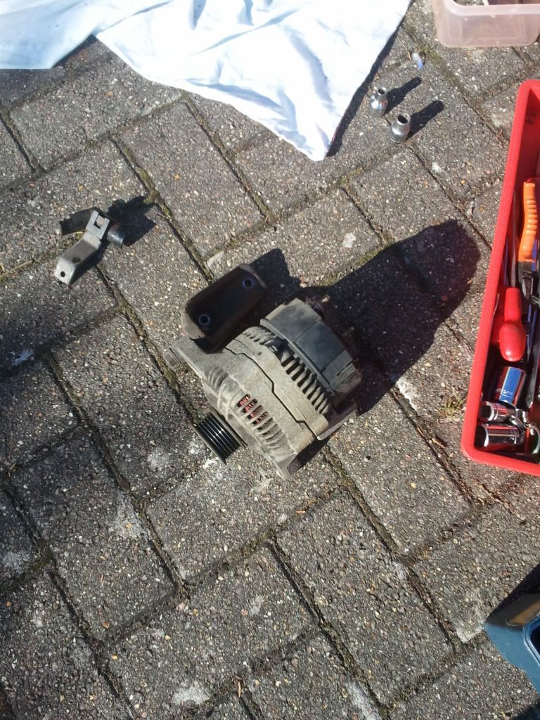

Alternator removed. Thought I would have to wait until tomorrow for Wills alternator mounts and belt, but they turned up at about 10, so at least I wasn't going to be without a car (Y).

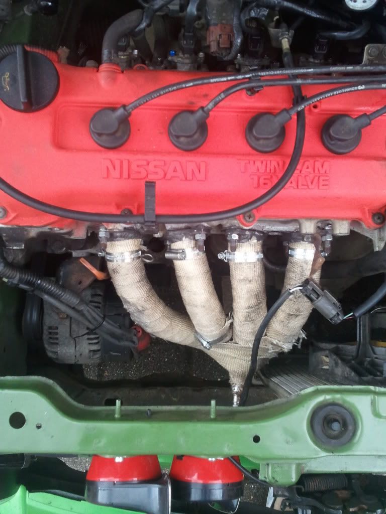

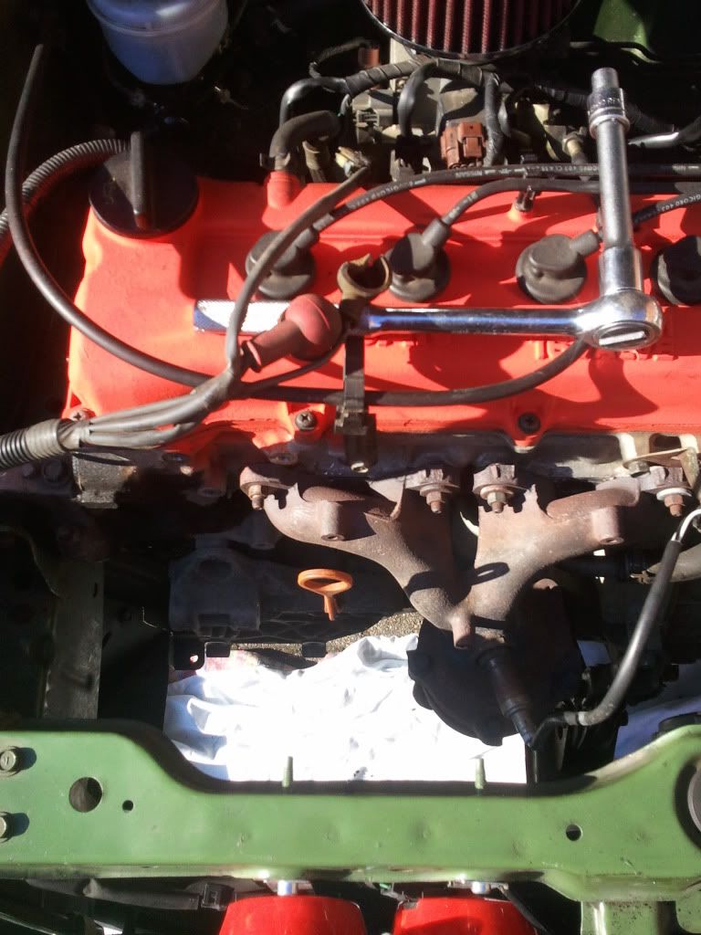

It's amazing how much space you get in the engine bay when you remove the alternator. I only had to twist the standard manifold to one side to get it out, where as before I had to pretty much take apart my whole engine bay, without actually dropping the engine out completely :laugh:.

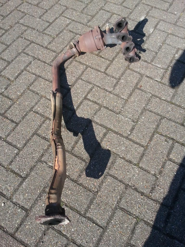

Out with the rusty/cracked/ridiculously heavy original manifold...
And in with the new (well, second hand) custom made 4-1 manifold (Y).
Started to get hungry about now, so managed to persuade my other half to drive me to Tesco to get some lunch. So behold my tasty, high energy lunch :laugh:.

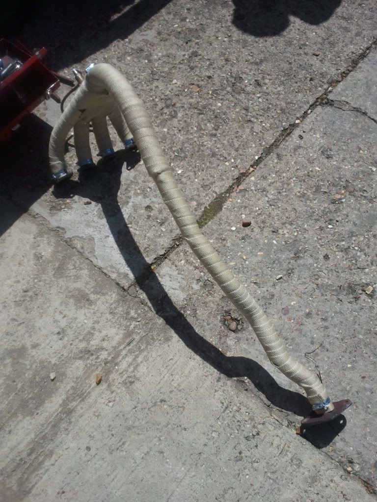

Right, back to the work now. Bolted the manifold back up, and reconnected it to the decat pipe. The backbox twisted a bit more than I thought it would when I reconnected everything, so when I got back from the scrapyard (where I was told there was a Micra with a full Japspeed system - there wasn't :glare:), my rear bumper was melting since the backbox outlet was pressed against it. Got gassed by the exhaust wrap as it heated up as well, didn't enjoy getting smoked out of my own car. Was blowing a little bit, but should be able to solve that by replacing the manifold gaskets (the ones on there looked pretty decent, so didn't see the need to replace them - probably should have done, since I did actually buy some :wasntme:), using some different bolts and washers, and sealing the whole thing with exhaust sealant.
Then, for the finishing touches, fitted my 1.3 fuel rail/injectors, and Walbro fuel pressure regulator. Looks like a very nice shiny addition to my bland engine bay (Y).
So there we are. Took her out for a drive, the fuel pressure regulator needs adjusting a bit, but it's considerably louder and a bit nippier. Now just need to get my hands on some CG13 cams :grinning:. Maybe someone can help me out with that? :wasntme:

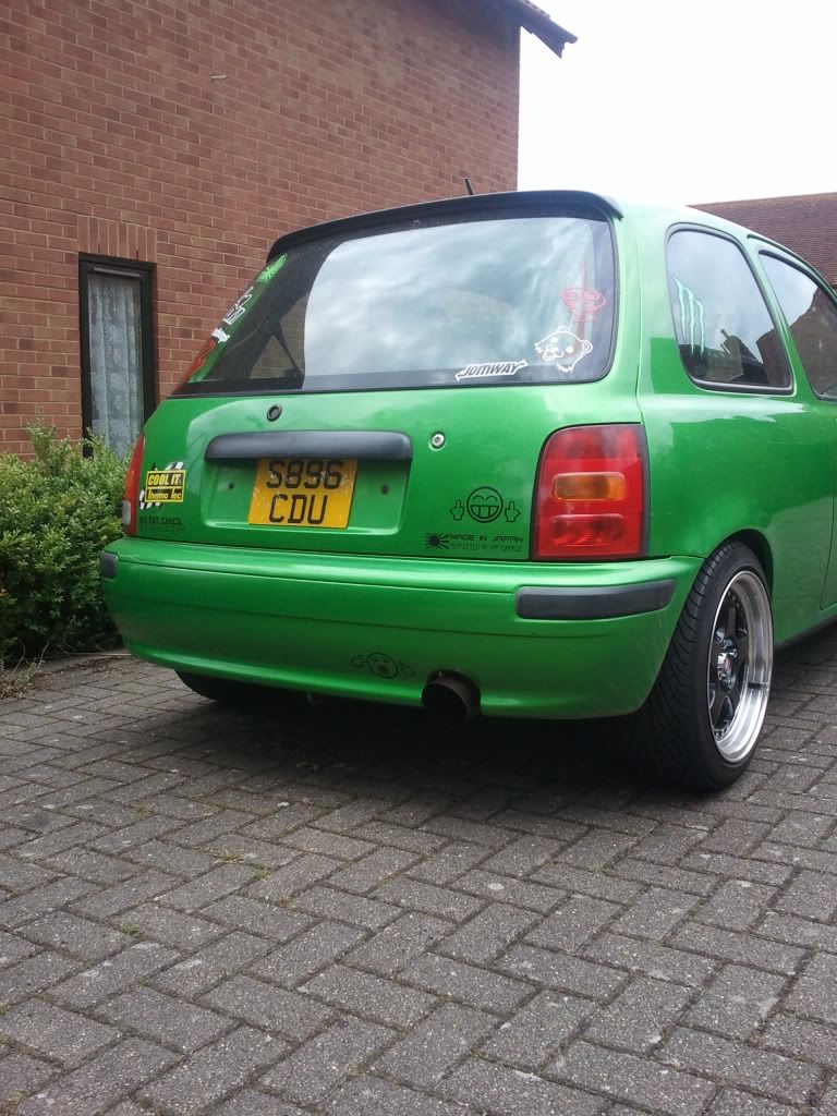

Thought I'd get a few pics to show my Jap plates as well. Not quite finished yet, I'm thinking about installing March rear numberplate illuminators next (and filling in the holes left by the tailgate handle bolts, smoothing it all over and respraying), and reshaping my front bumper around where the numberplate is mounted.

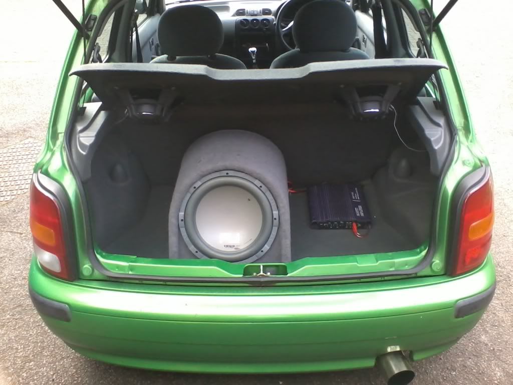

Made another new addition to the Micra while I was at a mates house - parcel shelf with Nissan 6x9s, and some A-pillar tweeters. Might look into some CG13 cams tomorrow ;)

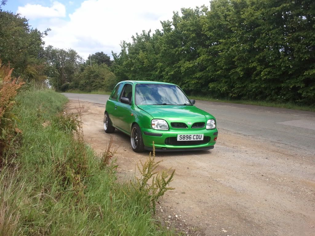

Fitted my colour-coded tailgate spoiler back on today - decided the black one didn't look as good with the bolts holding it on the outside :doh:. Back up for sale now for £10 + p+p if anyone is interested?
Also put the finishing touches to my 4-1 manifold - new gaskets, and all sealed with exhaust putty (Y). Doesn't sound like a tractor when I'm ragging it anymore:grinning:! Unfortunatley, I have now lost the incredibly loud pop/spit of flame when I redline it in neutral or rag it through 1st/2nd/3rd :down:. I guess this is a good thing though, because it means it's not running rich anymore, and is definitely a bit quicker :grinning:.
it was popping because of the leaks dan :grinning:
Yeah, I know :laugh:. I'm really disappointed that I lost the popping (was incredibly loud from outside the car, and the flames were about a foot long (Y)), but at least I know my exhaust system is now completely sealed, so I'm not losing power. I still get small pops/rumbles when I let off the throttle, it's not really over the top. Also means that my mates SR has a leak somewhere, because his has quite a raspy pop :suspect:
