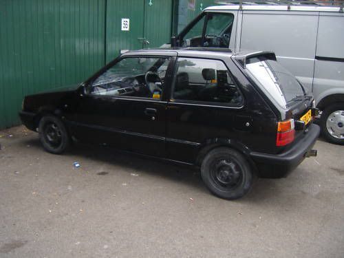

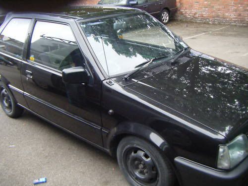

hi all its fairly early days only owned the car for 2 days but i will be trying to be a bit different and copy everything everyone else has already done:p
v8 swap is probably out of the question so that can wait for the s14 i have grr
so here we go ill make a start with my car pics:grinning:

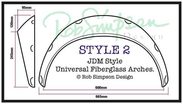

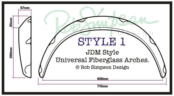

anyone got any advice on the arches? im thinking style 2 will be best fitment slightly less wide so wont be far off the origional shape of the arch but bigger overhang for fatter wheels
el cheapo wheels arrived today
15x6.5jj et 38 and with the extra 95mm arch width im gonna need some spacers to fill those arches
anyone want to give me a clue as i cant be bothered doing maths right now

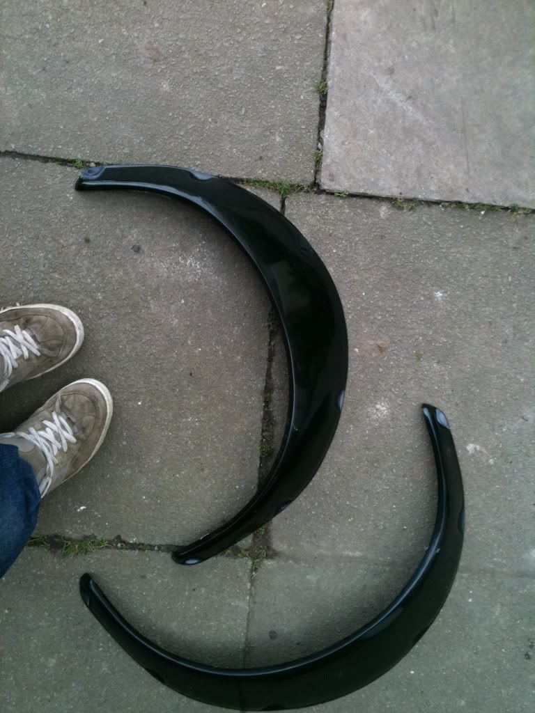

arches have arrived:grinning: had a nosey at what the banging was when i turn the steering wheel and to my horror find the nsf spring is snapped! then on closer inspection i discovered there was a tie wrap holding the bottom of the spring up:wow: unbelievable bodge! then i thought make sure the rest are ok and low and behold each and everyone of them has be tie wrapped to the strut im guessing someone has cut a coil off which has left the spring to wide to seat in the damper so to stop it popping off tie wrap it on

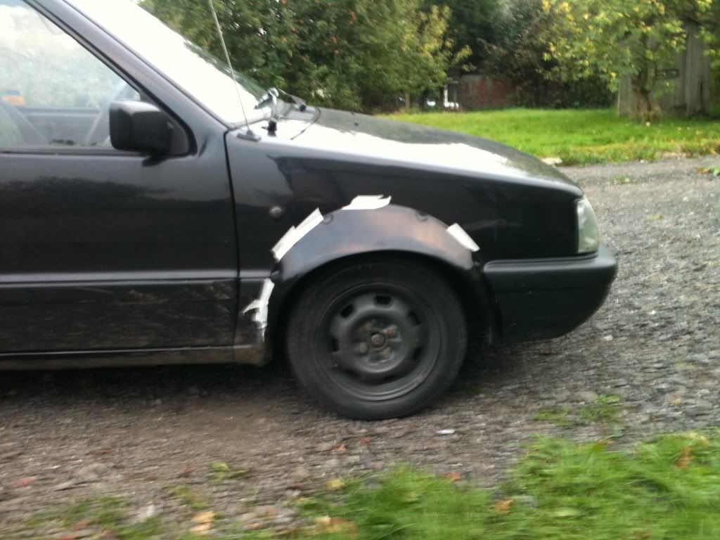

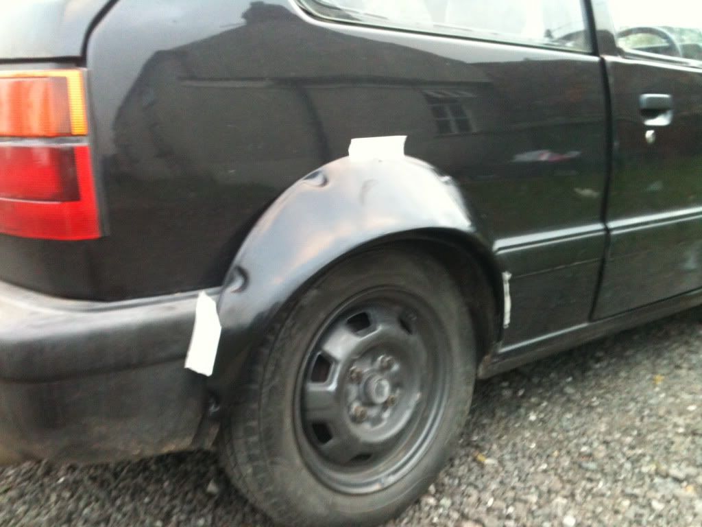

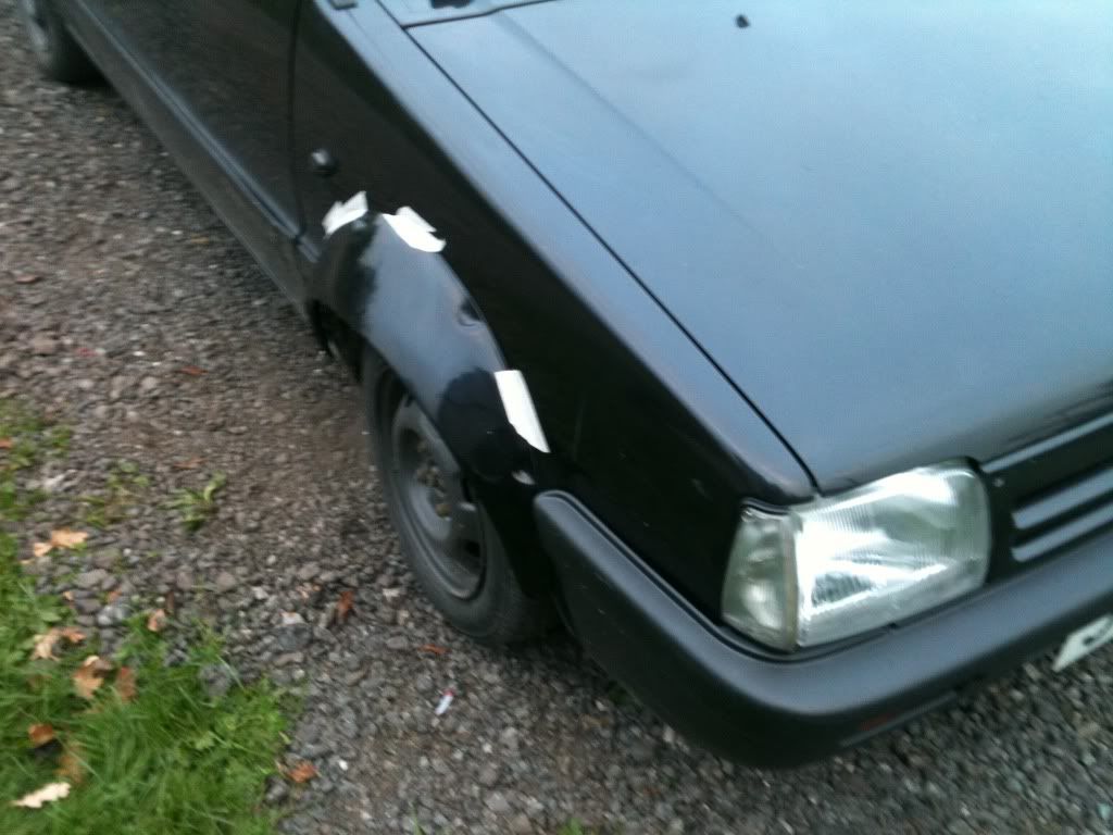

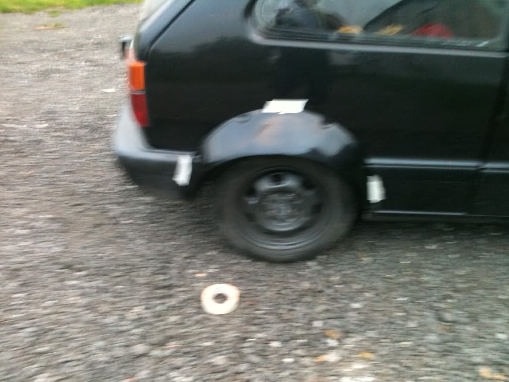

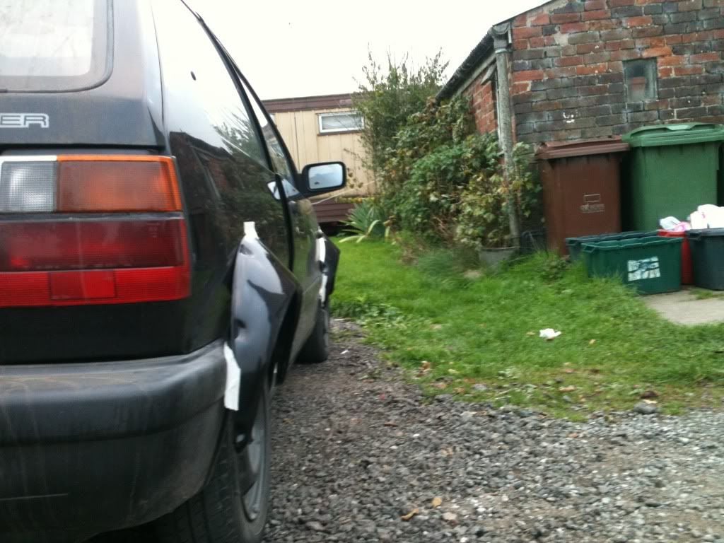

picture took from my iphone so not great

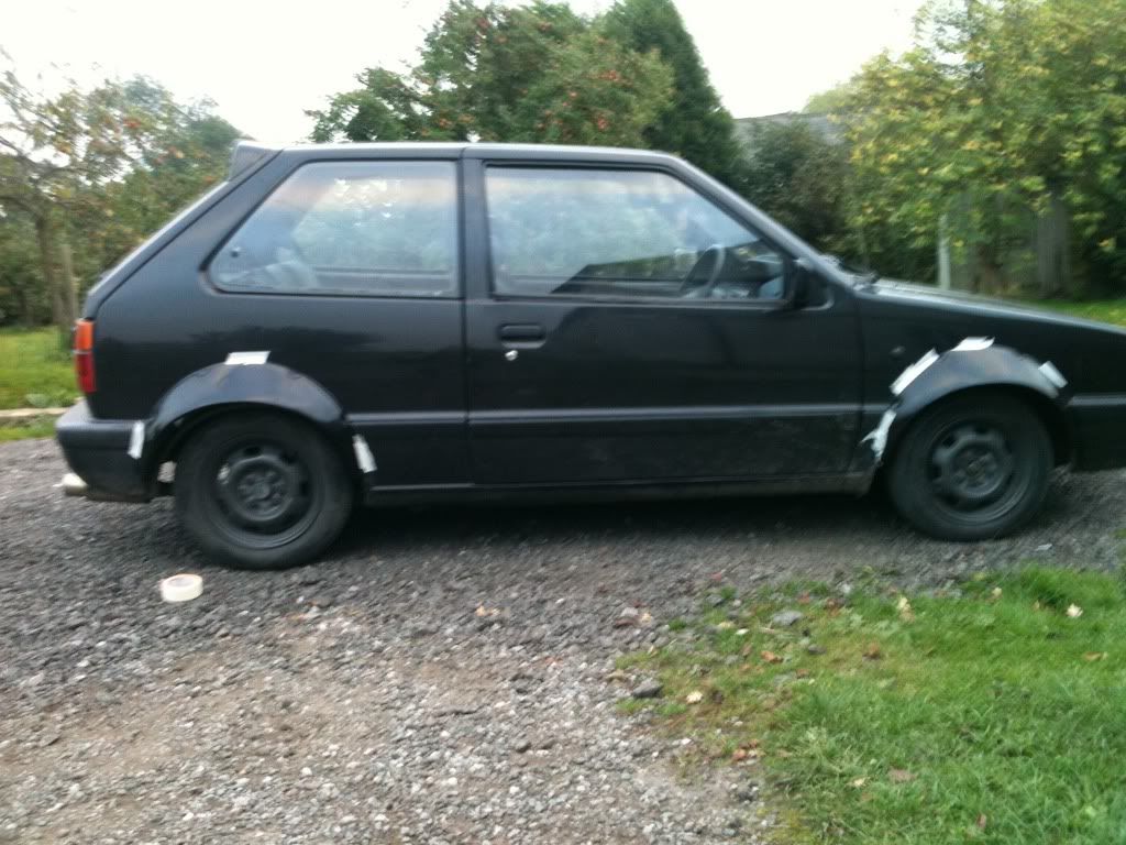

also i hadnt really put the back one on in the right position
all held on with masking tape as im not ready to fit them yet
Cheers mate
Once I get the skirts on Friday I can make a start on putting it on gonna look stupid till I get some tyres for my alloys oh well
I don't like them... the angle from the micra side to the outside doesn't fit the micra in my opinion.
Fair enough mate your opinion, I've only quickly bodged them on not measured them or flushed them flat with the car all the bumpers and side strips need removing first
To me it looks like the standard arches just with an extream roll and flare job

I'd need 32mm spacers to get the same et as you I'm guessing? So if ive got an extra 76.2mm or 3" due to the arches am I gonna need an et of -76?? Don't know how it works or what et to match the wheel to the standard arch?
rear windows tinted what a horrible job to do grr hate tinting, not done the rear screen yet that'll be fun:doh:
side skirts were painted didnt like the finish so im sanding down and starting again:(
because of the different widths, offset doesnt work like that. the face of my wheel is 6mm from the centre of the wheel. That means from the face (where it bolts to the hub) to the outer front lip is 88.9mm (3.5inch) minus the 6mm = 82.9mm
That means the outer lip of the wheel will sit 82.9mm away from the hub.
on your wheels, the face is 38mm away from the centre of the wheel. That means the outer lip is 82.5mm (3.25inch) - 38mm = 44.5mm. This means that the outer lip of the wheel will sit 44.5mm away from the hub.
