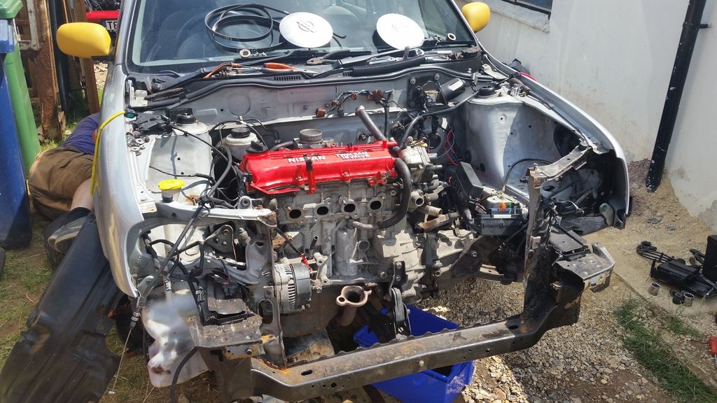

first job was to strip the car down to get space to work on the engine so off came the bonnet lights bumper wheels and both hubs
we need removed any parts that was atatced to the engine that was ein the way of us removing it
simon looking confused by a nissan engine
nearly out just checking everytihng is clear of the car

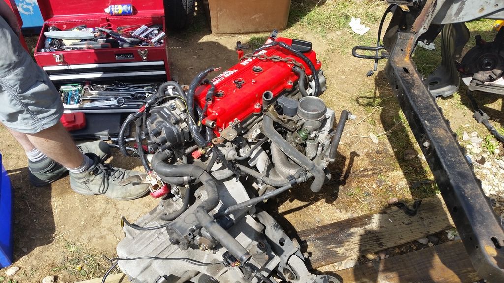

and shes out at this point we split into teams one clean and tidied up the engine bay and one started to swap parts on the engines
i will add it this oint aswell @Mark :) and @stuartwood89 went off and did some work on marks car so slowed us down a little
one empty and cleanish engine bay
parts going on slowly
