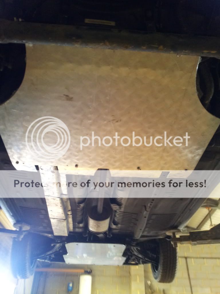

Ive got 3 years in the f1000 and still competing, and would say their is no need to protect the fuel lines, ive had no problems at all and even been on gravel sections and was ok, also your tank guard :eek: its massive and must weight a ton !!!! just cut another tank In half and put it under your tank!! cheap and lightweight !
Tank guards are pretty important on the really rough stuff :p oh well, i do it for fun not to wjn
I do it for both. I hit the floor that hard off a jump a rock went through my tank guard and damn near peirced the tank...
I would rather add 5kg and finish the rally. Than be 5kg lighter and not finish at all
To finish first, first you must finish and all that ;)
Fibreglass tank guard is the happy medium. Lightweight, easy to repair if damaged and easy to fit. Okay, might cost a bit more, but would never do a Road Rally or any rally considered "rough" at all without one, like H701micra said :)
