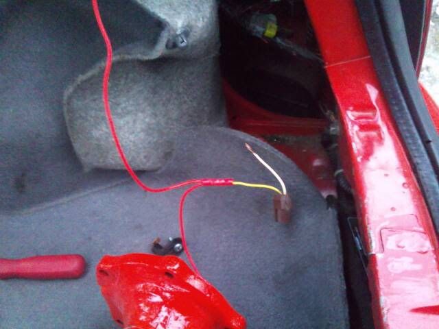

If your micra doesn't come as standard with a bootlight, what I found best was to run a wire directly from the positive terminal on the battery, that way the light can be turned on even without the key in the ignition. Connect that wire to an inline fuse for saftey, then connect it to the positive side of the light. Then run another wire from the negative side of the light to the switch (it must be 'push to break') and connect the otherside of the switch, or the switch body depending on the style, to the bare metal of the body or a ground point. You've also got to make sure the switch does actually get pressed down with the tailgate:wasntme:

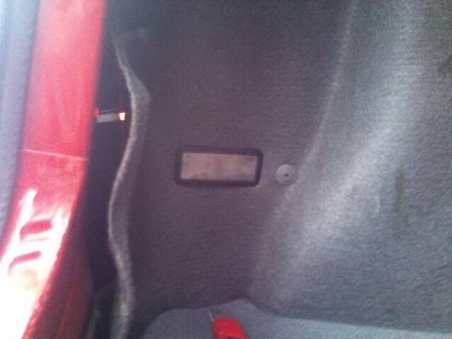

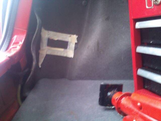

Mine is all electric and still doesn't ave that boot light. It looks like it's been an option to choose from when buying a new K11. Kalata found in a scrappy one for free for me and we got it fitted the other day. The light is on only when your headlights are on though. My father is going to get me a little switch to fit on negative wire and will have it on when I need (positive would be relocated too)
So pepo was your wiring loom already there, so you just plug and play or did you have to run all new wiring and everythingy ourself? fwn
Ogi, there's no wiring at all. I've run the cables myself, not a big job, though :laugh:... If you need to a help, give us a shout :)

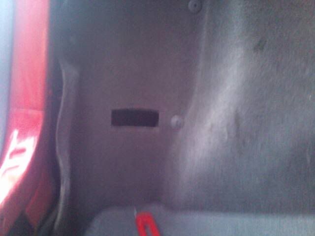

Erm, possibly a silly request, but does anyone have a picture of a standard boot light? Something I'm thinking if fitting to my Micra if it came as standard, also did they come as standard on the pre-facelift K11 SRs?
KTHXBAI
Wondering if I can make that any brighter actually as it only lights up about half the boot at the minute. Would be good over the winter. Hmm

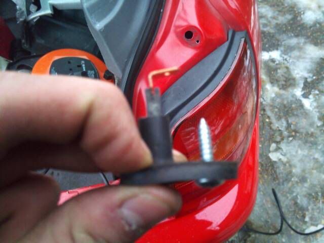

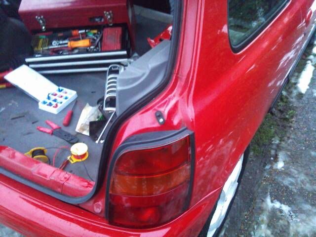

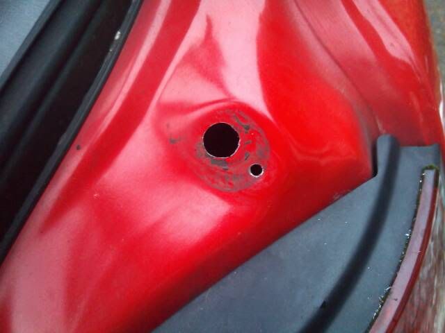

hey guys im doing this whole jobby of installing a boot light soon and want to hook it up to the fuse box so do i run the cables to the fuse box and then down under the carpet on drivers side of the car into the boot near where the rear speakers are i dont think mine has the stuff for the boot light and ive took the stuff apart and i deffinatly dont have a switch in my boot thingy which sucks lol gonna do it the old school way of either a switch so i cna just turn it on and off when i need it or a push to break switch from maplin :p
if theres anyone after this conversion ive just pulled all the interior from mine and have the light, precut trim panel etc kicking around that will just end up in the bin soon, will need your non switch latch to replace mine though and your more than welcome to chop out the wiring to the lamp if needed. collect only im afraid, based on the south coast.
best way i found was to get a door sesor push for off switch from a pug and a boot light from a pug!
then simply ran a wire from the live feed for interior light run to light and then wire to switch which can be positioned anywhere! i put mine on the right hand side of the boot where the rubber comes down from the boot lid
