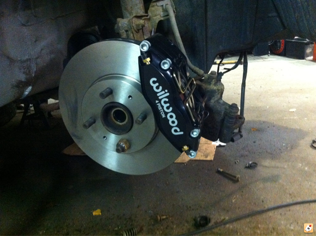

and the cg13de(T) build will soon take some action... but first i will build the rollcage an do something about the front brakes..
