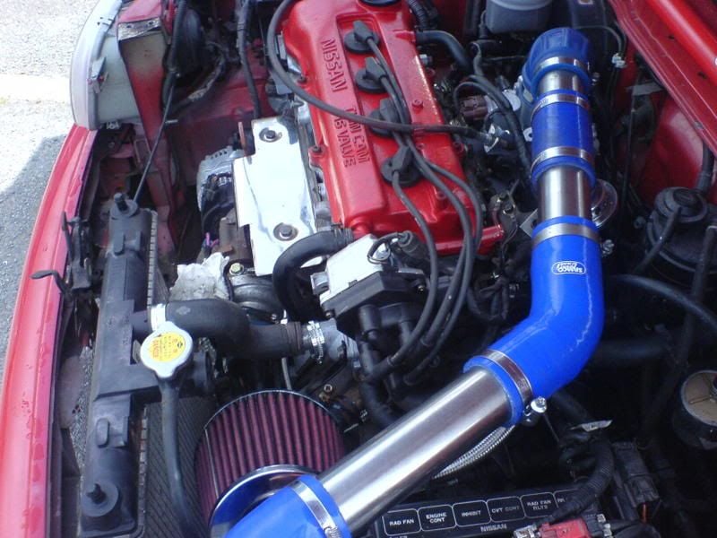

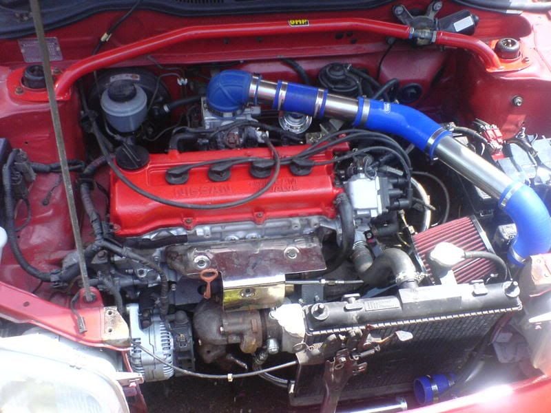

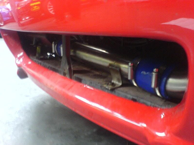

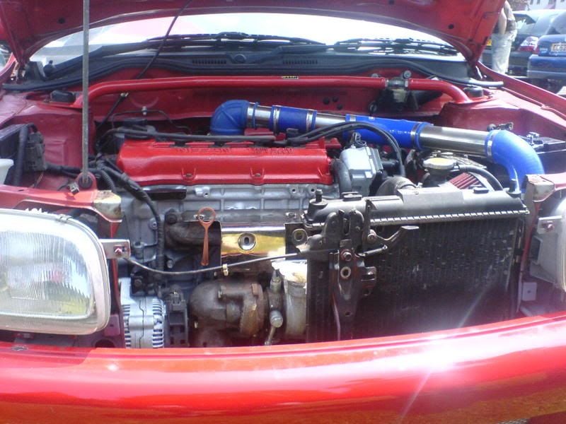

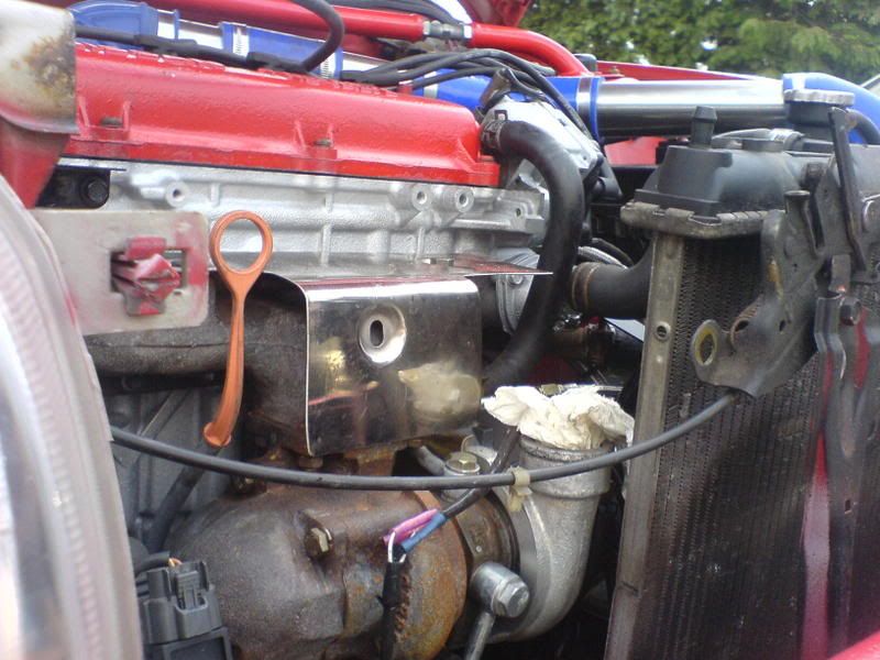

well i been away for 2 weeks and just got the net at the new house and i culdnt wait to post the progress up. The engine is now fully done as he just rang me to say they finished mapping it and he said along the lines of at 3,000 rpm he was seeing 60bhp already but not quiet sure what he said,lol.

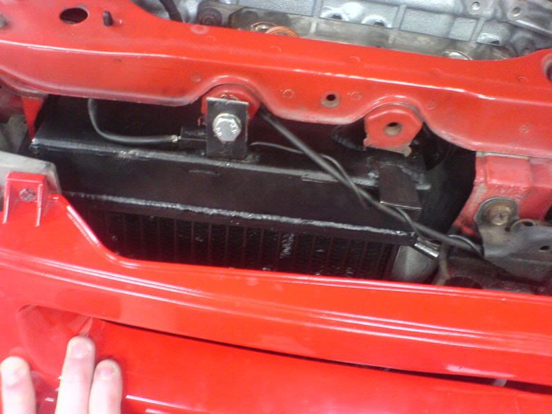

The intercooler still never turned up so he had 1 fabricated to sit the opposite side of the radiator, all pipe work is complete and he made a custom air intake because the filter sits behind the radiator and wont get much air.
The issuse we had with the CAT was that soon as they fitted the down pipe the car did not have a cat for mot,so they used the original 1 and copied the de-cat pipe flanges and positioned it back in the system and the emissions are spot on.

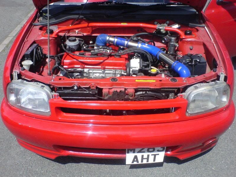

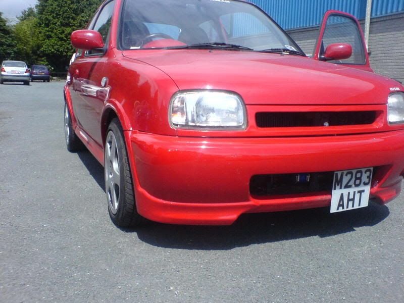

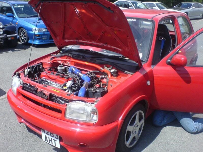

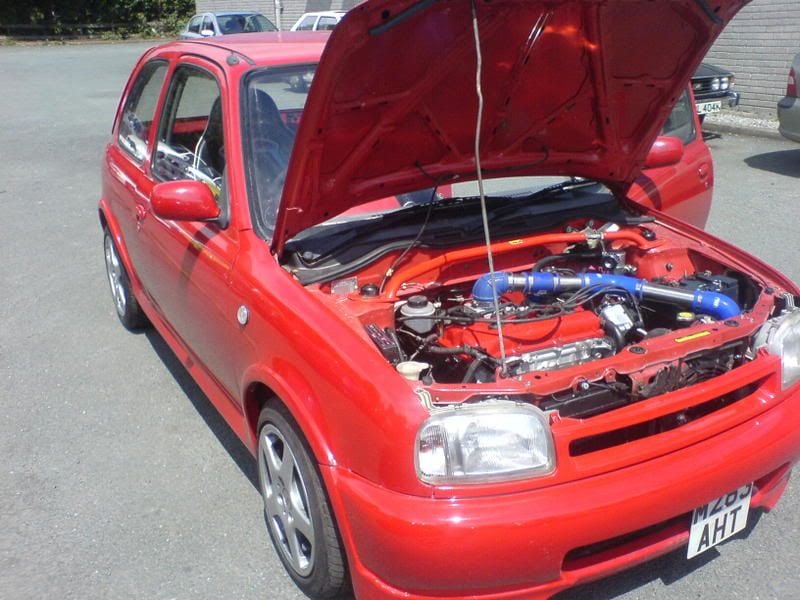

Just few pics i took the day i picked her up (last thursday).
Need to get door cards on- coilovers fitted- decat pipe on- wire up new gauges.

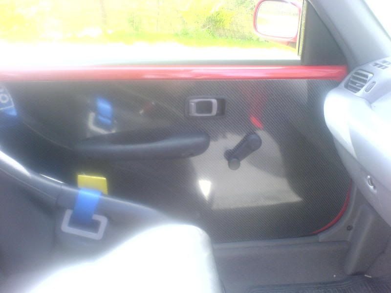

oooh where'd you get them door cards? they are exactly what i need for the rally car :D

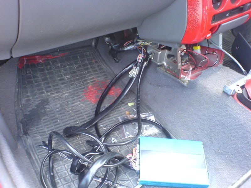

just wondering...would u be up for maybe helping me wire in some gauges sometime? not sure when im getting them tho...thats if i get them........however didnt ur mate help you fit ur ones?

yes lee for a n/a engine i would recommend getting something like voltage-water-oil-AFR
and yeah i will help as im elarnign to do myne on my won now :)

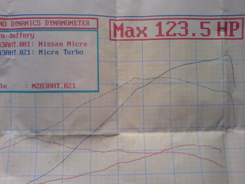

Nice, could you scan the RR printout, interested to see the torque you're making, also, where is your horn, I assume that it has been moved somewhere to acccomodate the IC?
Again mate, well done with the results.
And following you home, the noise is lush! lol.

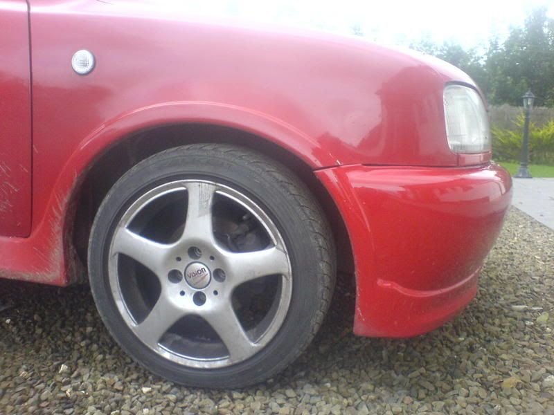

Update:

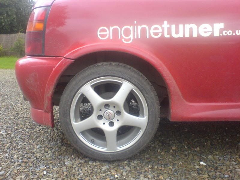

Got the coilovers finally fitted after siting in the garage for 4 months,lol. Set to 55mm all round and its plenty if u ask me.
BEFORE:
AFTER:
