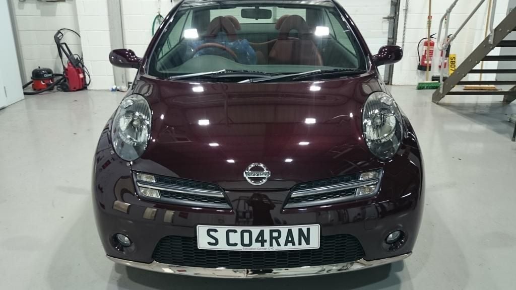

Latest news, 7 miles on clock and failed mot! Nothing drastic, but for some strange reason it had LHD headlamps in so they dip the wrong way. Beam deflectors stuck on and now passed.

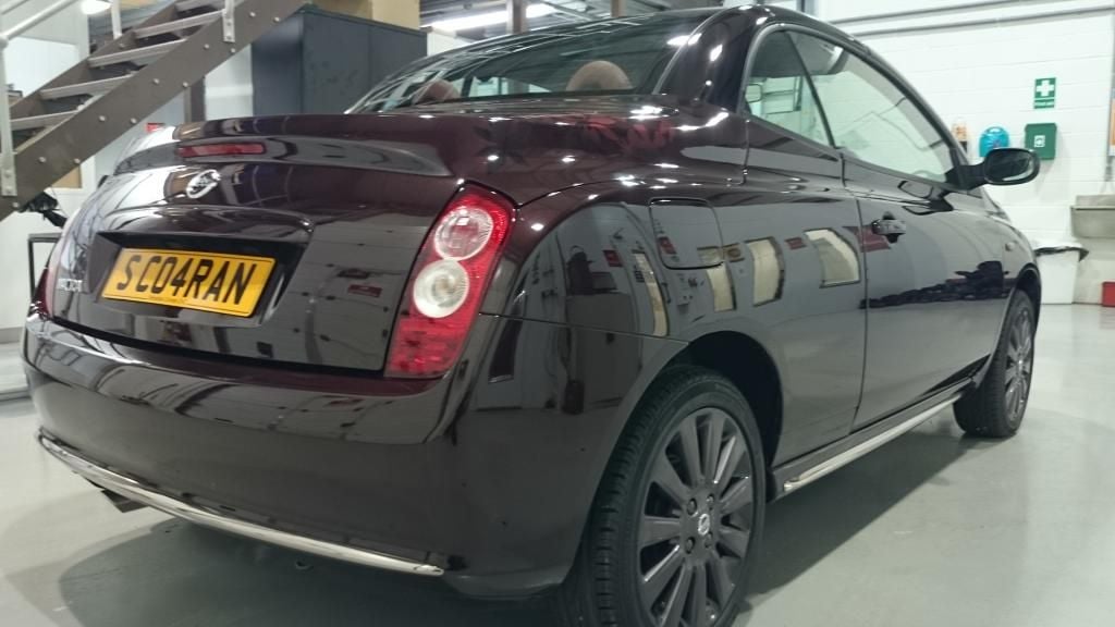

Next job is registration I now have my number plate so hopefully not long now.

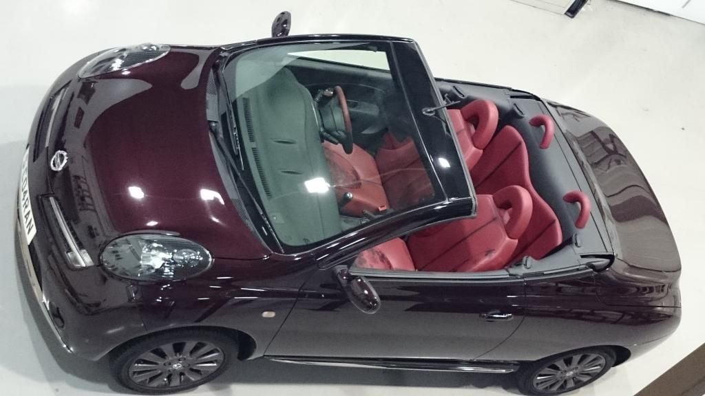

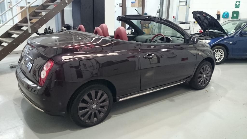

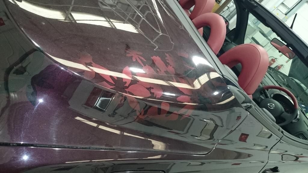

When it came off the line on 27th Feb 2006 it went to designer Sebastian Conran where it had it's makeover, full paint in blushing black with airbrushed flowers on the bootlid. Seats re-trimmed in red leather with matching flowers and flowers inside the dash clocks. leather trimmed dash and door casings. Painted alloys, chrome trim on bumpers and sills, tinted inside headlights and side repeaters. Ipod drawer with Ipod still inside, glovebox trimmed inside with red alcantara. Red leather steering wheel, chrome kick plates and alloy pedals and gear knob.
It was done to go on display at the 2006 London motorshow and then went on to the Conran Shop in Chelsea where it stayed till October 2006. After that it stood in a design studio for the next 7 years, then came to my work in Nov 2013 where it stood for a year untouched till I bought it.
