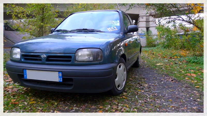

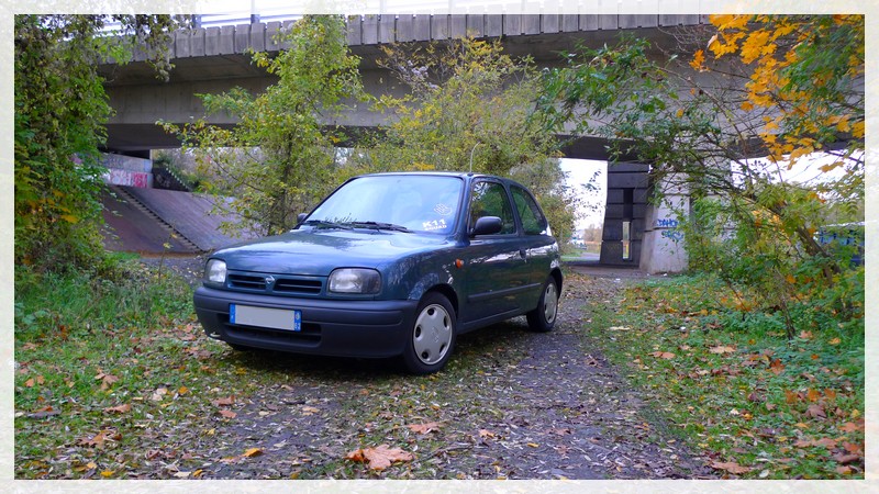

[Micra 1.3 LX][62] (French guy :p )
I wonder if there is not too much curve in the air pipe (red) I think a more straight would be better(pink):
Very nice the car has come a long way since i last looked at it! (Y) very good job with the wheels :D
Seb: wouldnt the radiator be in the way?
Beautiful
-By the way, I didn't had the time to take your spoiler Mailys, but I don't forget you don't worry. Where did you buy your K11 SQUAD sticker?
lol mark u can hear the exhaust i do a video :p
Thanks alexzaki ;)

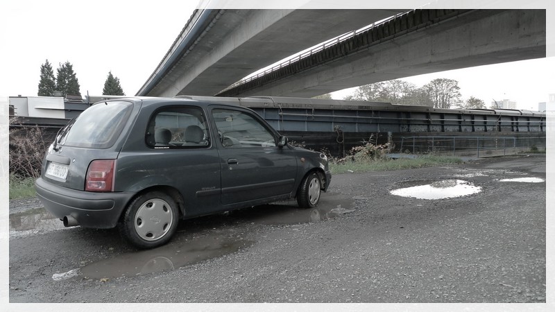

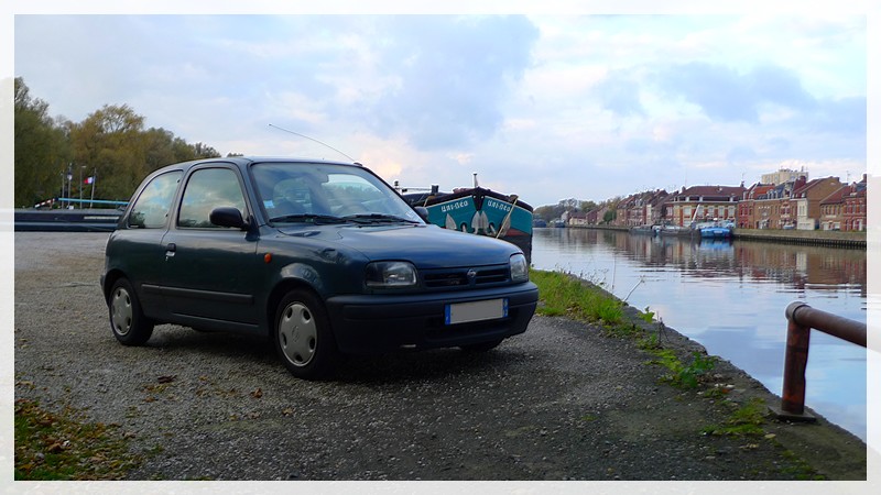

I have always this car but she is different i have sold the wheel

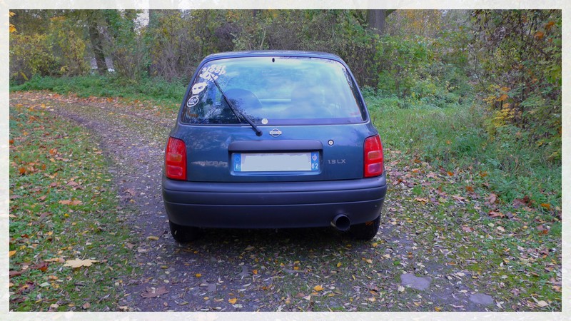

I take new pics :

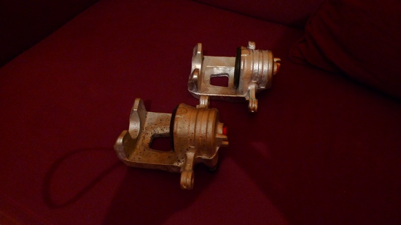

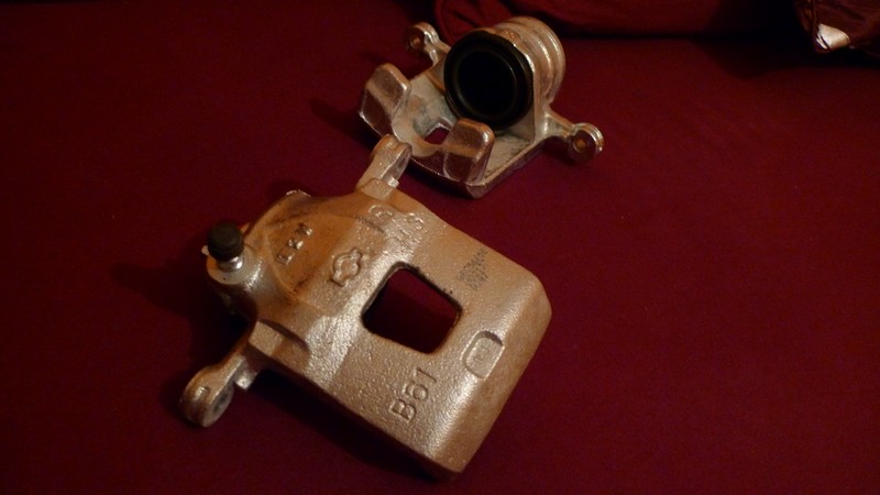

thanks a lot mate so i can take caliper and rotor from sunny n14 its bolt on ? (1,4 or 1,6 ? is the same like 100 nx 1,6 ? and the rotor 240 or 257 mm ? )
Have u a how to do to see me how make it
thanks !
Ok thanks a lot u r the best i love when a men give me all information like u
If u wanna info answer to me no probleme i will help u too
Thanks a lot !
i confirm is the same like 100 nx type b13 caliper

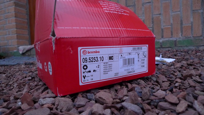

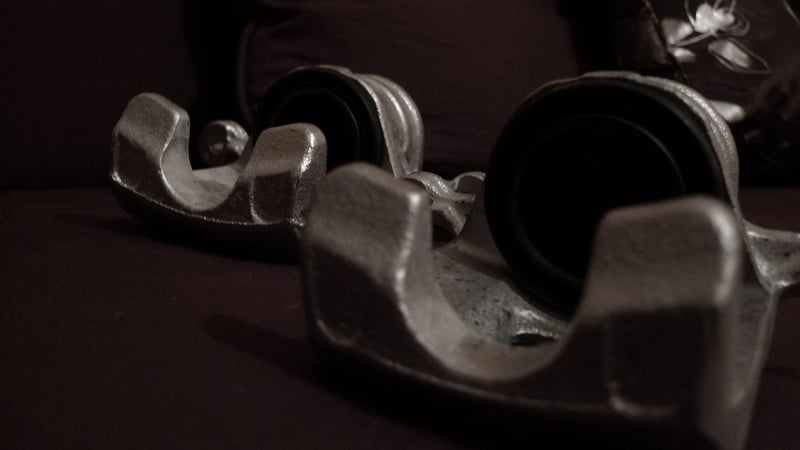

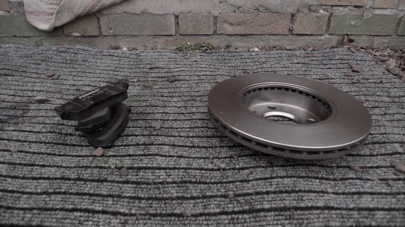

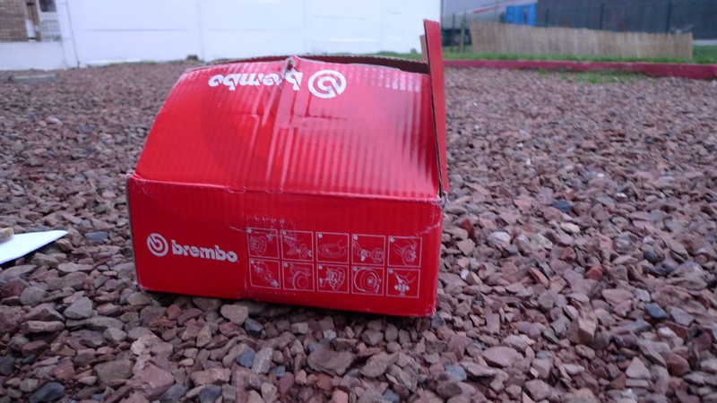

I commande to oscaro set of brembo disc and bar of brake ferrodo
i search caliper at good price in good condition i found at 80 € livred in my house for one new
Great, you will now enjoy braking hehe :) Oh, make sure you'r brake fluid system is 100% air free. You can also change the brake fluid to any DOT4 fluid for an example.
See ya,
Alex
I come with a nice new :p
I receveid my command to oscaro
i take few pics
So rotor in 240 mm with ferrodo

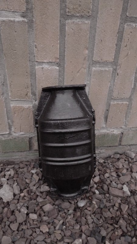

And u can see a nice decat grr
Need caliper now :grinning:​

I have command my front caliper of 100 nx i wait for received them :p
Pics when i have it ;)

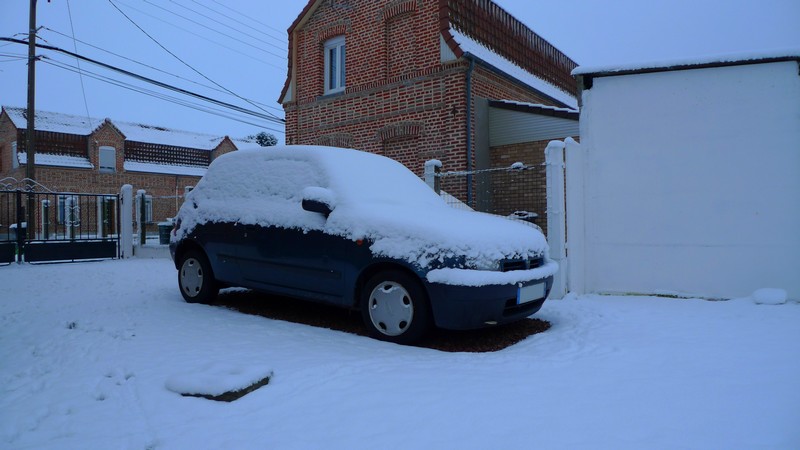

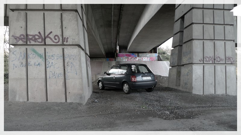

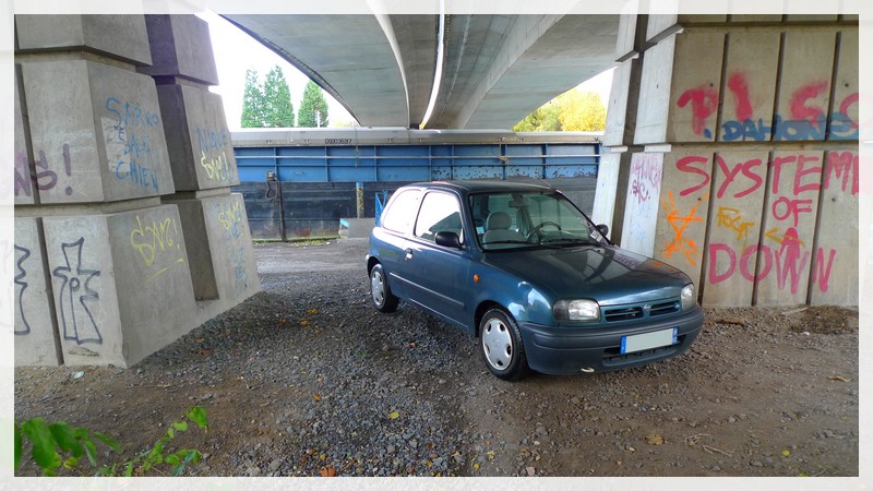

Just one pics of my car with the snow
