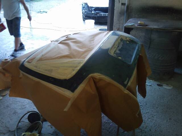

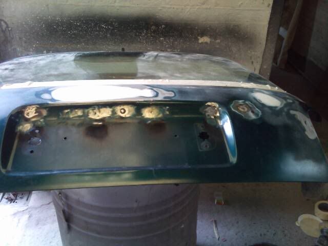

last night i collected shauns boot lid to respray!
so here the progress
heres how it started

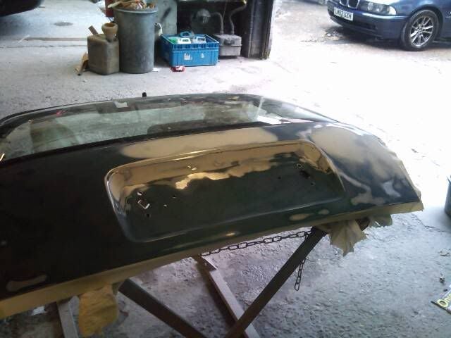

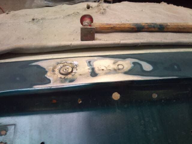

badge and wiper hole welded up
first welds filled and rest completed

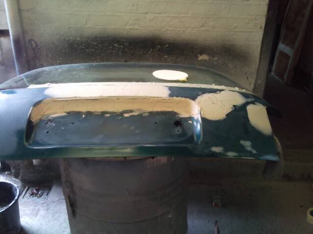

all filled ready to flat
all rubbed down

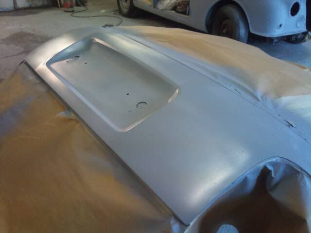

masked up

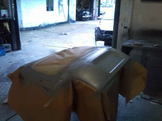

all primed

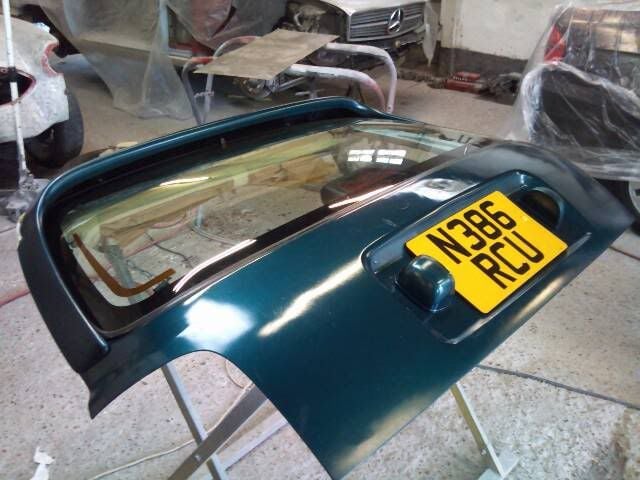

paint is mixed already
bit of stopper here and there will make it neater
only primed the whole lot to make sure the paint doesnt react with the pants rattle can crap!
