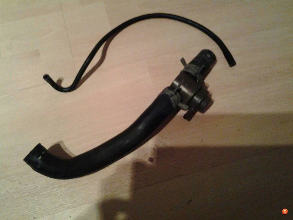

Dump valves something to budget on or buy pricy? Found a cheapy £50 bov on ebay vented as well.
I used a stock recirc valve off a saab 9000. its cheap, recirculates for max performance, and does the job.
some ppl can spend their valuable money on just shiny expensive bling of the same thing but that just depends on the individuals aim & focus (shiny stuff vs fast stuff)
Thats near enough what I saw.
Found a forge recirculating valve for £120 and some forge adjusting springs £20. I dont want a half arsed build if recirculating is better I will go for that.
yikes thats £££ for just a pressure relief valve. the adjustability allows u to have enough spring load to withstand the maximum boost pressure but light enough to respond quickly to reduce boost surge but tbh the little advantage they offer for running small boost on these engines for THAT price ain't worth it.
my used scrappy Saab BOV was just a tenner I think and does the job of maintaining 10psi and releasing when the throttle's closed.
mine,s just a £5 diesel recirc valve, working as a bov/venting to air :)

Rx7 bov.

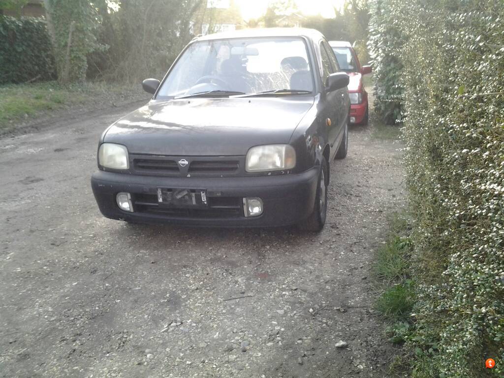

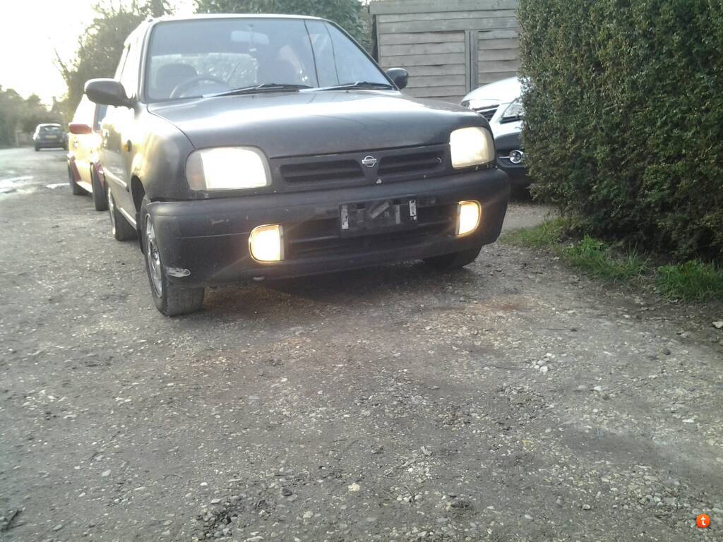

Something happened to the boot lid and the grille?....And the dash pod?
Does it have the import rear light clusters?
Ya IRNBROO's old car I have all his parts.
His was tricky, he wasn't 100% it was a g# he never had mid spoiler or dahspod iirc and it was VERY VERY early
Had k10 hubs ect
Ill ask him and find out :p

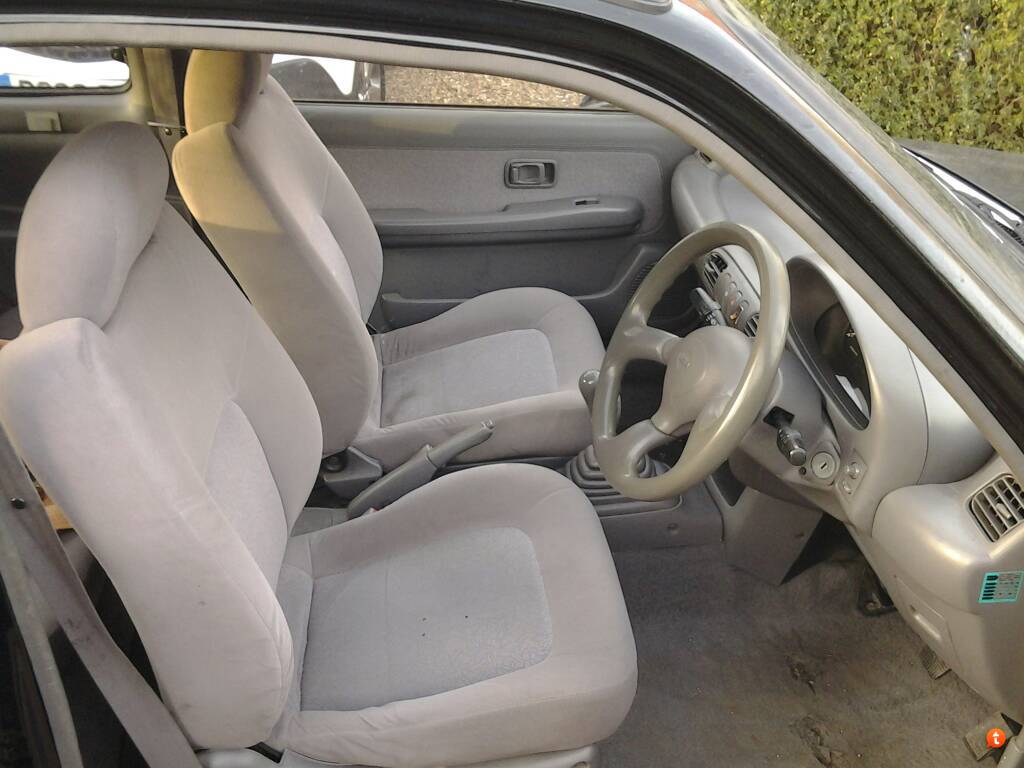

Yeah its got import rear light cluster, jap writing everywhere, plastic lights, plastic rocker, jap stlye airbox, aircon. This is very early its 1993.
The front bumper is damaged so might be a new grille. I dont think all jap k11s had dash pods as well.
its got an import vin on it and even the flare holder, also the spare wheel is plastered in jap writing.
Minus above parts
Looks like a super s and a 1.3 slx
Its minus all the g# goodies hence people's doubt
Got a g# front and rear bumper and mud flaps though.. also intierior. On another note who cares what it is as its going to be turboed!!

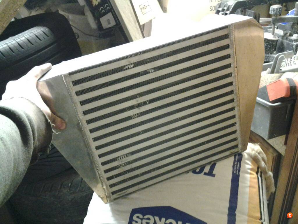

Heres the intercooler. 310mm high, 350 wide. About 60mm deep. Should just fit with some cutting....

I will make that RX7 intercooler fit, try to use the RX7 bov as well
