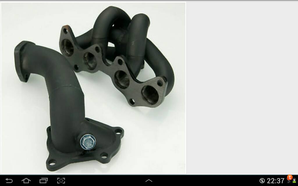

Mild steel tdo4 manifold for starlet. Weld the pipes onto a cg13 flange?
Sent from my GT-P5110 using Tapatalk 2
