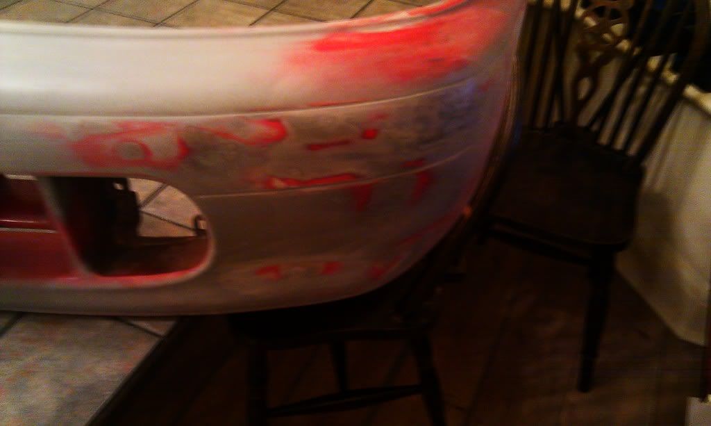

Got on with repairing the bumper i picked up today from eliot! (thanks again Eliot) (Y)

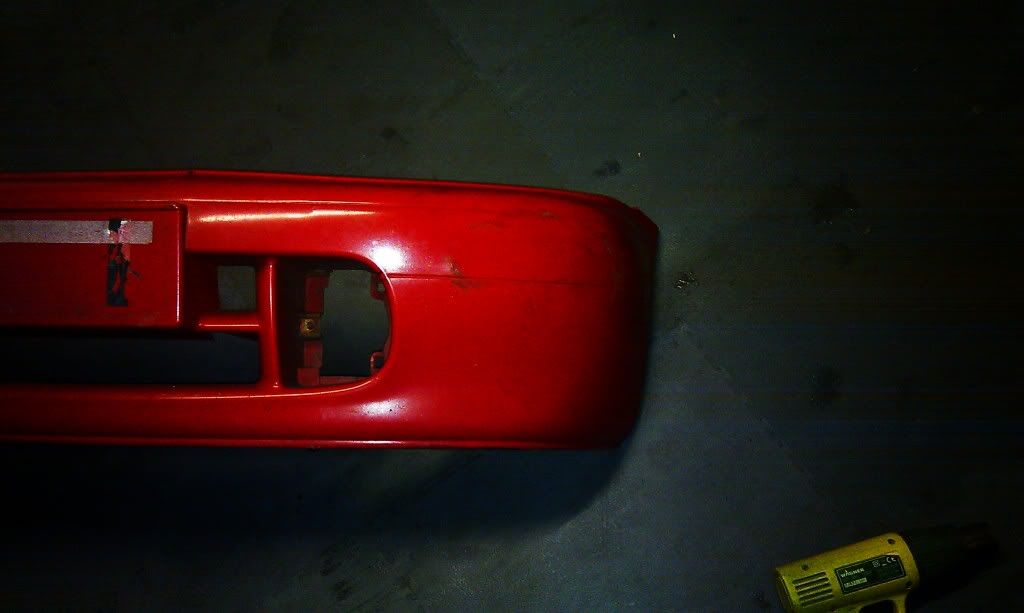

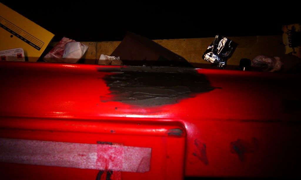

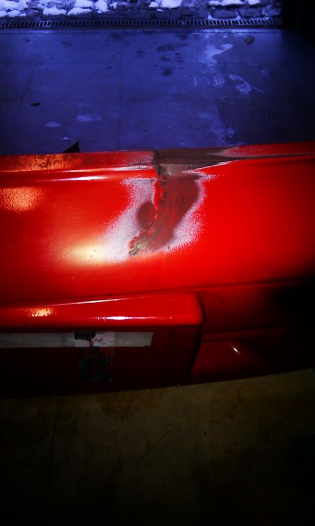

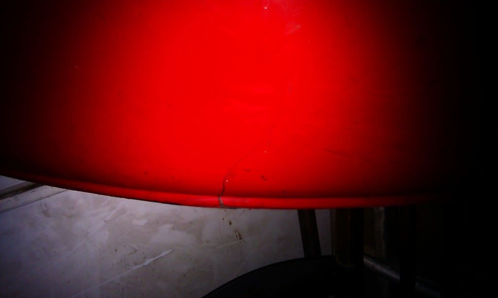

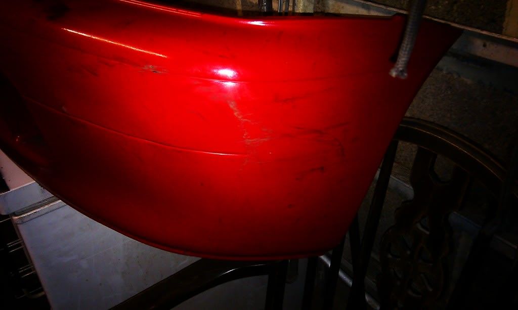

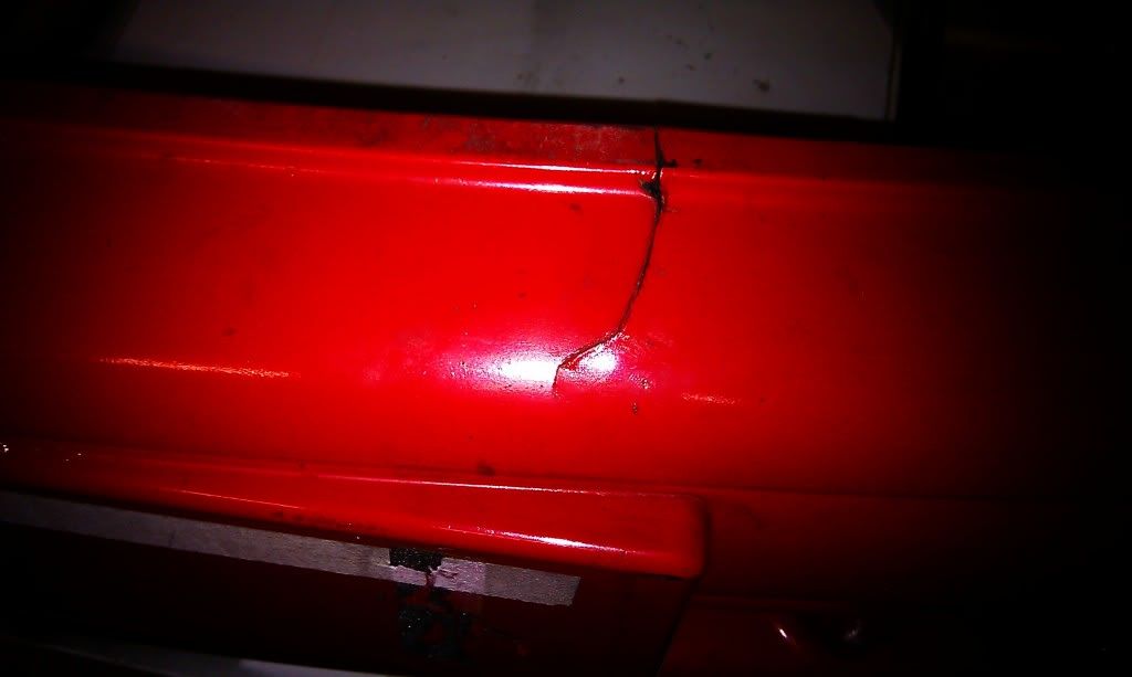

Got a few cracks here and there but nothing too major at all..her some pics of progress so far...
Cracks..Top ones worst than bottom...

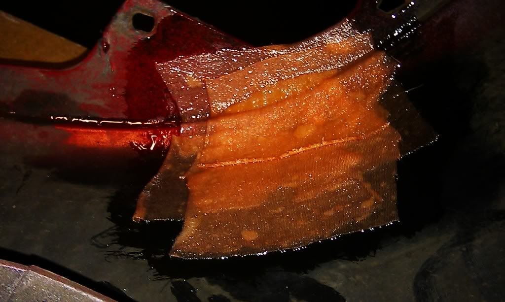

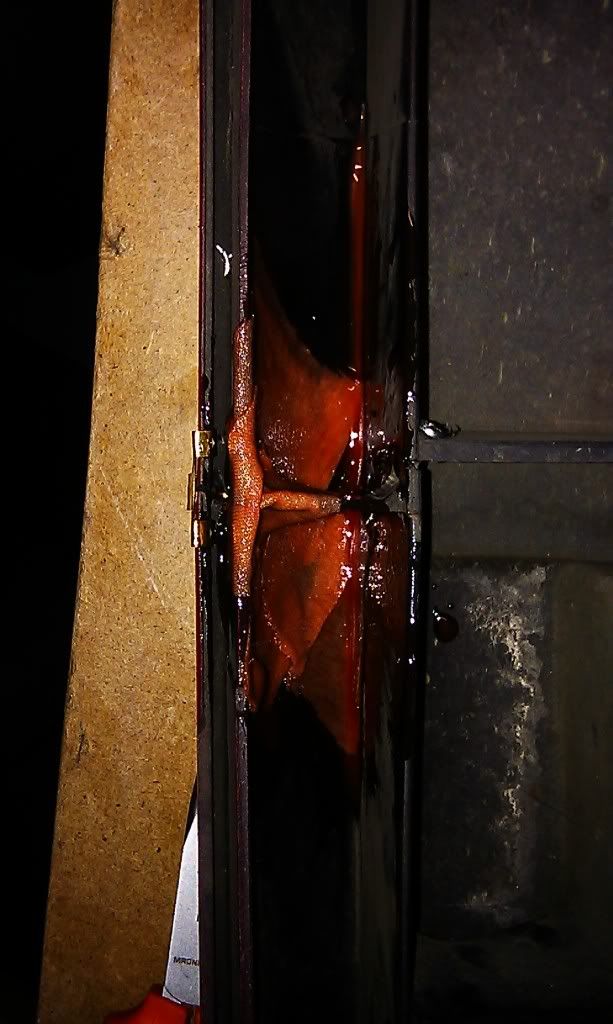

Fibreglass backing so i can then skim over with filler and start sanding (Y)
Going to do another thin layer of fibreglass to back sure ive got everyhwere then get on with the filling and prepping friday when im off from work!
Any comments appreciated or if anyone has any tips, im not amazing at bodywork but fairly confident :)

That's basically what I did with my black cracked super s front bumper, tho I first filled cracks with some mastic and then applied the fiber glass from behind like you did. Don't worry to add several layer, more and more larger if possible.
Now await you the harder of the task: find some Super S pods to fit the bumper ! Best option IMHO would be to mod regular pods bought in a scrapyard.

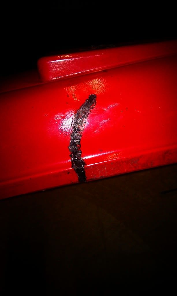

may i suggest somethignf rom repairing many cracked bumper!
that may shill split and show through your best bet would be to heat up a screw driver or something and basically melt the plastic back together.... even its its just on the surface it will make it much stronger
Cheers guys! Just out of interest if I've Fibreglassed the back of the crack so its solid should it still need heating because once its filled it won't really flex for the filler to crack? Thanks for the tip anyways I'm just curious to if its a must or not? And yeah I just heated it up and pushed and moulded it back into shape, there's a few tiny creases but I'm going to lightly fill it and smooth it off..
well its always best because if you tap the bumper at any point and the flexes it is push the filler out as the crack is still theree etc id do it but its upta you mate

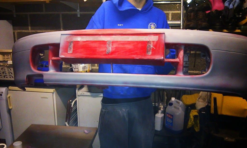

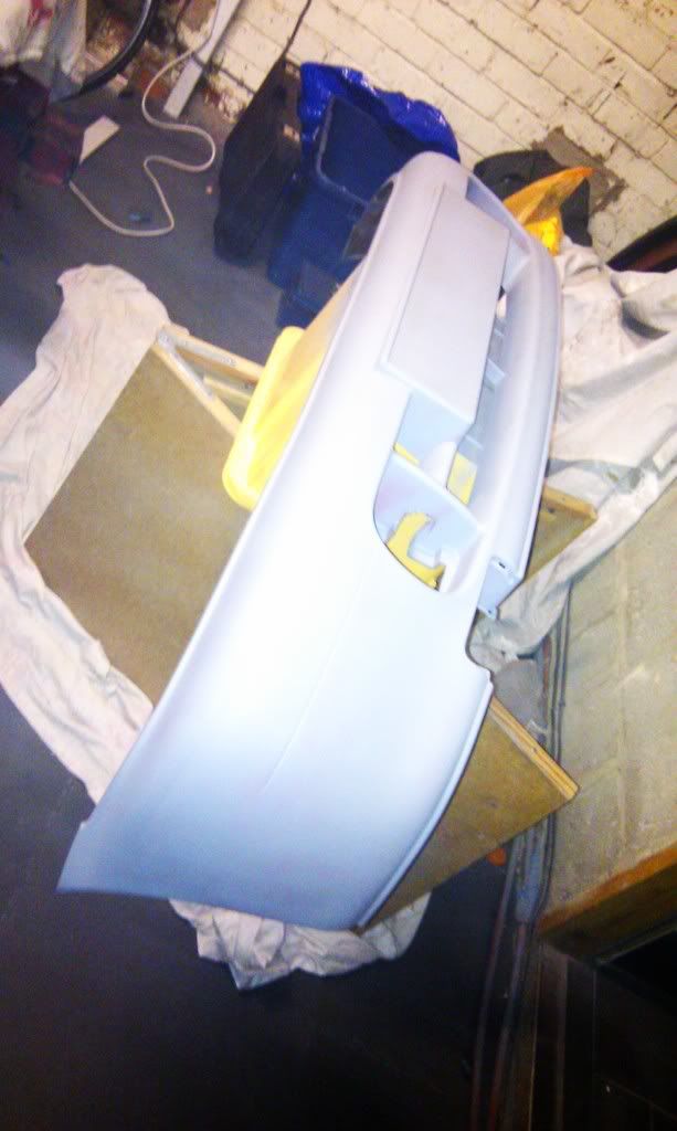

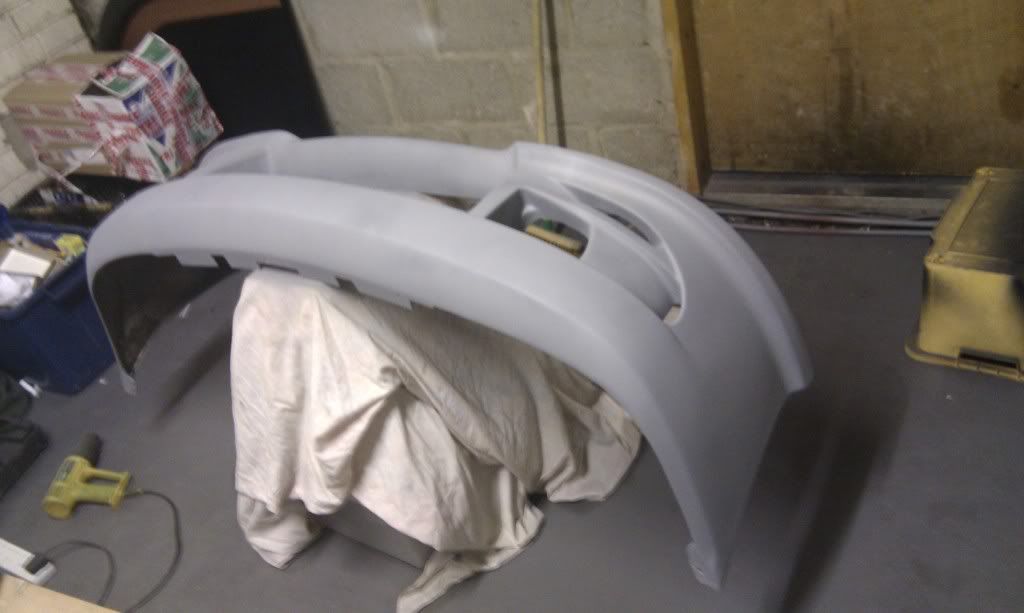

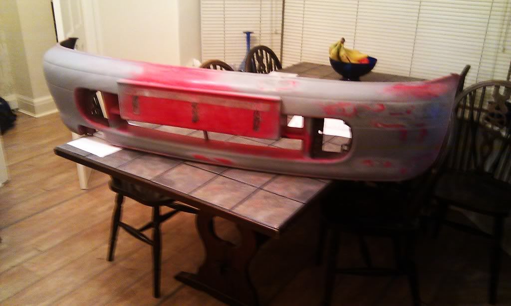

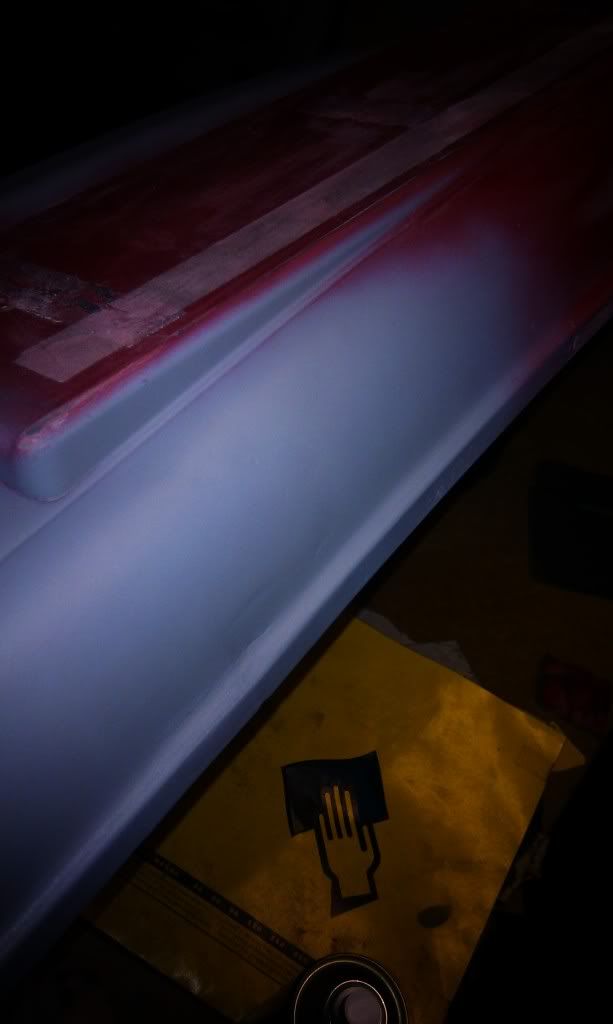

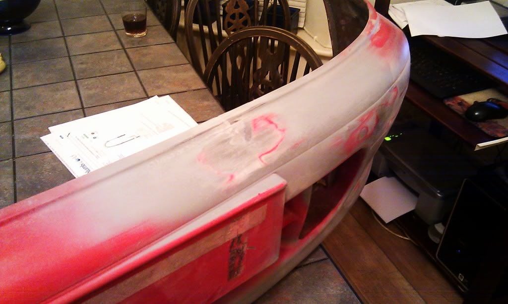

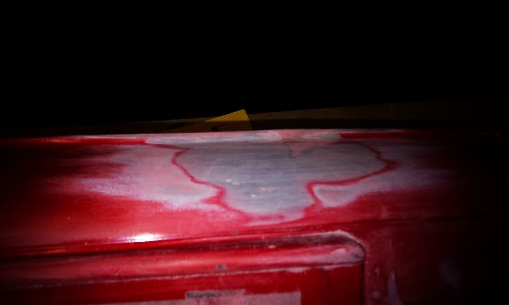

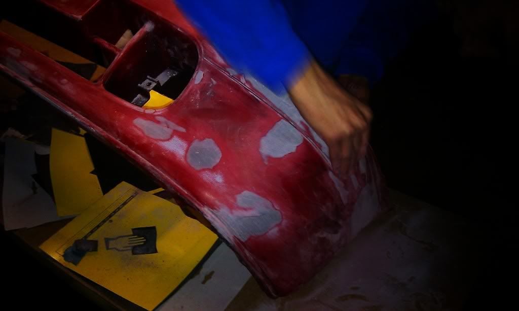

Got abit more on the bumper done today, melted the edges of the cracks together, cheers will930 for the tip (Y) go abit more filling and sanding to do till i prime the bumper but hopefully will have it painted tomorrow, its going satin black and im going to get a rear black bumper and paint that satin aswell..few pics along the way..
Melting...
Sanding...
Filling...
Sanding some more...
Bit of primer on to see if theres any imperfections..
Cheers louis

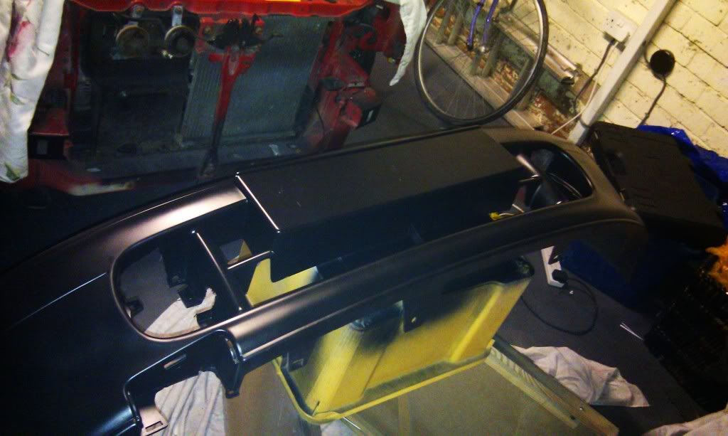

Still needs a tiny bit more filler where theres been a few tiny imperfections when i sprayed abit of primer on to see but heres how it stands, cant be arsed to do anymore tonight so im going to finish it tomorrow :)

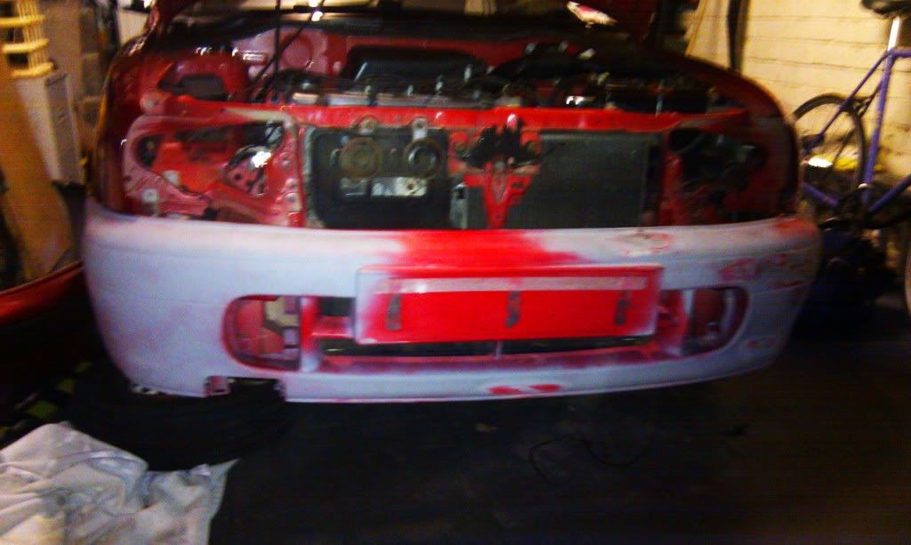

heres some pics!

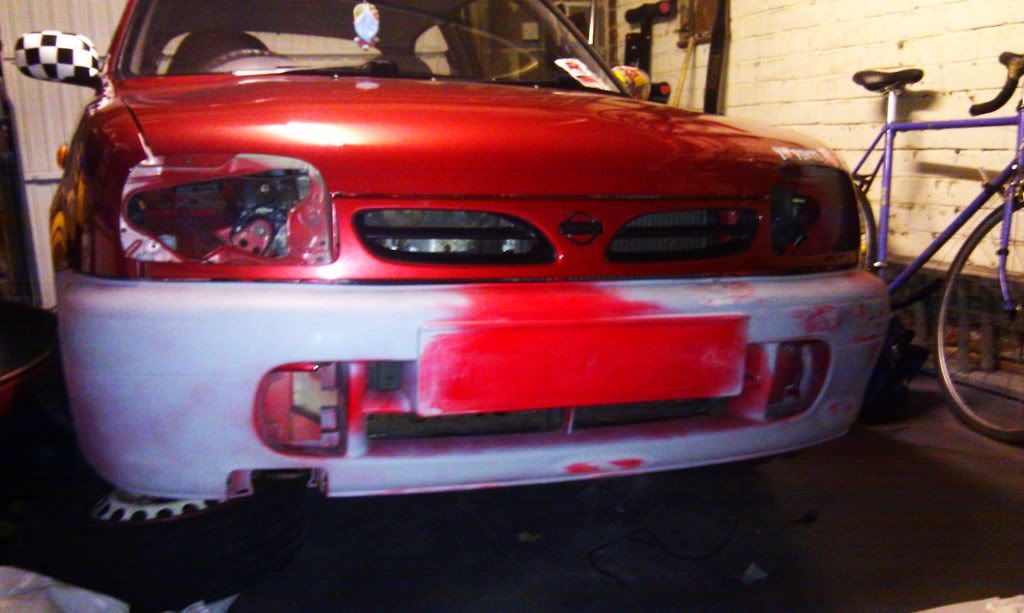

Getting there! just need to finish painting then put the car back together, hopefully quicker than i took it apart...
Impressive fast and quality work!
I had the same problem with the right headlight screw, when I tried to unscrew it, it turned endlessly... had to cut the grey plastic to be able to entirely remove the screw thread, which was turning along with the screw when I was screwing/unscrewing.
So how did you cope with the bumper brackets Louis ?
Cheers for the comments guys.. from the beginning I decided I didn't want fogs in the bumper so I made the bumper fit the car if you look closely I've had to cut part if the bumper away where the fogs sit on either side..you can't see.it once the bumpers fitted to the car :)

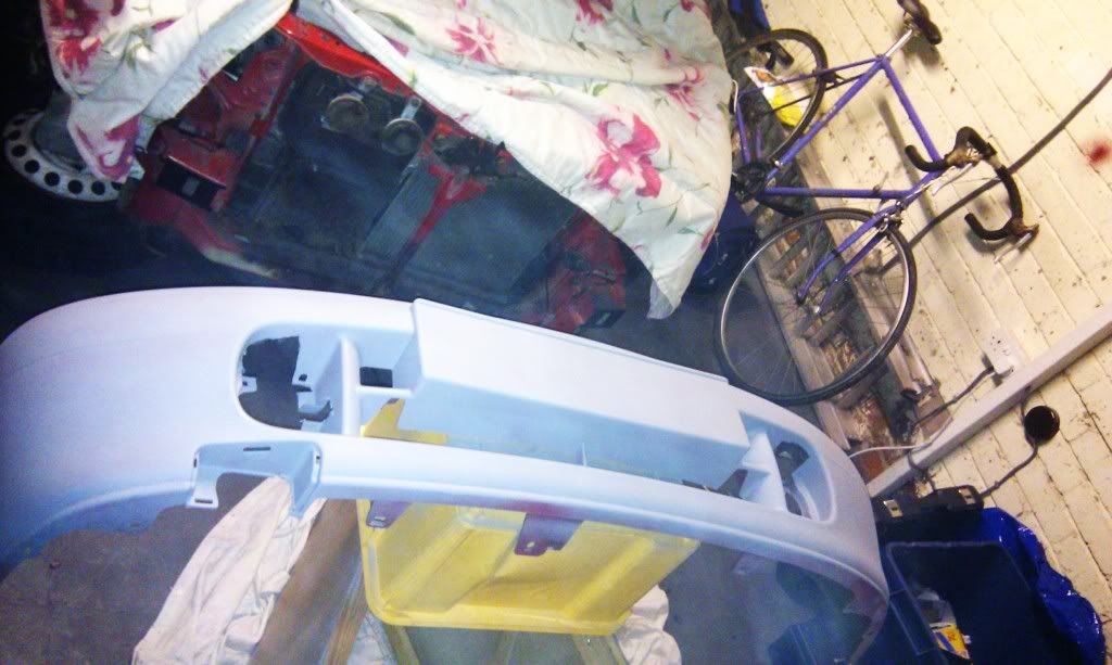

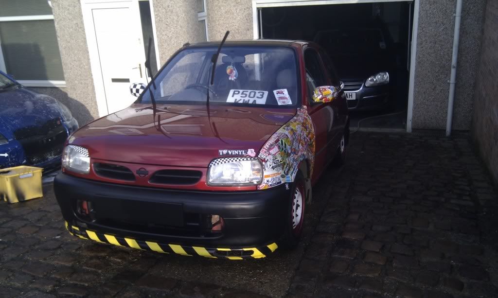

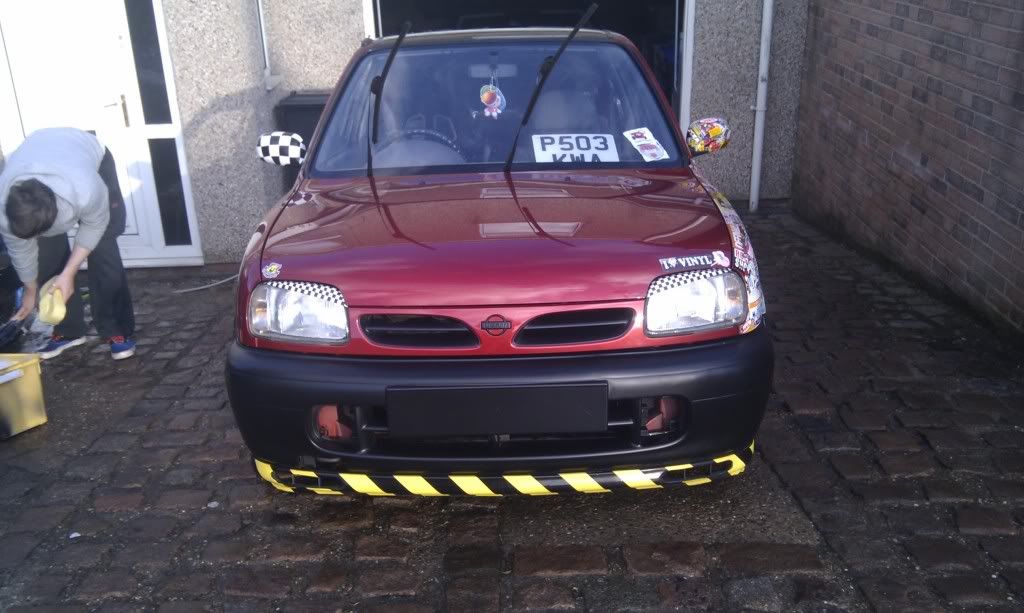

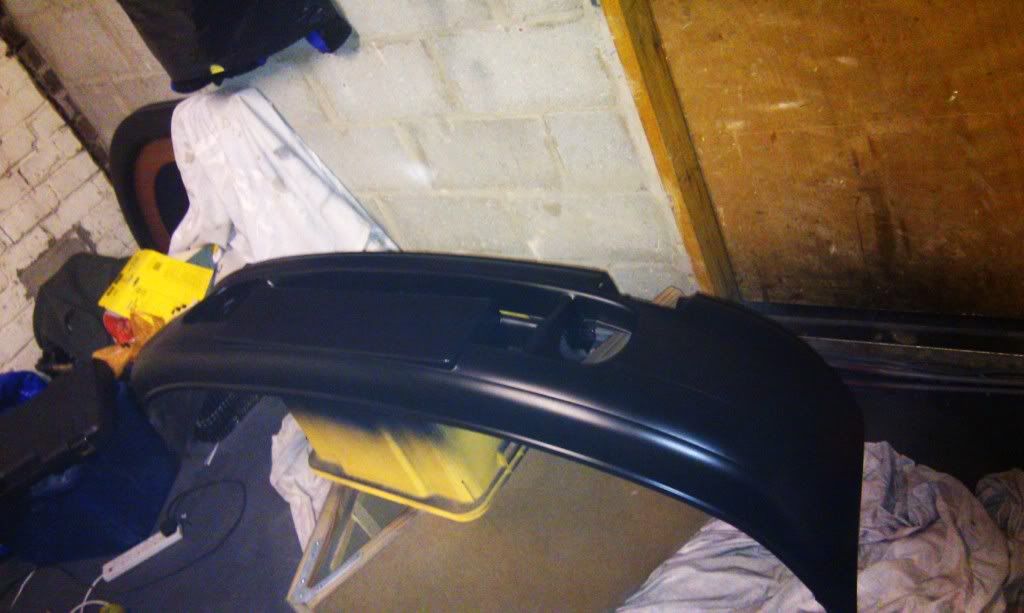

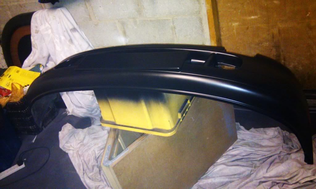

Finished the bumper off tonight! just finished painting it satin black gave it 3 coats and some heat gun action for a while.. going to leave it till tomorrow late afternoon to fit it after more heat gun action..anyways dudes heres some pics!
Thanks for looking! just need to get wheels on end of the month, got the spacers sorted aswell :)
All back together :) going to leave it till tomorrow to take the car out to drive again just to give the paint abit longer to dry..not that it will make much difference should have left it a few days it the housewhere its warm but im impatient :)
Next job is to find a plastic rear bumper, not botherd if its not a super s one and paint that satin black, aswell and putting the wheels on :)

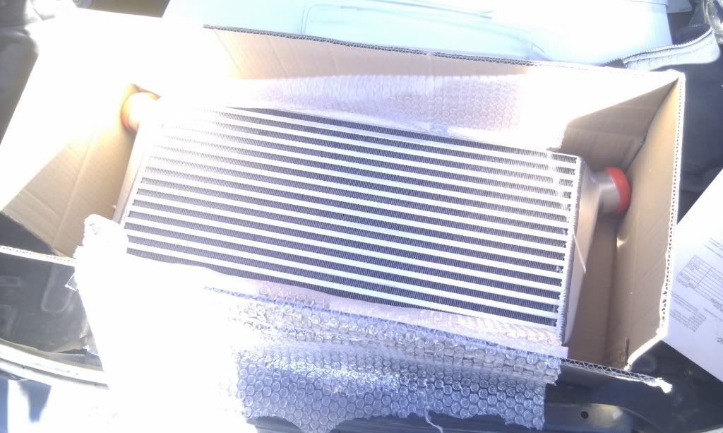

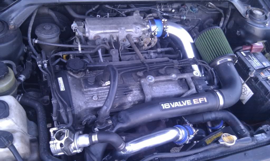

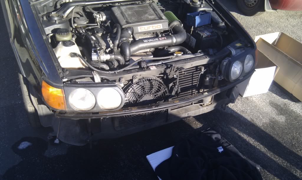

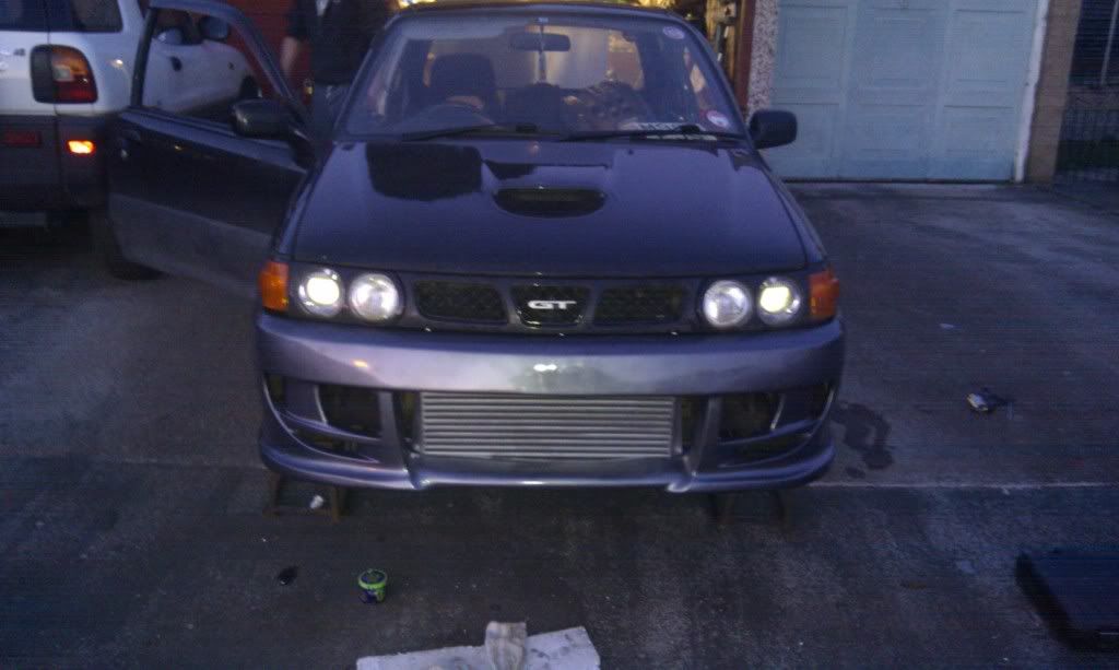

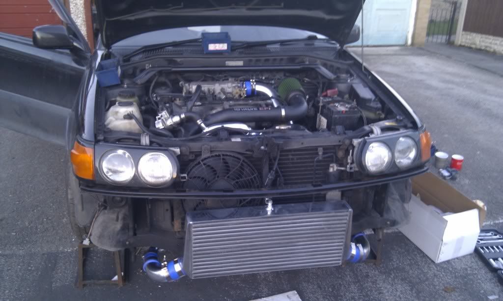

First day off in a while! didnt have anything to do on my car, next thing to go on is tyres for my wheels that are DEFINATELY going on next month when i get payed, started collecting parts for something i may be doing to my 1ltr spesh for the sh**ts and giggles just need to collect some more parts over time :) so decided to help a brother out with some plans on his car, pictures are pretty self explanitory, took us an afternoon! thanks dudes!
Painted his TOMS bumper up for him first..which he picked up this morning...
Then got down with the sickness on his intercooler :)
Not too difficult a job either :)
Cheers for looking..
