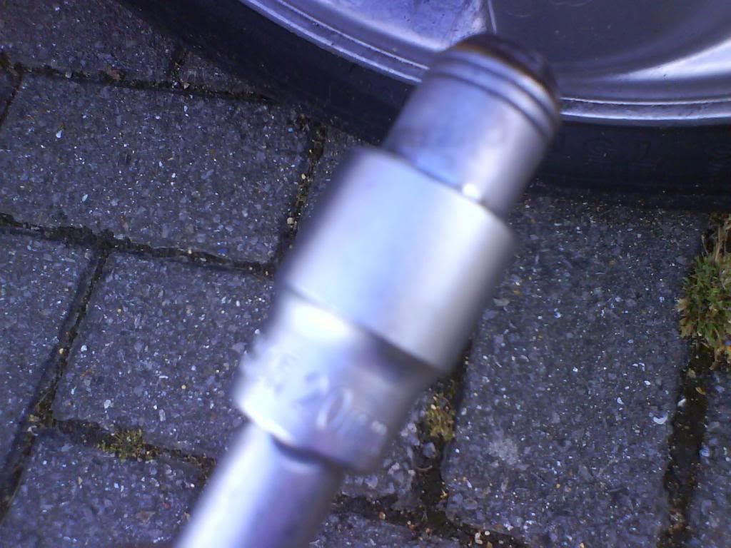

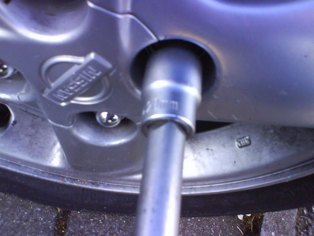

i knock a tight fitting number 20mm on mine yours might be a different size or type that cannot be done like this
1,knock on the socket over locknut evenly
attach extension after as in pic

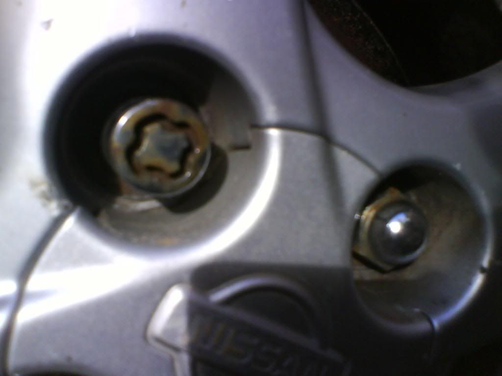

this is the locknut i got
when tightening up just pull back as you do so and the socket slides of,,,,eventually
