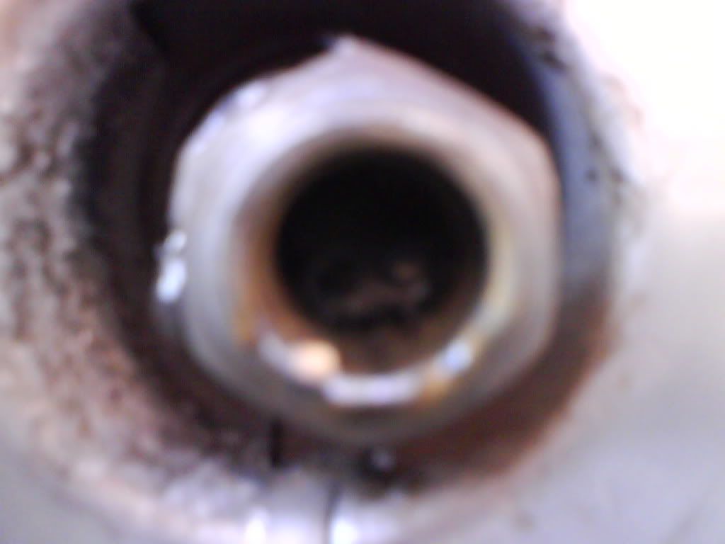

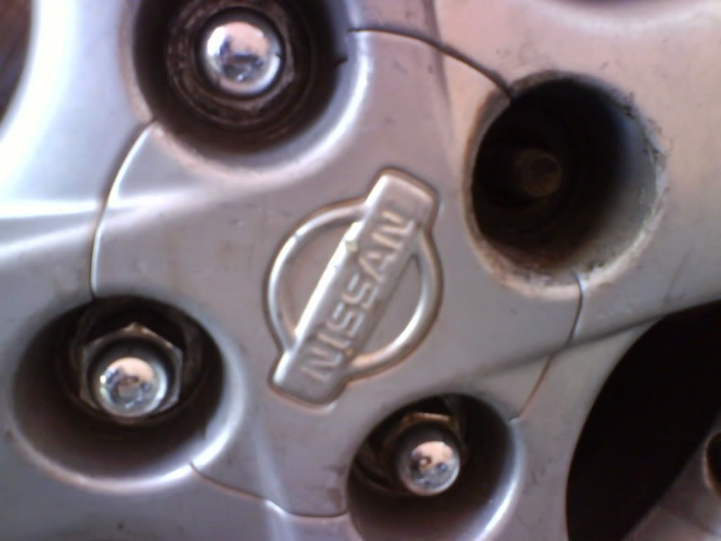

r-reg-sr ------- Site Supporter Aug 3, 2011 #1 key lost now it aint coming off ! oh yes it is ! put a nut over the locknut and weld with the mini stick welder,, its all over no damage just goes to prove what frank said "stick to undoing and doing up the wheel nuts reg" :grinning:
sr20bud Aug 3, 2011 #2 lol nice one did you try banging a 12 point socket over it? that worked for me when i lost my locking wheel nut remover
OP OP r-reg-sr ------- Site Supporter Aug 3, 2011 #3 sr20bud said: lol nice one did you try banging a 12 point socket over it? that worked for me when i lost my locking wheel nut remover Click to expand... may work for a while until things ware down
