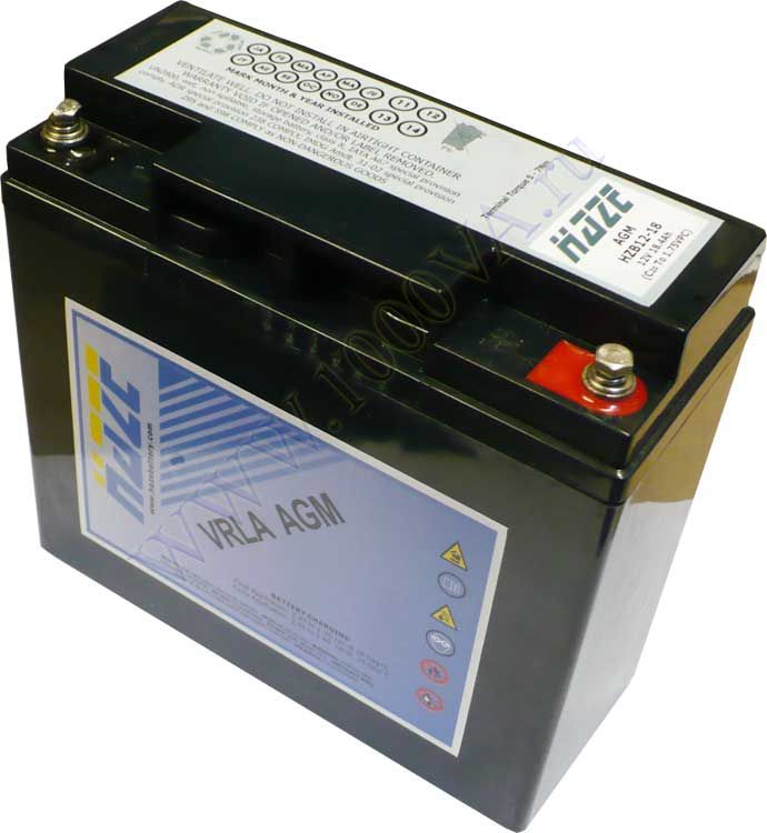

Here is the one I bought
http://www.rapidonline.com/electrical-power/12v-18ah-sla-battery-hzb12-18-18-1172
CCA 270
5.5Kg
Purchased here
Ebay item no 121015005969
£35 delivered = WINNER!
Saving = 6.5kg and £20 (ish)

Take a look on the table! Check the tech specs carefully, they vary. Also ensure its AGM and not Gel, the CCA can be significantly different. Though I'm not saying gel wouldn't work, more is better.

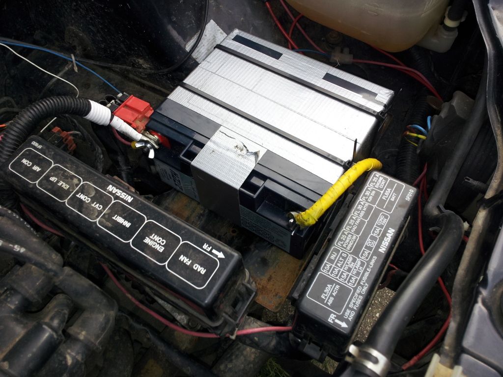

This one has M5 threaded inserts with bolts into them. I screwed 30mm grub screws into mine and secure the terminals with wing nuts. I used a Dremel to cut off the rings from the stock battery wires, leaving me with an eyelet is where the bolt once fitted.

Yeah, I was looking at the gel one but the specs are contradictory, thetable says 270CCA with the actual unit itself which says it only has 60 or so CCA so might have to go for the liquid one you got there as I don't fancy a £50 paperweight!
£50 is expensive, there is plenty of choice cheaper than that. Just fyi AGM is not liquid, it too is spillproof as the electrolyte is Absorbed into a fibreGlass Matt which is why it gets it's name.

Just cut the loops off the stock battery terminals leaving the clamping bolt holes on. Bolt those to the battery. I fitted 30mm M5 studs and used wingnuts so I don't strip the threads in the terminals.
Cut the back out of the battery tray an re route the earth strap slightly. Pic should make it clear. Now held down with ratchet strap.

I relocated my racing gel battery under the passenger seat like this to save & redistribute weight and provide more bay space
DIY terminals
http://micra.org.uk/threads/pollymobiles-rebuild.35251/page-16#post-439222
extending the loom and fitting the battery
http://micra.org.uk/threads/pollymobiles-rebuild.35251/page-16#post-439556
oh also remember to clean the ground cable-to-chassis contact to bare metal
I added a small ratchet strap in addition to the tie wraps in the picture the same way around, ie front to rear to further enhance its security, it wouldn't budge then.
