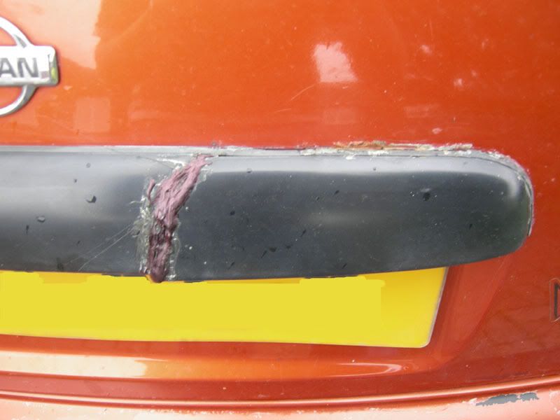

The boot handle. Currently held together with glue
I am aware this is a common problem with Micra's but the boot handle has been bust since I bought the car, and today! I called up my nearest scrap yard and spent £10 and got a new boot handle...yay! I'll be fitting this later.
Having some issues removing the inside panel of the boot to uncover the fixings, the screws turn fine but it doesnt seem to be freeing the panel. Any ideas?

Its a common problem because people use it as a boot handle, when its not :) the earlier ones are purely for the lights, which is why they break. Not really an issue as i doubt you'll use it as such now youre replacing it :D

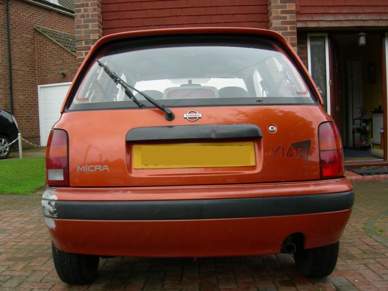

After that its sorting my rear bumper out. Its in bad shape, I took it to a paint guy and he said it would need stripping down completely then sprayed. So it would be cheaper to buy a new bumper and spray that. So i'll be looking for a bumper.
You can see it needs some work. Any ideas are welcome.

with the fixings in the boot panel, you have to screw the inner core out (it needs some help/leverage to get the thread started tho)

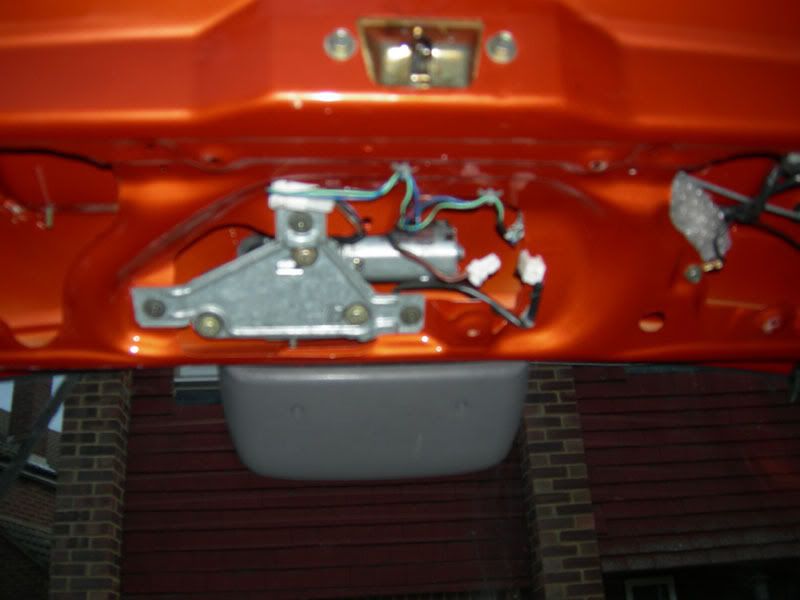

Managed to get the panel off, then saw the current lights on the "handle" have a 3pin connector and my new one has a 2pin connector. So im a little concerned, my new handle is from a k11 but its not from a vibe and is infact ever so slightly thinner from what i can tell, and i think even less than a mm shorter in width, the screw holes seem to marry up, but im just doing by eye as I havent removed it yet as im going to wait for a friend of mine to come over later and give me his advice. So fingers crossed it fits! even if I have to change over the lights.
So! I managed it. that whole worry I had with the light connection turned out to be a false alarm. I had completely missed the right connection and was looking at the wrong damn wire. So panic over. lol.

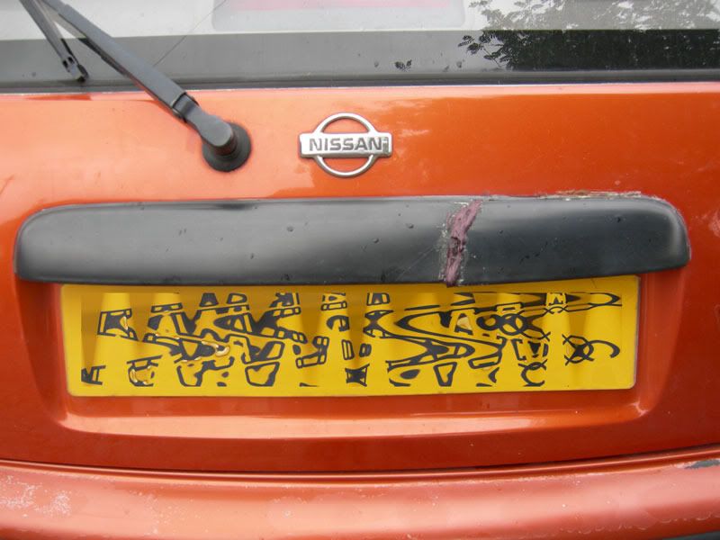

Ok so this is what we had before.
Glued together, looked like crap.
This I thought i'd post just so people have some reference. So, panel off.
Wires going in, almost there.

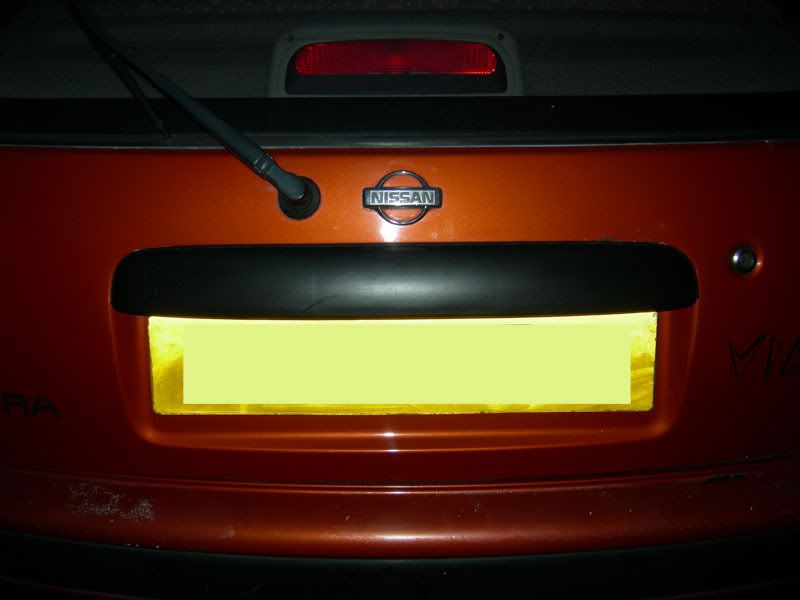

tadaa! all done, looks much better. almost like new! hehe. Im sure that added at least 10BHP....hmm or not. But anyway. a small job that took me multiple attempts but I finally cracked it. Im a complete car noob, so im pretty proud of myself. Especially when I tested the lights on the new handle and saw that one of the bulbs wasnt working, so I unscrewed it's casing and replaced the bulb with one from my previous handle. I know, replacing a bulb, look at me. Anyway. thats that done. Next is my new CV gators and tires fitted on saturday. then I drive it back up to Dundee (from Herts) to my new flat on monday.
