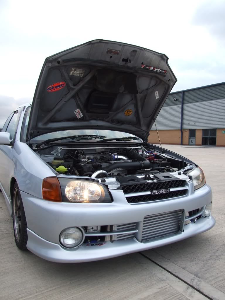

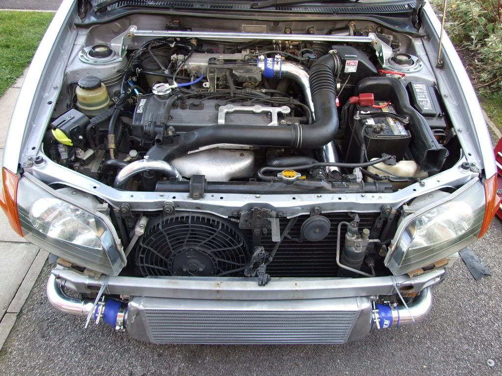

HDI intercooler now fitted........phew lol!
turbo_pipe
The first of many issues with fitting this kit was getting the intercooler pipe from the turbo past my relocated air filter setup.
airfilter
Managed to re-position it to allow the intercooler pipes to run by it.
airfilter2
I might have to get some more samco and piping as the airfilter piping sits a little lower to the ground, there is more clearance then it looks, but it's about an inch lower then before due to the piping.
hdi_intercooler
Temporary cable ties holding the intercooler, only drill bit I didn't have for metal was the one I needed grr. It's still fixed securely with mounts underneath into the chassis.
hdi_front1
Lots of trimming required to get the huge cooler to sit behind the bumper, reasonable neat job, however I've decided I'm going with a custom bumper soon anyway, so I wasn't too worried.
hdi_front
Another pic from the front
engine_top
Engine now looks much more open and easy to work on, next job is to give a big clean up.
Also notice no BOV, I inquired about my HKS SSQV fitting with the new setup, I was told it would fit fine, but after buying the small samco hosing, I now need another adapter as the one I have only works with the stock intercooler setup.
So I now have to wait until I can get that part to even drive the thing.
Anyway lots of progress made and nice to actually get some time to spend modifying the car
Kev

She Lives!!!!!
Manifold is a japspeed which I bought from Toy Tuning when they where a reliable company lol!
I've managed to diy block the bov flange off, thank you B&Q plumbing department lol! :D
Did a road test to check everything and wow what a difference, now pulls like train, very smooth acceleration on boost, Turbo seems to spoil up much quicker. The chatter from having no bov is a little annoying, but I have the correct parts on order to put back on my HKS SSQV this week.
No boost leaks or knocking noises from the kit, fitted very well and all secure. The Reg Plate is staying for now, I've done quite a tidy job with the cutting and I kind of prefer it where it is.
I really want to up the boost now, but need some supporting mods, but getting close now to how I want it.
Well chuffed :D
Kev
