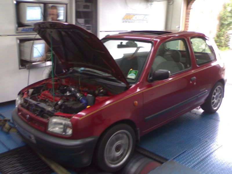

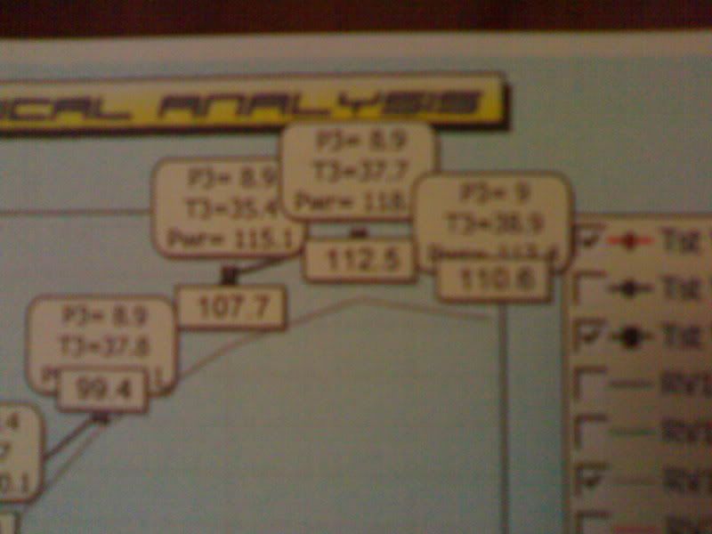

so today i was at ava n i got the car mapped, it ran 118 at the wheels n i will post up the pics of graph to let u all see, but now it doesnt start. wen i looked at the apexi it said the air flow was at 97% with jus ignition on so i guess wn i try to start it i jus get it floding engine due to it being so rich.
i tested this on 3 TB n i got 97% on all 3 n the guys who tested car said the 3 tbs seems to be working from jus a quick check
so any ideas?

i got the car running again, the apexi was on the wrong sensor type, it was on flap when it should be hotwire

no this is not true, when i spokr to the guys who rolling road my car at AVA they said i need to look at seriously altering the exhaust design as it may BURST INTO FLAMES AT ANY TIME
they said this as it melted my dipstick, so it is coming off road to prevent another engine fire and let me save for both exhaust and ecu improvements.
curently the car has the dizzy turned bk 9 degrees i was told by andrew but i will be testing this and it is on an apexi safc, which i am changing to fit an apex power fc for more refined tuning. also the head is sitting on a 2mm aluminium spacer plate with 2 headgaskets, 1 at the top and 1 at the bottom.
as for the fuelling i have a walbro fuel pump toan fse boost sensitive fuel pressure regulator and 1.6 injectors.
any question or pic requests feel free to leave and i will get back to u all
stephen
