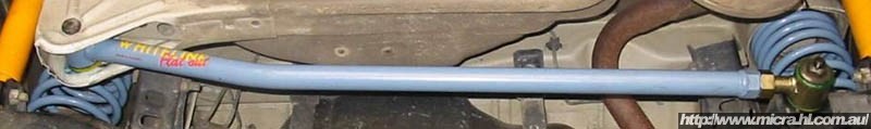

Do you have an adj panhard rod to replace the standard one?
I'm afraid you need it, mate, big time.
Check some more info on here 'bout the panhard rods and why it's so important to have it properly set... If you need some help, let me know, I'd make some time to explain you...

Here is a copy-paste of a most credible info about them rods:
Panhard rod suspension
Here's a simple illustration to demonstrate the problem with the rear suspension set up that micras have. To prevent the axle being offset too far as in the second picture when the car is lowered, you should get an adjustable length panhard link.
Panhard link (blue) when suspension is fully uncompressed and standard
Panhard link (blue) when suspension is either compressed or (lowered and uncompressed)
As you can see, in the second picture, if you simply put shorted springs in your car without shortening the length of the panhard link, your rear axle offset becomes too great, and the left wheel becomes further in under the guard while the right wheel protrudes further out past the guard.
An adjustable panhard link will enable the axle to have a decent starting offset even while the car is lowered. There's nothing you can do about the axle offset increasing as the suspension is compressed ie when hitting a bump, however if you set the offset up correctly when uncompressed, its not an issue as it doesn't change enough to worry about when hitting bumps etc.
Additionally, from my discussions with Whiteline Automotive after overhauling my suspension, they told me that lowering without an adjustable panhard rod also had a terrible effect on the rear axle toe. This makes perfect sense, as its a multi-link design, when the axle offset changes, so does the rear axle toe. Basically one wheel's toe was almost straight while the other had massive toe-out (terrible for handling and tyre wear).
More advanced designs like the "Watts link" featured on solid axle rear wheel drive Ford Falcons combat this problem by a weird swivel type link mounted in a central position. This eliminates the one-way axle offset issue associated with the panhard link design.
The panhard link design allthough frustrating at first, is simple and easy to make perform well.
Now... I have lowered my car with only 30-35 mm and used a substitute of an adjustable panhard rod - Frank's made bushes:
You may ask Frank off here to do a set of them for you. They're about 12GBP. I have them on and they do the job, But I experienced this:
scaled.php
It's down to my style of driving and the bushes combined I suppose, cause here you have no flexibility, the bushes are fixed and tight. I replaced the snapped rod and had no probs so far, but I'm already looking at the other option:
A proper adj panhard rod.

If you are to go any lower in the future, the adjustable panhard rod is a MUST.
I should have gone for it at first place, but did not know that The Lowering Bug would catch me sooo fast :p
