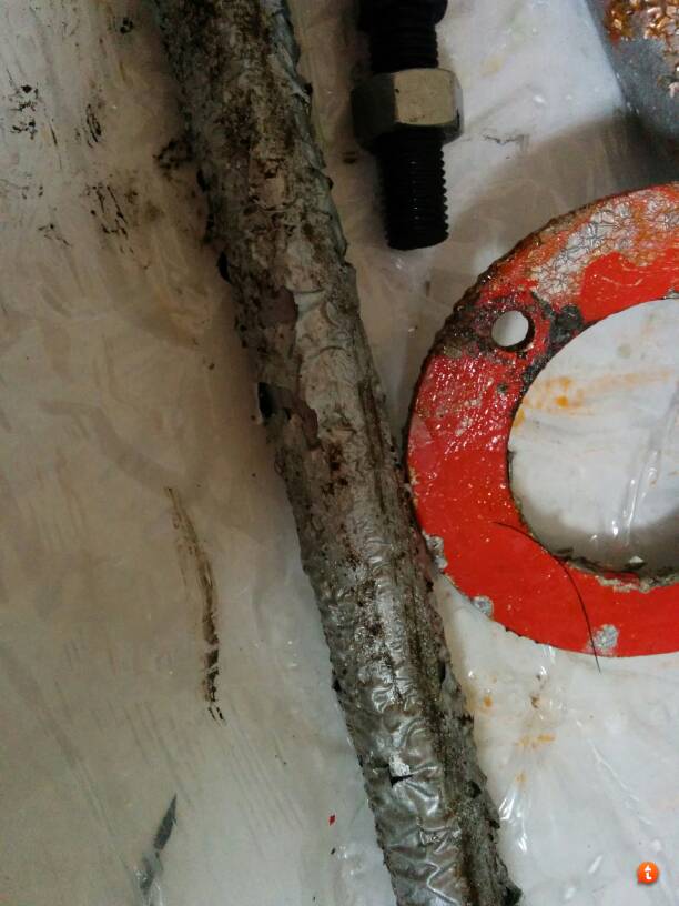

Going to get some Hammerite on those bars, especially on that panhard rod as it's going to get some abuse. The inner metal sleeve is missing from the bush on the panhard rod. Is that easy to replace or do I need an entirely new bush?
Those springs look beautifully packed...as if it was done by a true craftsman, an artist...
