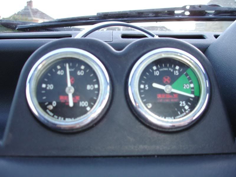

my vaccum gauge has a scale of 0 to 27 in hg and it never hits 0 or goes over 27, but mine is a specific car gauge, look on ebay there are loads, i wouldnt buy an industrial type one.
got a pic of mine here, note it is in inches of mercury
also note that the car was on tickover on the pic, the only time it ever goes higher than that is when your coasting down a hill in gear but with no throttle on.

oh and is the dial on the left a speedo?
