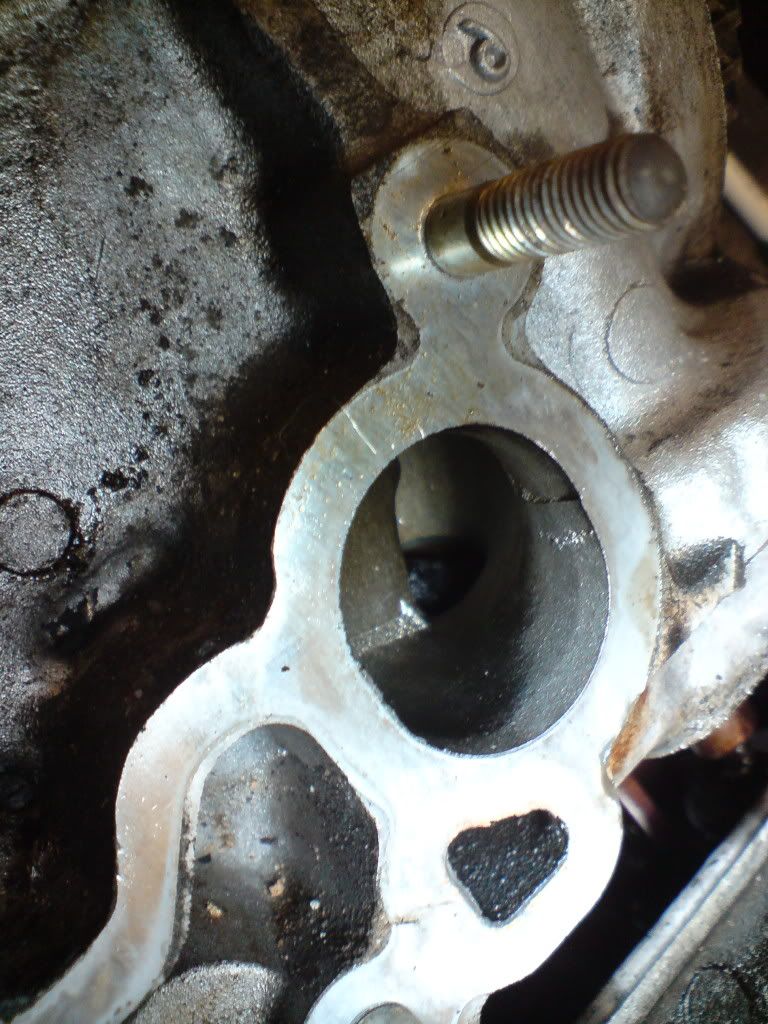

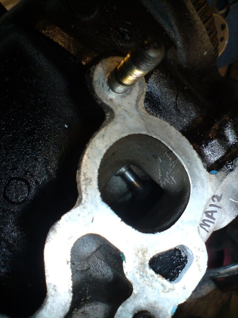

Now with pics!
Right then, the valves are the same size on both the heads(Y)
The combustion chamber in the head is the same depth on both the heads but the dish is smaller in diameter by 1.7 mm, this suggests to me that the MA10 (4 speed) head is fractionally higher compression.....................................
However, whereas the MA12 head has inlet ports that look like this:
The theoretically higher compression MA10 head has inlet ports that look like this:

The outer port size is the same but the area round the valve head is smaller.
My heart says biggest most direct route into the cylinder (ie MA12 head) but is there something really obvious I'm missing?
The swirl does just that, swirl the intake charge to promote better atomisation, and therefore better economy/emissions, I would suspect at the loss of a bit of top end power. Also, the 1.2 has a bigger diameter head as it has a bigger bore! So, gains lost in putting a theoretically better head on a 1.0 are lost by the drop in compression.
