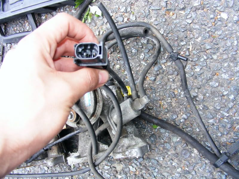

Ok so removed the EGR system over the weekend with the help of mckenziecz and to our suprise it was quite simple and quick. however we are now left with some odd ends that the guide on the forum does not show :( any help would be appreciated.

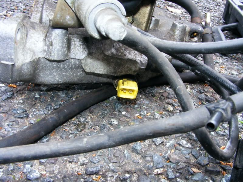

the 2 connectors in the second pic look like the inlet temp sensor connectors, did you not fit them into the new inlet mani like we spoke about?

can you post a pic of the 2 sensors that the leftover wires went to shaun ? (a water temp sensor is needed for the eccs to work properly surely ?)

at a guess id say one ot the connectors are for the egr valve,

well we couldnt get the sensor out as its an 18mm and didnt have that to hand :( and adjustables just wouldnt cut it, will have another bash at it again at some point.
and i dunno if your sensor plan will work but there is more than just one clip left over :(

dont worry about any EGR valves/connectors shaun, but you need that coolant temp sensor tho (for the ECCS) i,ve got k11 ones if you,re stuck :grinning:

what id do first to try is, when you remove the sensor from the manifold, plug it into the connector, cos is sounds choked up to me, and if the sensors not connected it open circuit so it will think its really cold and pump more fuel in.

That rubber pipe sticking out of the chassy leg on the right hand side will come out with a wiggle and a tug, it was the drainage pipe for the fuel vapor collector (black box) that you have removed. Also one of your connectors may be for the boost sensor, and the fuel vapor gasses and exhaust gasses that are fed into the inlet are controlled electronically so you will have wires for those. If you are running the engine without the airbox on, make sure you plug up the vaccum pipes the connect to the bi-metal valves in the airbox, or they will throw your mixture out (make it very lean) and kill the engine.

if you keep your foot on the gas lightly it will sit there quit happily idiling as soon as you take it off after say 30secs it will choke and die. will try and fit the sensor into the coolant pipe on the back of the inlet tomorrow as we need to get hold of an 18mm which my fairly basic tool set doesnt consist of!

Tried to T-junction the temp sensor and Oh yes a big thankyou to mckenziecz for all the help and the lovely blue hose! It starts and idles ok had to adjust the carb a little bit this is what we are thinking now as the idle is still a bit rough.

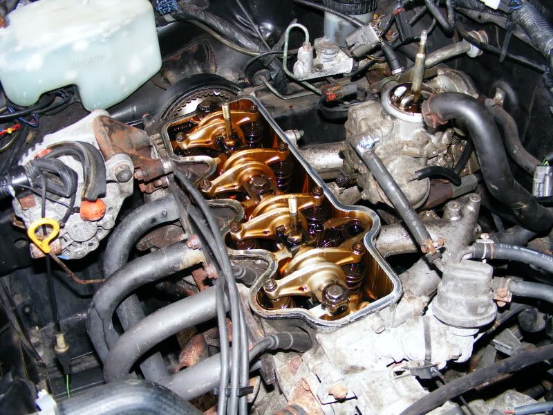

oh and heres a picture of the inside of a 18year old engine:
not bad eh? (Y)
