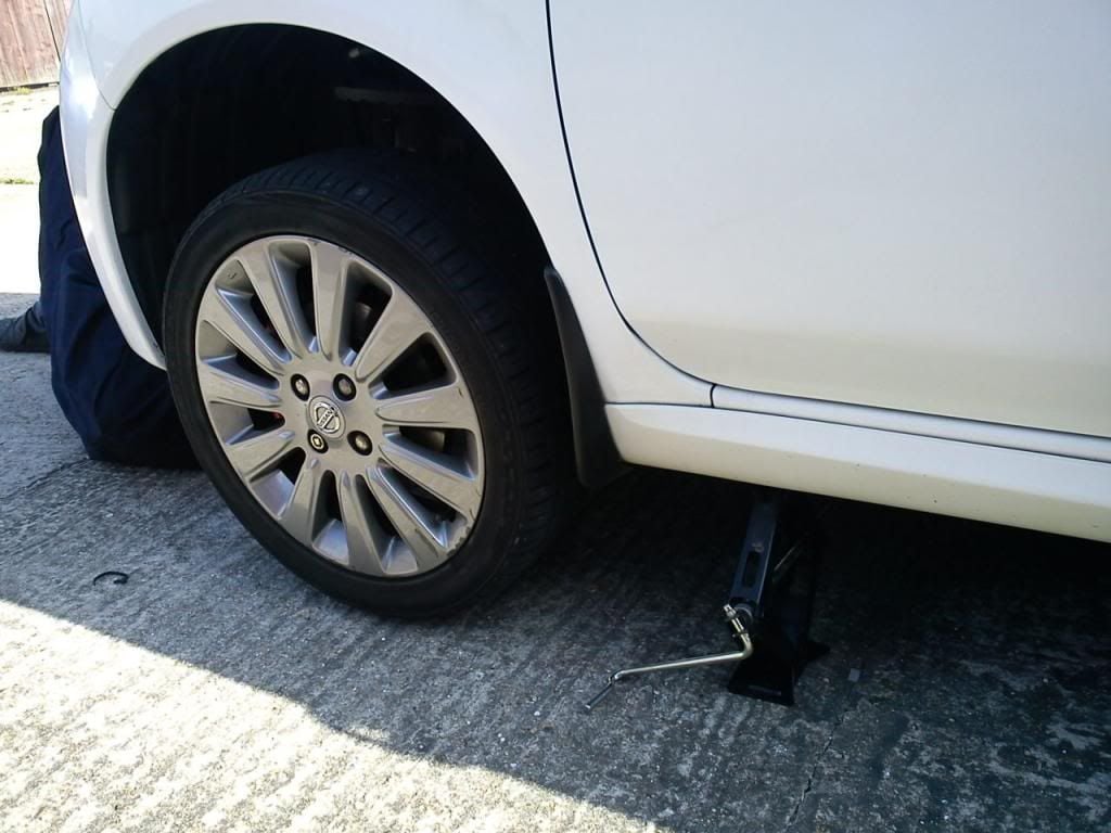

Jack up car....both sides...at the front, obviously...place on axle stands for extra safety....

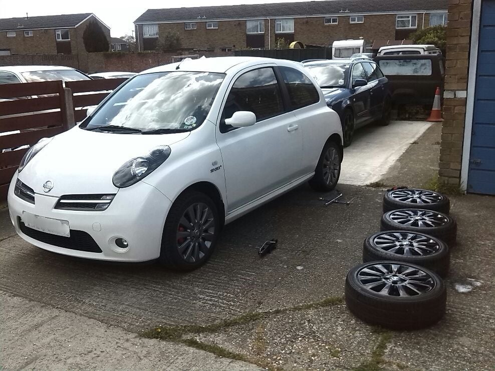

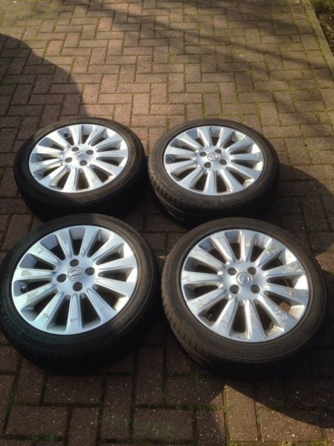

I've cleaned the new wheels *nods enthusiastically* (£104 for a set of 4 off Ebay last week....if you missed it in WDIDT? thread)
...here....I have photos!!! :)
(From the Seller)
Just now...
By the way the 2 at the bottom of the pile there are a pair of my dads wellers :p
...in all honesty...they weren't that dirty :D

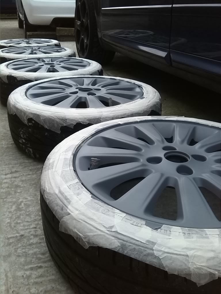

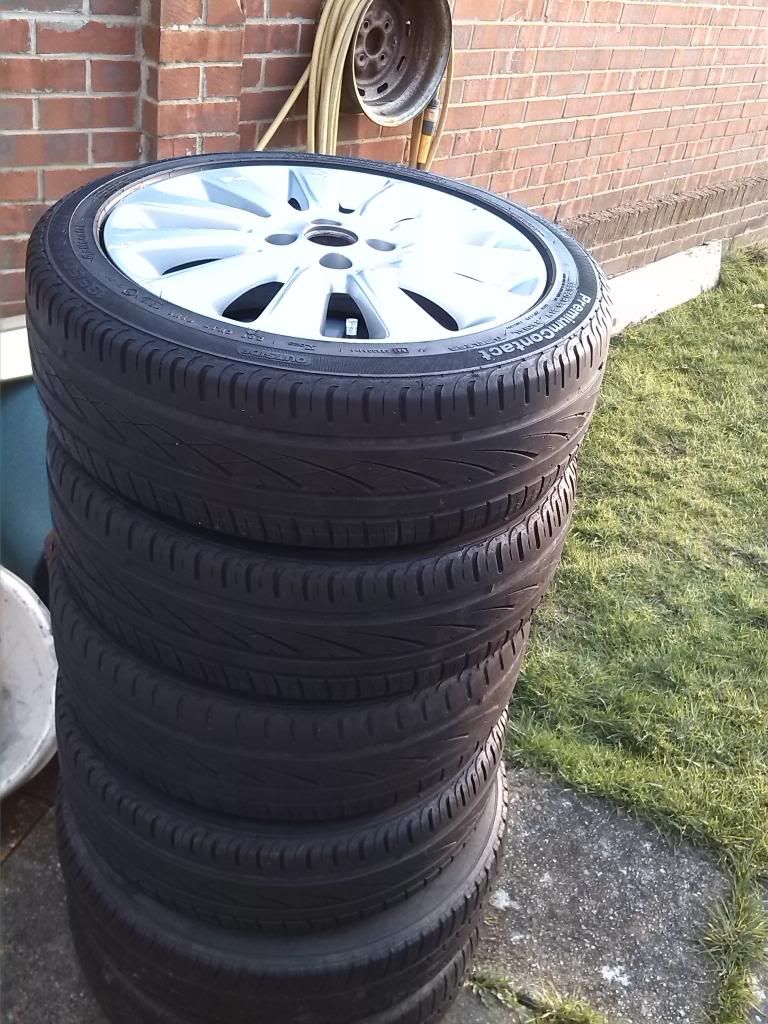

So on March 21st I won the wheels (posted above) off eBay, just £104 for the 4...

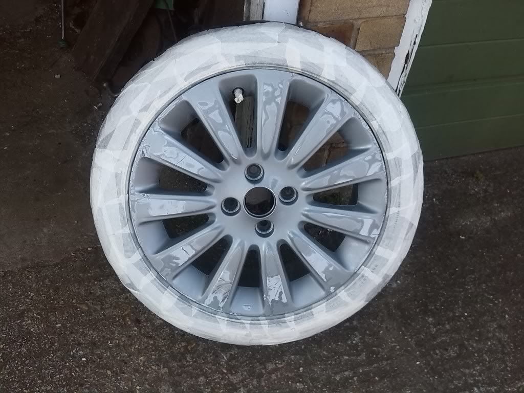

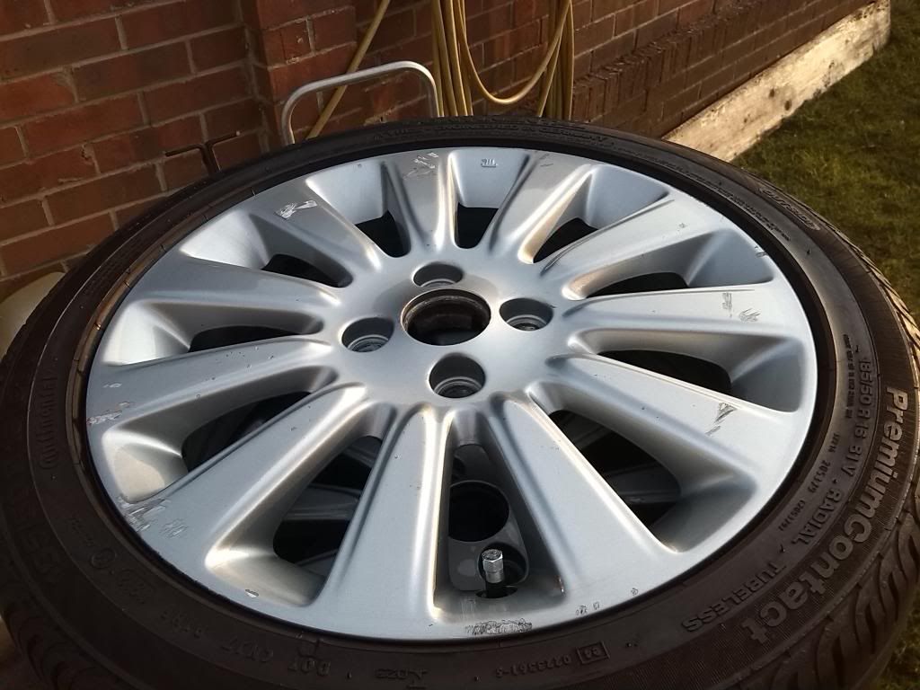

cleaned them up....then on March 27th I began with the rubbing down....

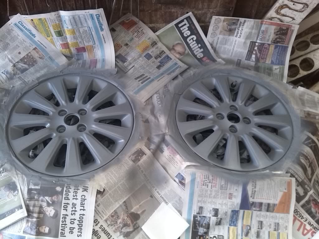

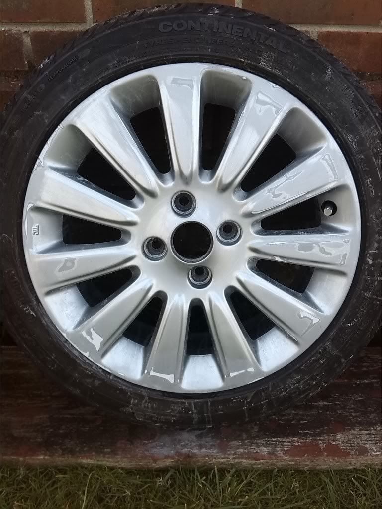

I went over the scuffs and scrapes with 320 grit wet and dry,
then over the whole wheel (to get rid of the lacquer layer and key the paint) with 150 grit.

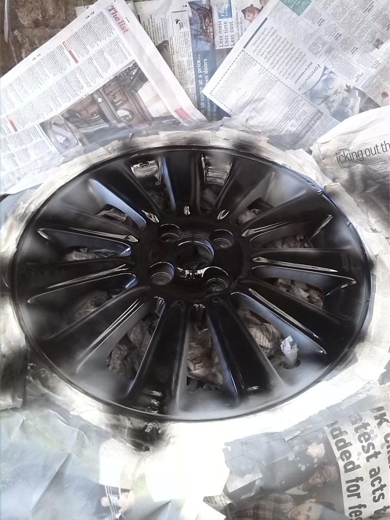

March 31st Got the primer on....

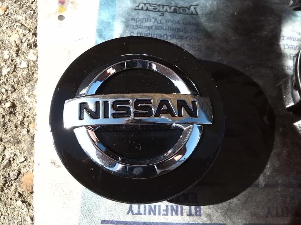

April 1st did the centre caps...which I'd forgotten *facepalm*

flatted back (with 1200).....and got with the Gloss black paint ^_^

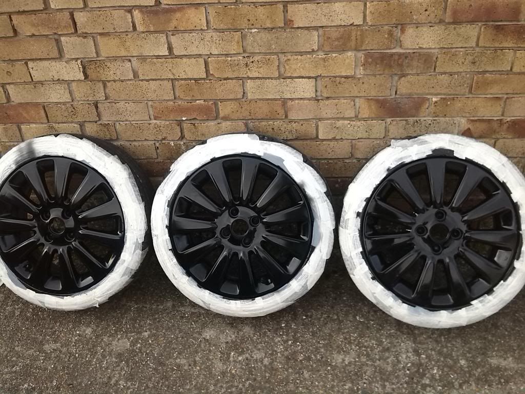

April 4th flatted back the black (1200 again)...then attacked them with Layers of Lacquer :D
http://i189.photobucket.com/albums/z110/Sai_art/Car2/IMG_20140404_151101_zps342a46ae.jpg
http://i189.photobucket.com/albums/z110/Sai_art/Car2/IMG_20140404_171710_zps5c74cfed.jpg
SHIIIINNNNNNYYYYYYYYY http://i189.photobucket.com/albums/z110/Sai_art/Car2/IMG_20140404_171756_zps5fdb3000.jpg
Left a whole week, then took off the masking tape and polished them gently...

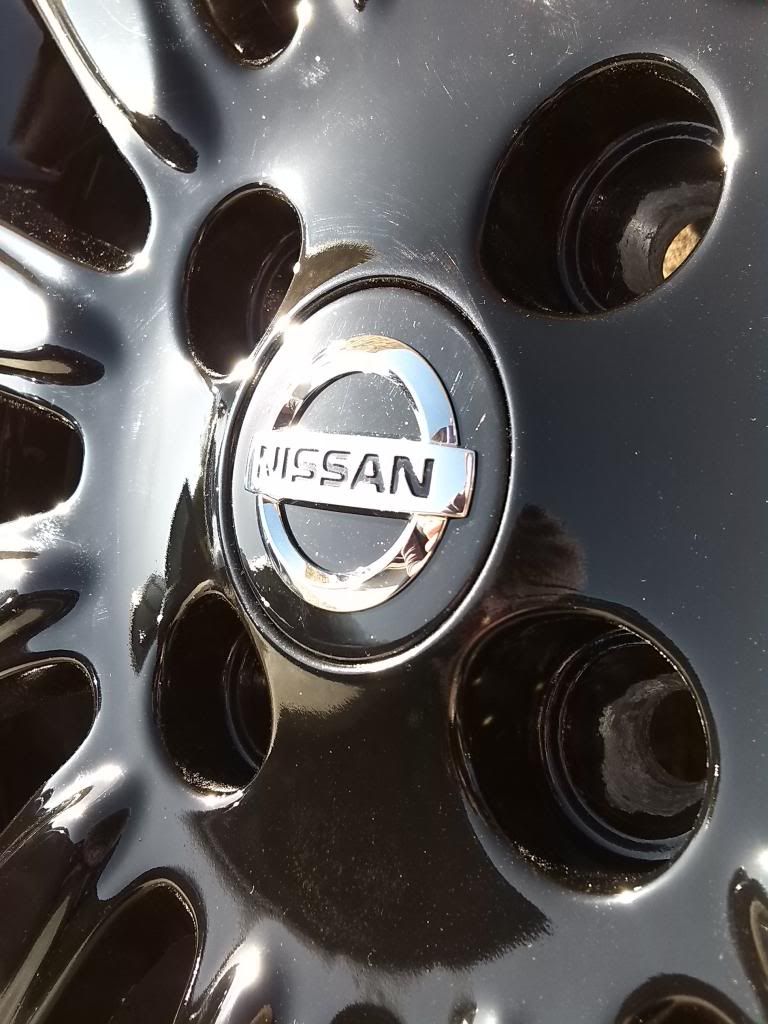

Put the chrome badge back into the centre caps
http://i189.photobucket.com/albums/z110/Sai_art/Car2/IMG_20140413_162002_zpsb98b3c9a.jpg

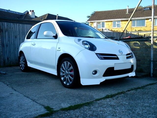

...left them another week...until today.....FITTED!!! ;)
Before:
After:
....Exclusive photos taken with the new posh camera to follow ;)

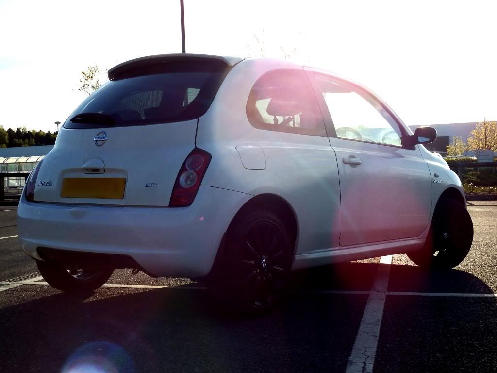

This, by the way, was not the originally intended photoshoot location...but it did the trick ^_^
(I wanted to get a shot from the top of Portsdown hill, but it being the holidays and a friday, the viewing spots, laybys, carparks, were a bit full
.....and the Fort Nelson car park was shut <_<)
Genuine Lens flare!!!! :p
Wheels look fab Jen! Btw, you have lovely hands except for that pic where they're minging and your nails are full of oil :D.
