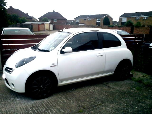

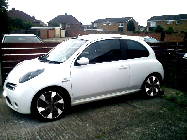

The car
a selection of photo's by the seller (late 2009)
2005 (55)
3-door
K12 Sport+
1.5 Dci (82) 1461cc
Nissan Arctic White (326)
119g CO2/Km (Band C, £30 Road Fund Licence)
Easily achieving 65MPG
I bought her from a Trade seller *shudders* in Poynton, near stockport in Cheshire
Part exchanged my 1997 (p-reg) White K11...for £600 off the almost £5000 price tag
...this was almost 4 years ago remember
She was actually advertised as having the 86hp engine, which would have been Tax band D, so I nearly didn't bother with her :O
...thank goodness for "My car check", eh?
..The earliest photo I have as the owner was taken in April 2010.
Latest Photo: 3rd August 2013
New photo: 19th April 2014

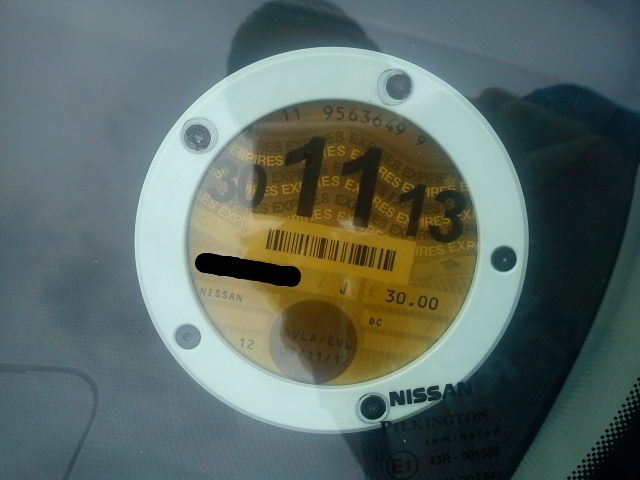

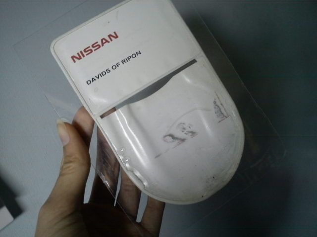

First Job was to change the skanky (Original Nissan) stick on Tax disc holder for a sexy alloy one...Glossy White, to match the car of course
I picked it up at Halfords for £12...well she was the newest, shiniest, car anyone in my family had ever had, she deserved the best.
I carefully peeled off the old plastic holder and stuck it onto a piece of plastic I had lying around, I still have it in my cars folder of stuff (where I keep the V5, MOT and insurance stuff)
Using Methalated spirit I cleaned the area of the window thoroughly.
Putting the new one on the window, I cheated... :p
I opened up the back, put in the tax disk and then screwed the back on again, before putting the little glue dots on the front of the Alloy holder and pressing it firmly into place, holding it there for a minute or so...
...still holding strong nearly 4 years later ;)

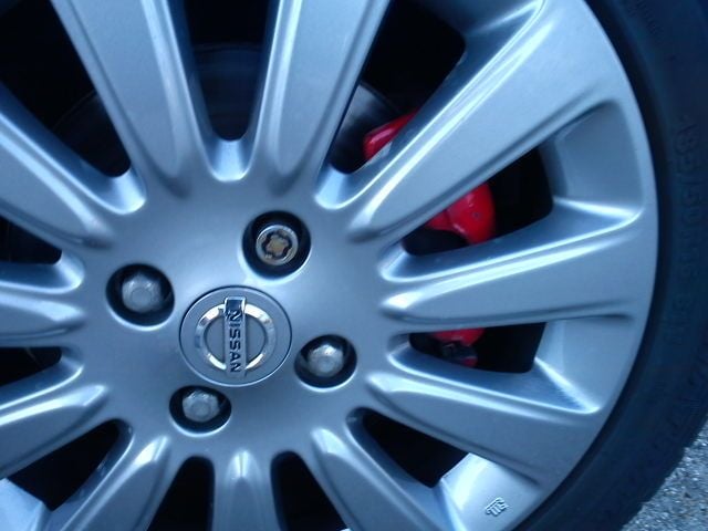

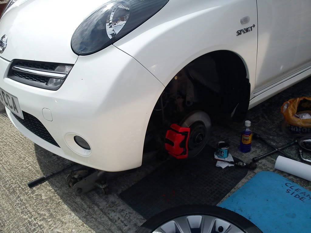

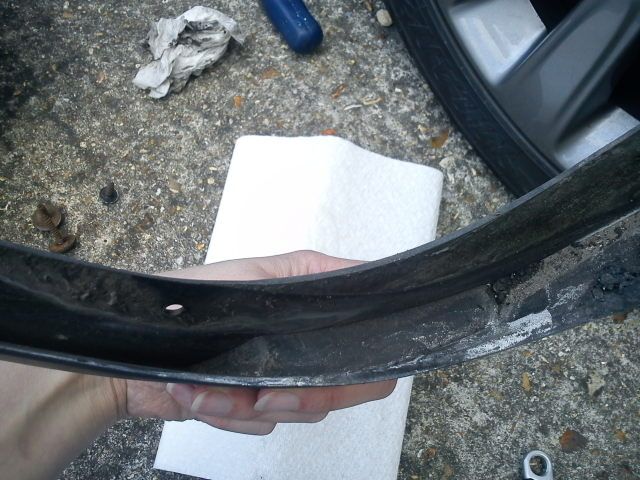

Of course not long after the first picture was taken I painted the Brake Callipers red, of course,
I took off the wheels...scrubbed the calliper with a wire brush and cleaned it thoroughly of brake dust and grime...
Using Halfords own Calliper paint, and a fine bristle brush, I carefully painted the callipers. It took two coats to get a really good density of colour and lovely glossy shine.
This I have pictures of :p

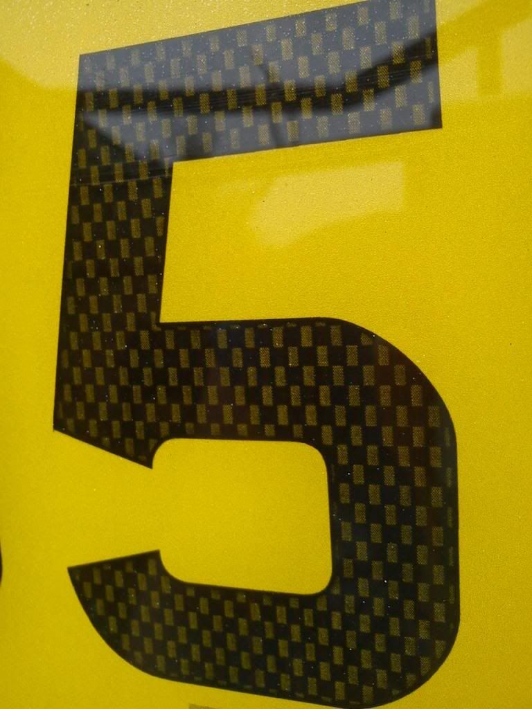

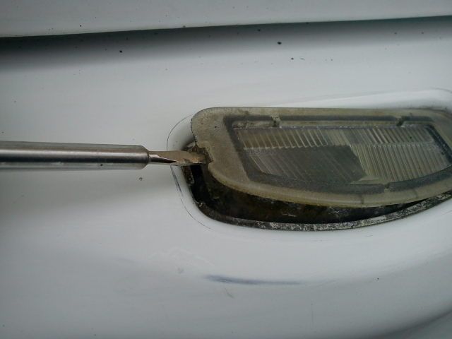

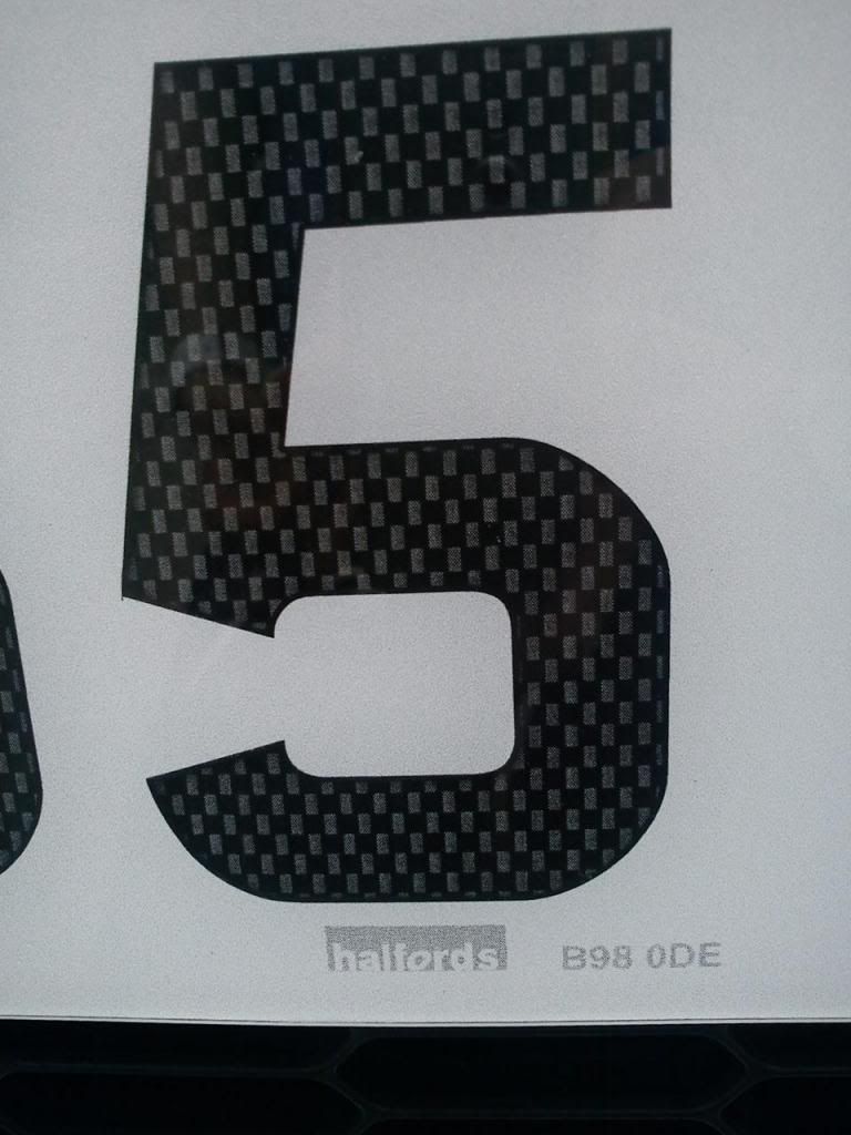

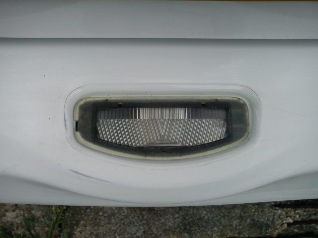

Another thing I did shortly after I got her home was order a set of Number plates with Carbon effect lettering...again from Halfords...they had to be sent off for, so took about a week to arrive...took another year before they were on the car *facepalm*
ETA:

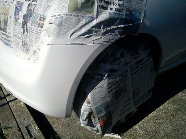

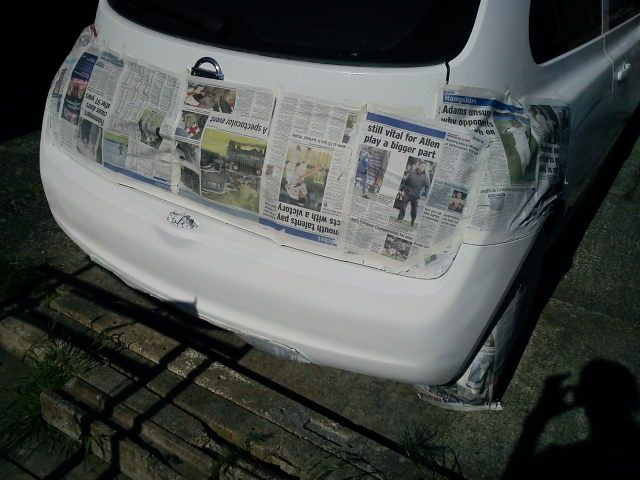

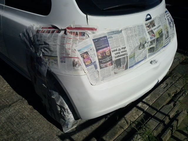

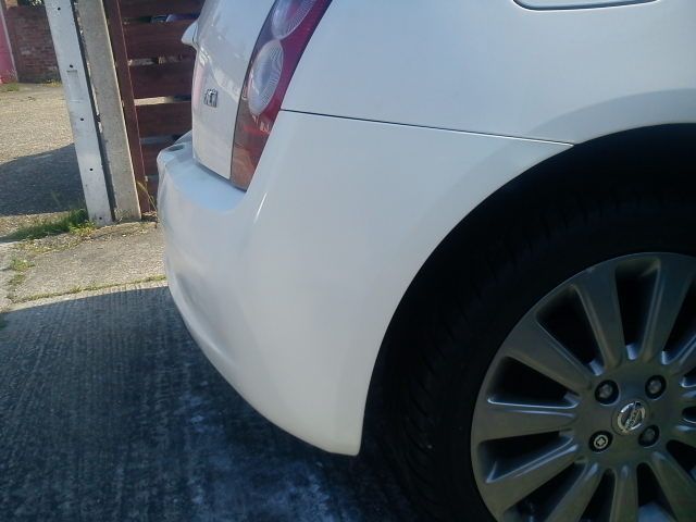

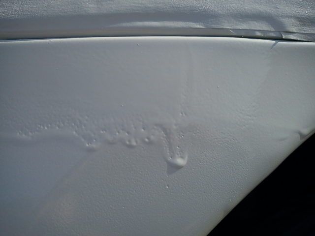

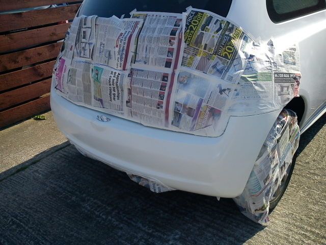

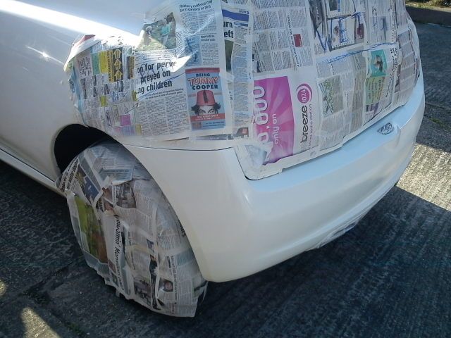

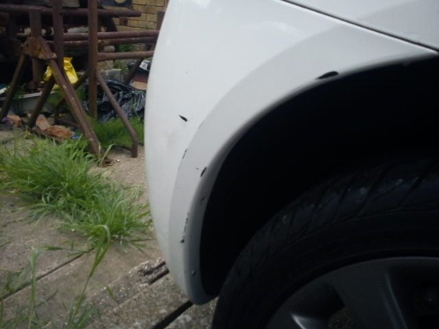

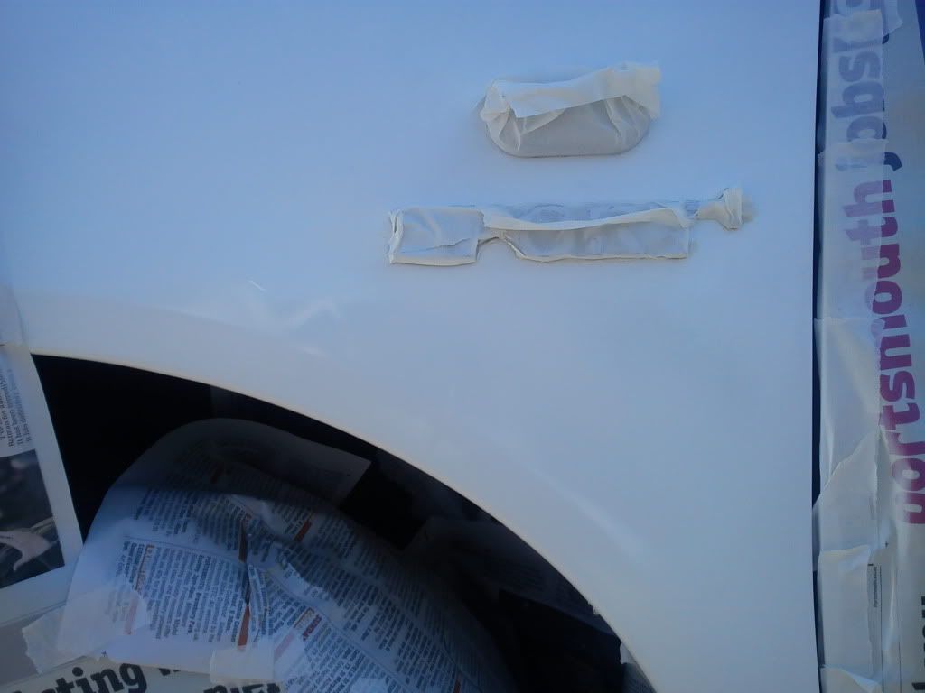

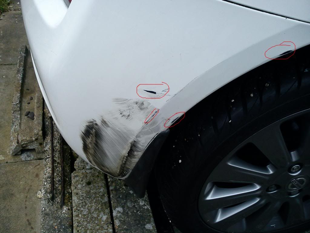

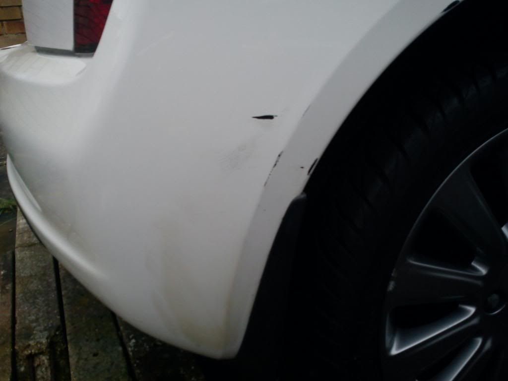

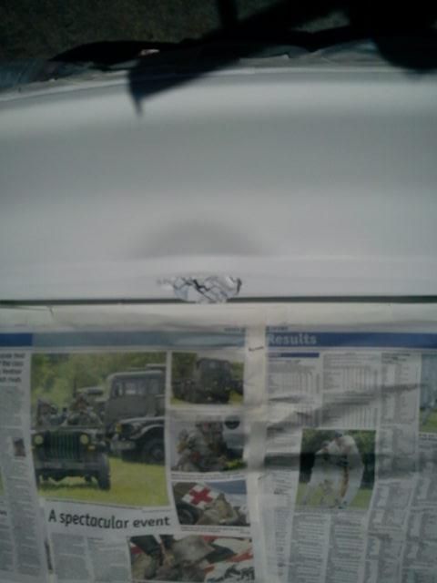

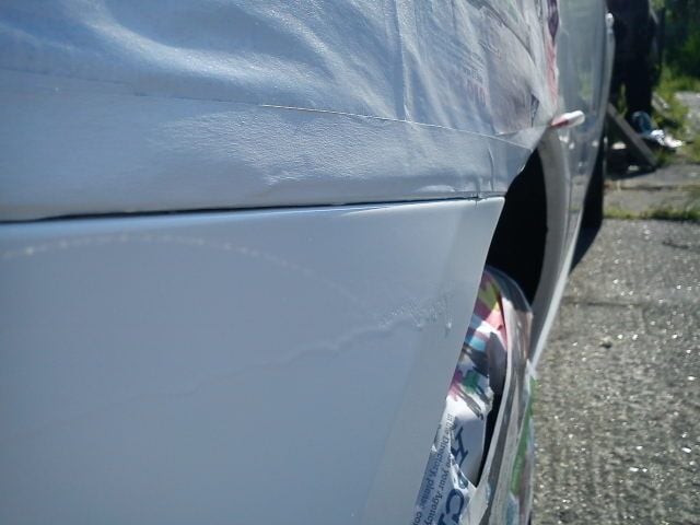

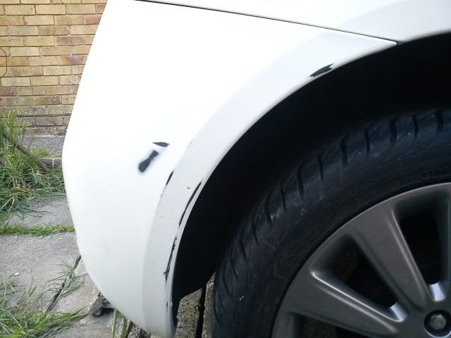

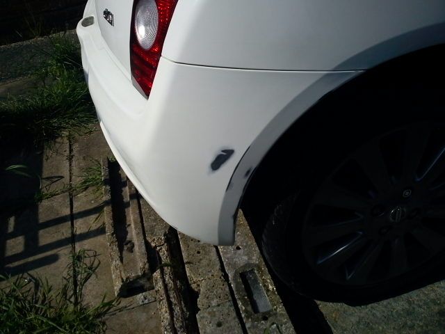

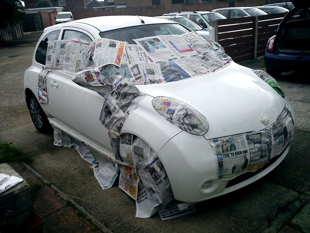

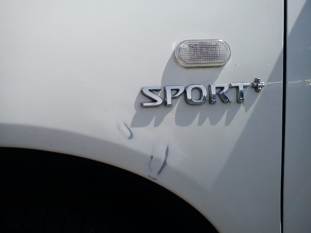

For some reason...I got it in my head that I could sort out all the many chips and scratches in the paint...I never got any "before" photo's as when I started "fixing" (ruining) my paint I had never even heard of the MSC :oops:
any way...I got a paint chip repair kit...and went at it...unfortunatly by the time I'd finished cleaning, rubbing, priming and painting all areas of the car with this kit, it was painfully apparent that I didn't have a clue what I was doing :(
so after a while...I tried again...this time with spray cans #suckerforpunishment LOL
EG:
...not only did I not really wet and dry back properly between layers...I didn't use enough paint, so didn't get the coverage I needed
that and I'm pretty sure that my car was in a vinyl wrap for the first 4 years of it's life (ex-estate agents car) and has possibly been "mopped" so the paint I have is super thin and discoloured (cream..ish instead of crisp white) so the bit I ahven't attacked are still not the right colour anyway <_<
so she is now, pretty much, 50 shades of white *facepalm*

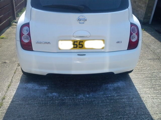

My dad helped me double check the placement of my new number plates...but I put the sticky tape on and stuck 'em down

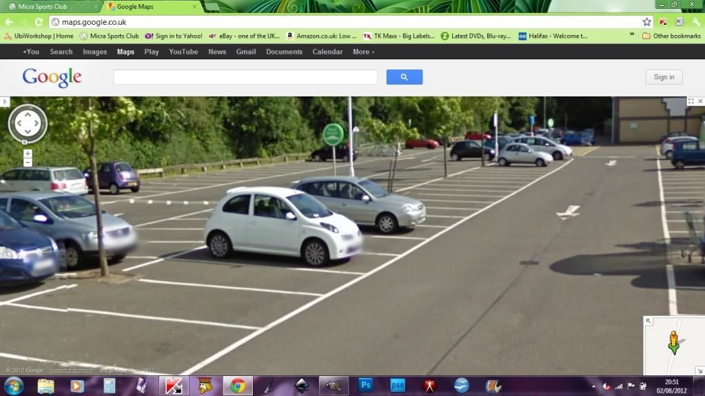

I joined this site....and I found my baby on Google maps LOL
>>>My first post

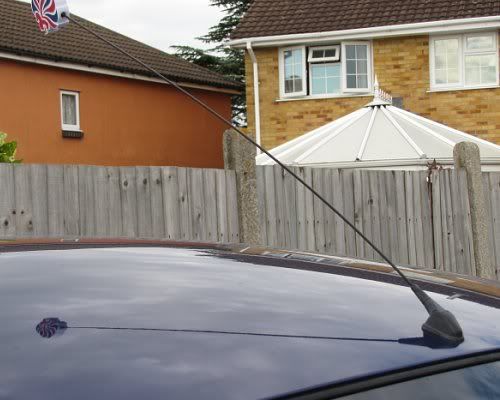

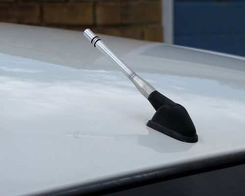

ETA: I also changed my aerial from the original one...that used to hit the roof when I went over rough ground...to a lovely little sliver bee sting style one... 83p +vat ;)
Original, as on my mums SVE
Shiny new one

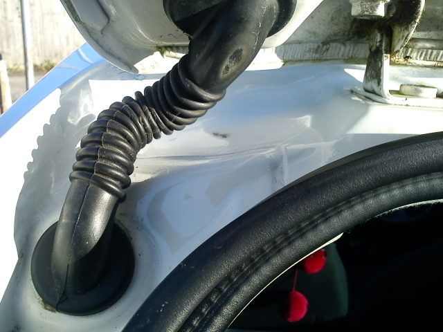

After I'd had it sorted I spoke to the technician and they told me that the loom under the passenger seat is identical in the 3 and 5 door models
...of course the 3 door models seats move forward, unlike the 5 door's seats that don't need to
...so this wire is not really long enough... <_<
Now when I need to put something on the back seat I either slide forward the drivers seat or just tilt the passenger one ;)

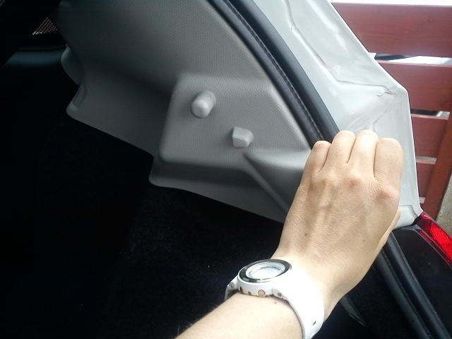

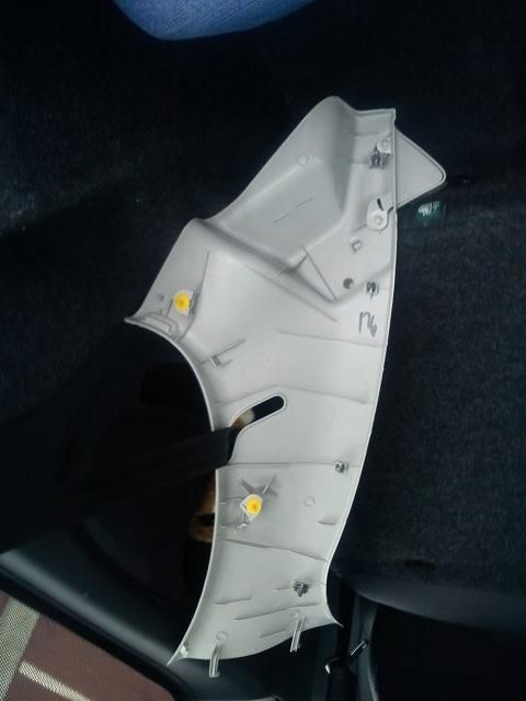

anyway, my c-pillar trims both had nasty scratches in them, as did the boot and the glove box lid has a few too
as I mentioned before my car used to be an estate agents' :rolleyes:
I can only assume they used to shove the big wooden for sale/to let signs in my car, scratching up the plastic <_<

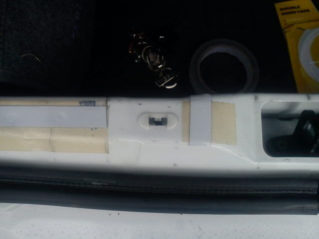

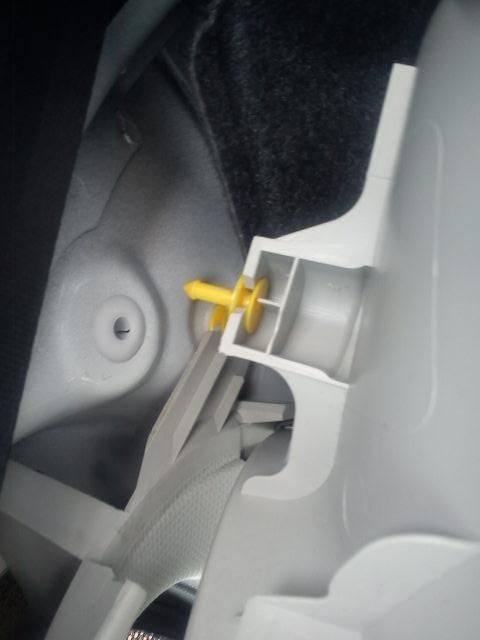

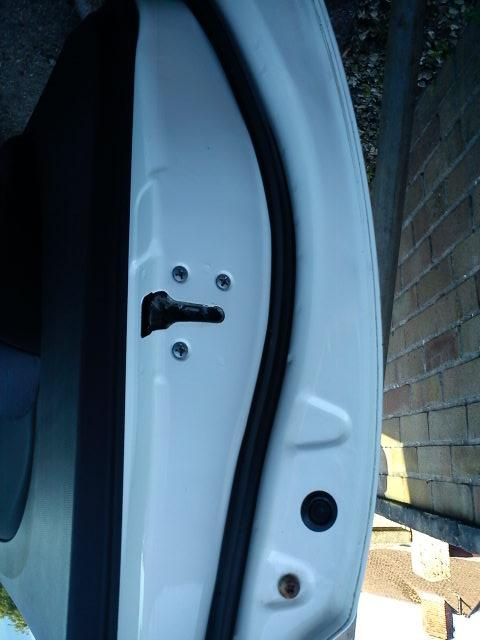

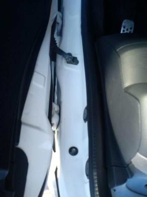

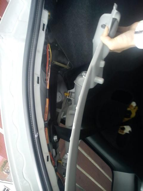

To take off the c-pillar trims open the boot, slide the rear seats forwad as far as they go...undo the bolt holding the end of the seatbelt (folding the seat down can make this easier)
http://i189.photobucket.com/albums/z110/Sai_art/Car/DSC00602_zps38aae023.jpg
using an adjustable spanner is not advised...I tried it...it didn't work use a 17mm spanner
...to get the trim away from the car all you have to do is pull...there are a few locating clips and a few clips that actually hold it in place...it may take quite a tug! ;)
once you've got that panel away, slot the end of the seatbelt though the gap....then fit the new one in reverse
do be careful when re-fitting to line up the connecting clips just right...My dad "Helped" me out when I changed the second trim...and it kept popping out, as one of the locating clips had gotten bent when he'd whacked it into place...

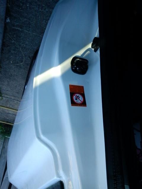

Taking off, and putting on the boot lid trim is very much the same, I did find that a few of the clips may get stuck in the metal instead of the plastic and it's easier if they're in the plastic to line them back up...the just slide in and out of slots in various locations of the panel
http://i189.photobucket.com/albums/z110/Sai_art/Car/DSC00609_zps4e633cd4.jpg
Note: Both the Boot lid trim panel and the c-pillar trims are identical on the 3 and 5 door models ;)

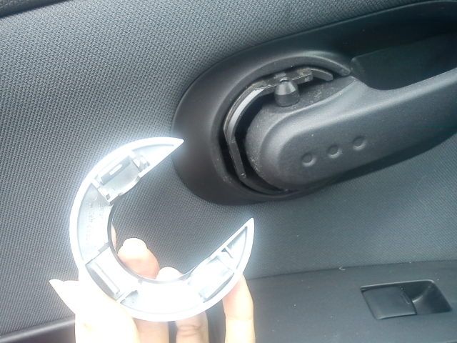

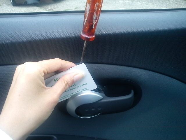

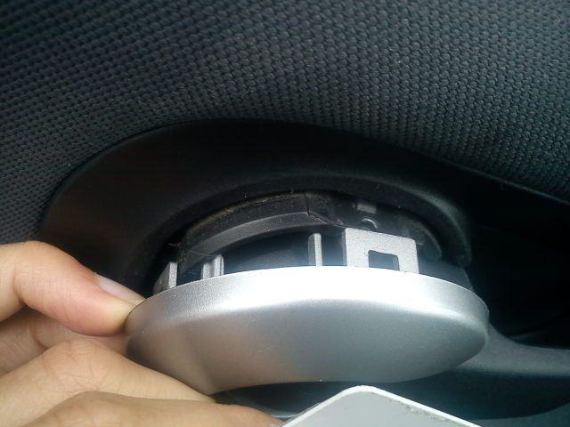

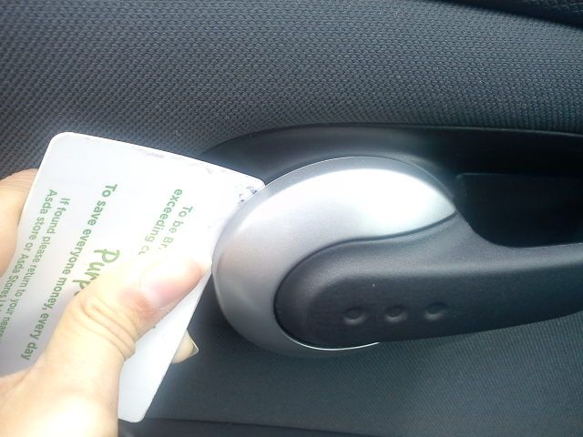

Changing the interior handle trims is also very simple...just ply them away with a flat head screwdriver...although I wish now I'd done this with something like a credit card as removing these trims with a heavy hand easily leaves marks in the plastic <_<
put an old ID or bank card to lever away from the handle, and slot the flat head screw driver behind it...
lever it away...it is very firmly attached...there are 3 bits in slots holding it on
once you've got the top bit out just pull it off, try to pull it straight, although the plastic here inside the trim is quite tough and should'nt break
To put the new trim on just press it into place, doesn't take even half the effort of removal :p

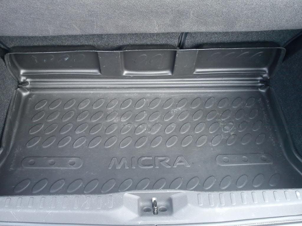

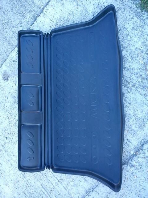

Genuine Nissan Blinds (ignore the boot liner...I'll get to that next ;) )

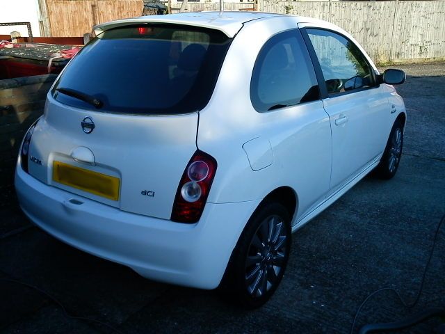

Fitting the rear hatch window blind is very simple, it just slots into place (as the plastic surrounding trim is not as close to the metal as the rear side windows are to the glass :rolleyes:
Before:
After:
Exterior view...full effect...
Before: http://i189.photobucket.com/albums/z110/Sai_art/Car/DSC00607_zpsd7cff904.jpg
After: http://i189.photobucket.com/albums/z110/Sai_art/Car/DSC00614_zps48542aac.jpg
from the inside: http://i189.photobucket.com/albums/z110/Sai_art/Car/DSC00616_zps851386da.jpg
it doesn't stop too much light getting into the car and is still fine, vision wise, when driving at night.

reminds me actually...on the MOT in 2009 my front O/S tyre was an advisory. there's a cut in the tyre wall...more like a massive gouge actually
but it is STILL on the car today...and has not been picked up in the 3 MOT's I've put her through since o_O

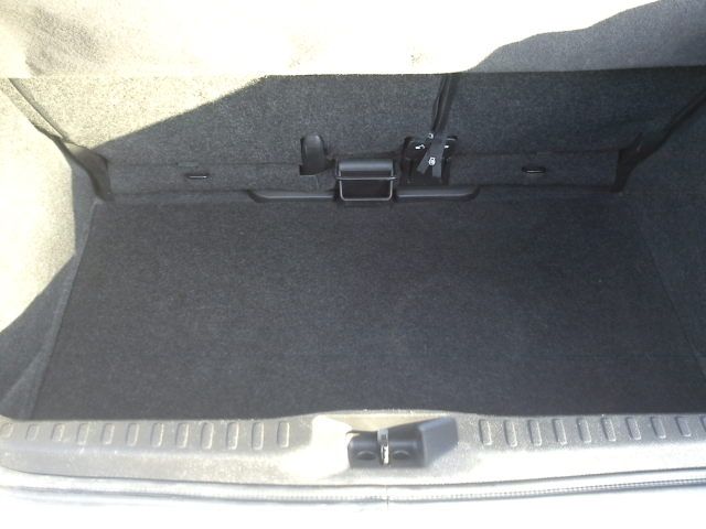

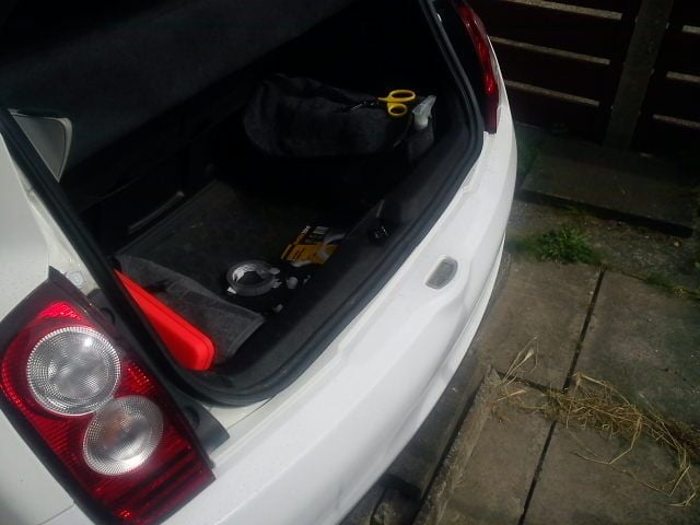

Won a Genuine Nissan Boot liner...cleaned...fitted ^_^
Bye bye JML rug.... (and rubber non-slip mesh, perfectly cut to fit...a K11 boot lol)
...and hello Genuine Nissan Boot liner ^_^
Note to my fellow K12 owners: These genuine boot liners are really nice and robust...good quality plastic, made in Germany, with that Rubberised finish on top
...however they would fit better if you don't have the sliding rear seats as the mechanism pushes the back part forward a bit ;)
....although saying that, with my seats pushed all the way forward it sits almost flat...
The same day in March that I won the Boot liner on Ebay....I had an interview...which I didn't get to because..... :(
I circled the bits where the paint is actually missing (black plastic exposed)..80% is tyre/rubber <_<
I cleaned it up a bit a few days later...
also had to tighten the screws and bolt holding on my mudflap...luckily not cracked or anything like that *phew*
Poilice did nothing and didn't even get my name right in the letter they sent me the day after, telling me they were going to do nothing :mad:
did re-arrange the interview....didn't get the job:rolleyes:

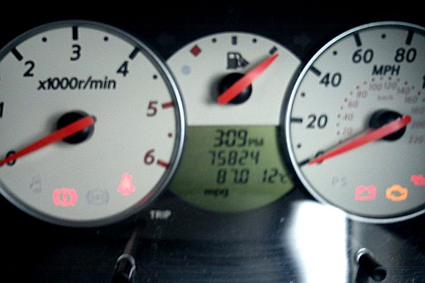

as I had Played the Miles Per Gallon Game with my Trip Computer on the way home from the shops and posted this image ^_^
K12 DCI FTW!! LOL
Haha, I also got a notification you liked one of my posts from may haha.
87.0 MPG
MFW

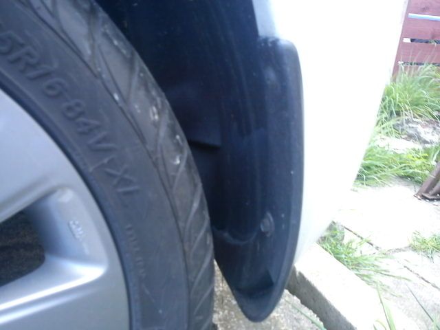

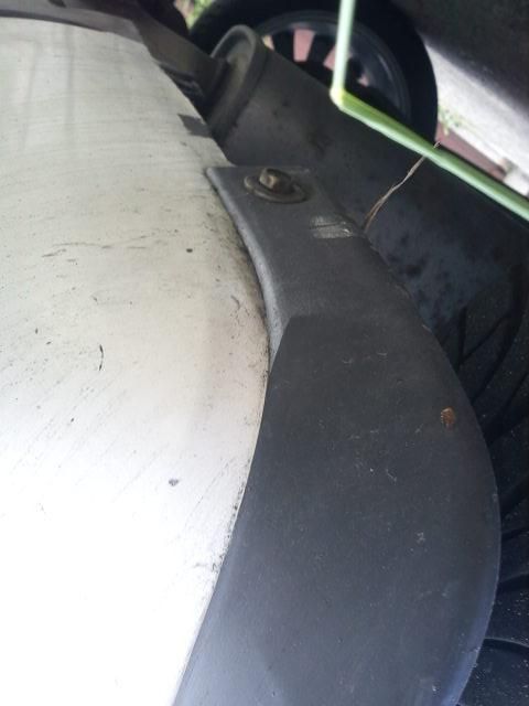

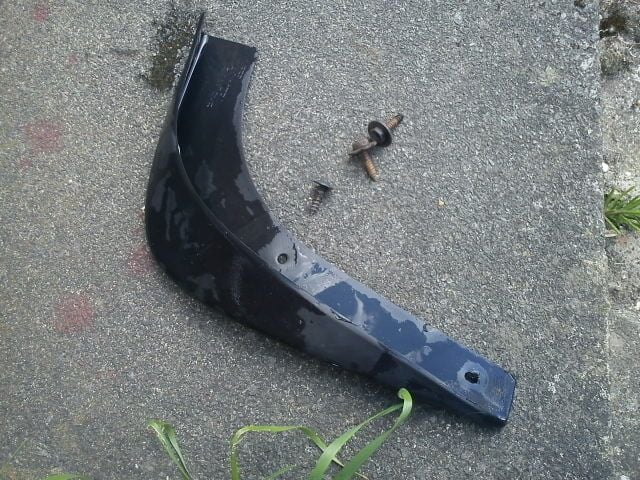

....so I had a look at my bumper, to do the painting part right this time...taking off my mudflaps etc LOL
as looking at the black scratches was getting me down <_<
discovered that I'm missing 2 self tappers one from the trim under the main body and one that holds the centre section of bumper to the car :rolleyes:
gonna have a look in the garage for some later...
Anyway....PICS!!!
screw and self tapper
'nother self tapper underneath
Hmmmm...skanky as :p
...this is what the bit I ruined painted last year
....oh dear... Error (My fault ^_^) http://i189.photobucket.com/albums/z110/Sai_art/Car/DSC00013_zpsa3f920db.jpg
I think it look better with the mudflaps ;)
all cleaned and placed back on car...so I know how piss easy it is to get 'em off now :D
BTW...turns out that K12 mudflaps are very good at collecting mud in the gap between the inner arch trim and the lower self tapper
....and in the moulded grooves of the mudflap itself... :p
May 25 - 29
began preping my rear bumper, finally, for painting as weather was good...
...then it got too bloody windy <_<
sun came out and barely a breeze! ^_^

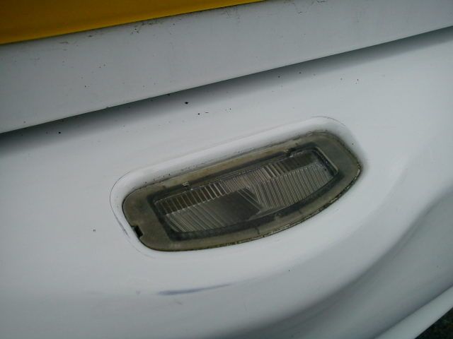

...got all ready to get some bloody paint done... dug out 3 days of newspapers...and my masking tape etc...

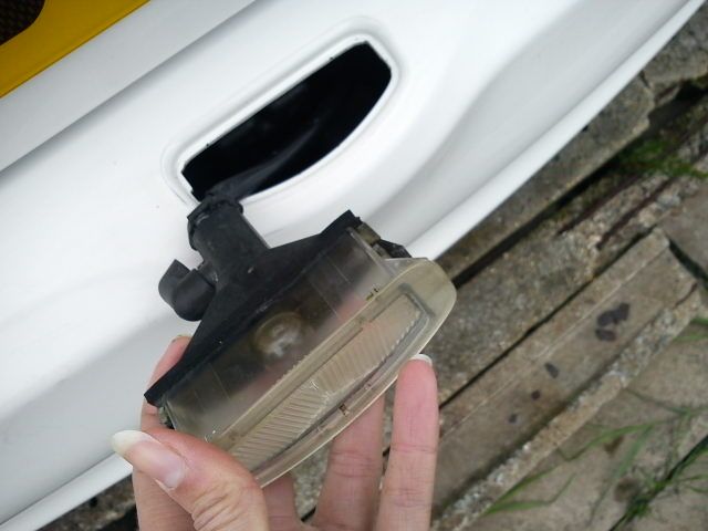

then remembered that I hadn't taken out my number plate light yet....so I needed to get my number plate light out and clean the surround and wrap it up...
Before:
After:
But...then the rain came...again <_< *facepalm*
June 1st
...got my bumper all cleaned, taped/masked off/up and primered ;)
Before:
After:
...it's actually all one kind of white now, instead of "50 shades of..." :p LOL
next step?...get some top coat paint (arctic white 326)
...rub down and apply....

...a couple of weeks ago my mum had her AC sorted by Nissan, and while we were there I asked the parts guy if you can get the black pillar trim off a K12c and fit it to a K12e
...he said it's "bonded" which is code for... pain in the arse and it'll probably break in the process <_<
but.... "we can order you the part in...cost £30.....plus VAT....per side"...ummmm....no thanks :p
Shopping in Lidl on Sunday afternoon...and spotted their "adhesive patterned film"...£1.49 a roll or two for £2.50 ^_^...so I got me some...and had some fun
Before:....
After:...
other shots...
http://i189.photobucket.com/albums/z110/Sai_art/Car/DSC00506a_zpsc442ccbb.jpg
http://i189.photobucket.com/albums/z110/Sai_art/Car/DSC00505a_zps6942700d.jpg
http://i189.photobucket.com/albums/z110/Sai_art/Car/DSC00510a_zps89401973.jpg
http://i189.photobucket.com/albums/z110/Sai_art/Car/DSC00509_zpsaef74e07.jpg
http://i189.photobucket.com/albums/z110/Sai_art/Car/DSC00508_zps32be67f7.jpg
I reckon it looks really nice! ;)
...there is one little bit that went...funny ...but meh :rolleyes:
http://i189.photobucket.com/albums/z110/Sai_art/Car/DSC00507_zps7f0f3b14.jpg
this has now been holding strong for two months through rain and shine....Highly recommended ^_^

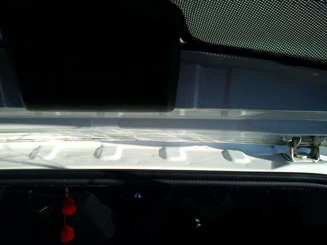

I thought I'd fix the bane of any K12 owners existence <_<
The stupid, annoying, magically escaping, pain in my backside, plastic tailgate trim LOL
It seems that no matter how gentle you are with it, the minute you need to lift something outta your boot it gets snagged, even ever so lightly, on this trim and it comes Flying off!!! >_<
this is because half of the fixings that it's supposed to "clip" into are missing, damaged or both :rolleyes: and unlike the other trims around the car you can't really replace them as they'll just break again so...I made with the extra strong double sided sticky tape! :D
Bargain from Aldi's that stuff...my mums number plate was falling off, this stuff holds it solid and was half the price of proper "Number plate tape" from Halfords ;)
Obviously I attacked the trim with back to black (wonder wheels) first.
...which it turns out you shouldn't do in the kitchen, as it polished the floor at the same time = slippery as......with just socks on :p
http://i189.photobucket.com/albums/z110/Sai_art/Car/DSC00553_zpsb7a5d198.jpg
Not long after I got my baby I did try to sort this out...using carpet tape
however, carpet tape is simply not thick enough to reach the trim I'm trying to stop sepperating from the metal
http://i189.photobucket.com/albums/z110/Sai_art/Car/DSC00557_zpsf256cdb0.jpg
http://i189.photobucket.com/albums/z110/Sai_art/Car/DSC00558_zps251c1c6a.jpg
now... I put on a few strips of the new, padded (foam), tape, it's about 1mm thick.
The placement was perfect but it still wasn't actually holding onto/touching the trim enough
...so I put a second layer on top of the strips I'd already put on it and pushed the panel into place, holding it down for a few seconds....then I gave it a nice, firm, tug.
didn't budge an inch :)
...YAY!!!! much better ^_^
the only thing that I think would make it more perfect is I think it could have done with a third layer of the tape in the area towards the catch in the centre, but it's pretty solid anyhow...
In the event I need to remove tha bit of trim again I'm gonna have alot of fun! LOL

although I've done a mock up like this before, I was bidding on some wheels and thought I'd have another go...
Then...., after discovering those wheels I was winning were "No longer available" <_< ,
I did a mock up of my car with those shmexy Nissan Note alloys, Hence Scotts (skymera) post earlier :p
I'm still thinkin' it will be easier/cheaper to just paint the wheels I already have, but I'd like to have another spare of each colour...if you know what I mean....
So I'd also need 5 of the Note wheels to be happy anyway LOL
If/When I paint my wheels, I probably won't go as dark as black (in the mock up) more like....very dark grey...Anthracite or gun metal :D

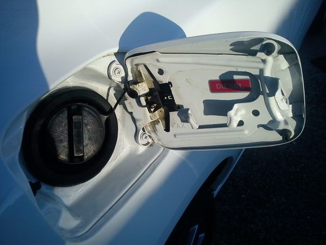

also cleaned off as much of that horrid green gunk from the door jams and hatch lid etc....and gave those parts a good polish...
and the fuel filler flap for good measure ^_^
