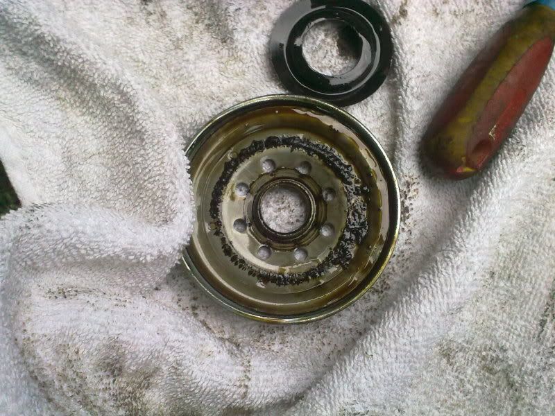

So I got up this morning only an hour ago, because we got off the boat at Dublin port at 6am, had a bite to eat and went out to the st to check its levels pulled out the dipstick and it had a layer of caked (rock hard) on sludge on it:eek:

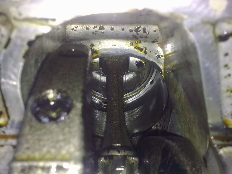

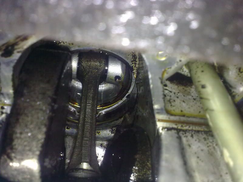

Pulled of the oil cap and it usually spotless and you can see the rockers but this time they were black with crap. So cleaned off the dipstick and rechecked the oil level,it was fine the oil was a dark golden colour which would indicate to me it was ok.
So started the engine up and heard a strange whine and screeching noise ,oil light stayed on and no pressure on the oil pressuse gauge, so switched it off
I reckon the oil pump shat itself, all I'll say is at least it got me home(Y)

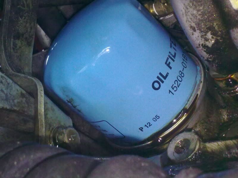

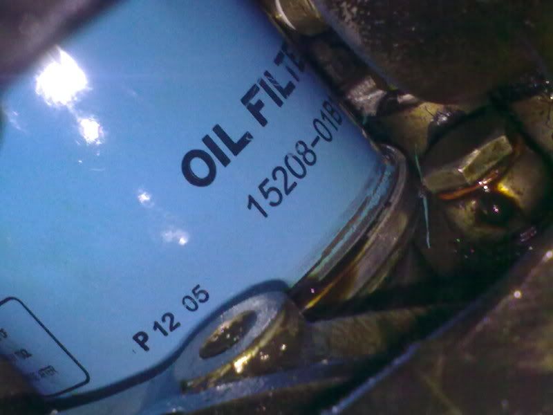

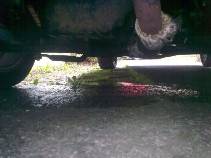

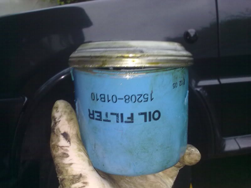

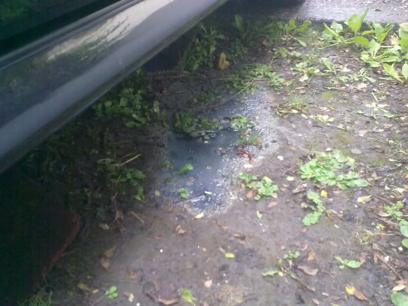

Anyway might be ok but by the looks of things the oil filter split at the seams and when i fired it up this morning it emptied the sump!!
Some sludge in the filter housing and the filter element seemed very brittle and seemed blocked:eek:

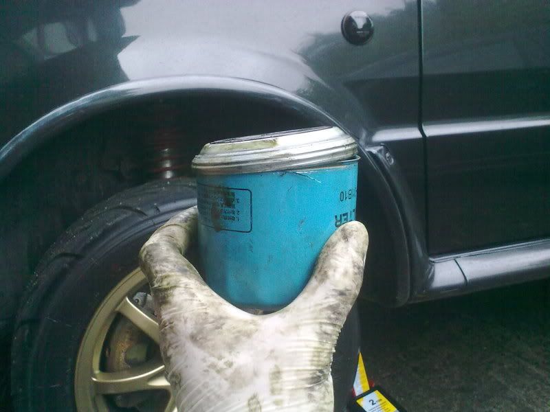

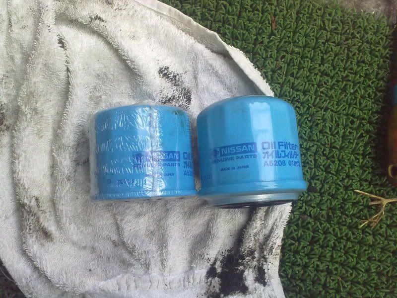

Well just put a genuine filter and fresh oil in and tried to fire it up and it was hard to start, then I heard a bang the oil filter split open again
:eek: wow baz, you must have about 100+ psi there !

This what it did to the filter the one on the left is a brand nissan filter and the other one is the one I put on yesterday with fresh oil

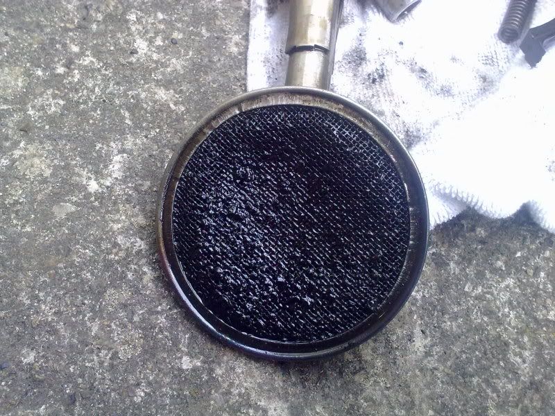

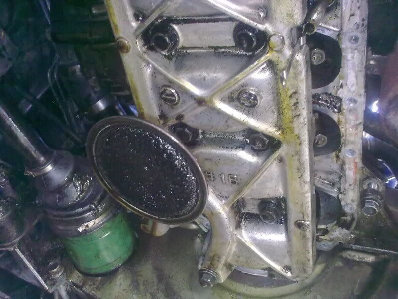

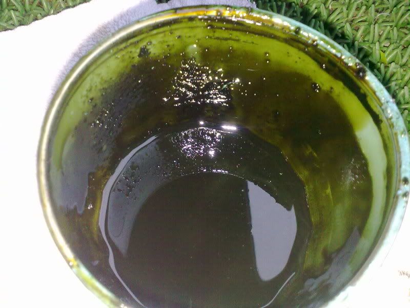

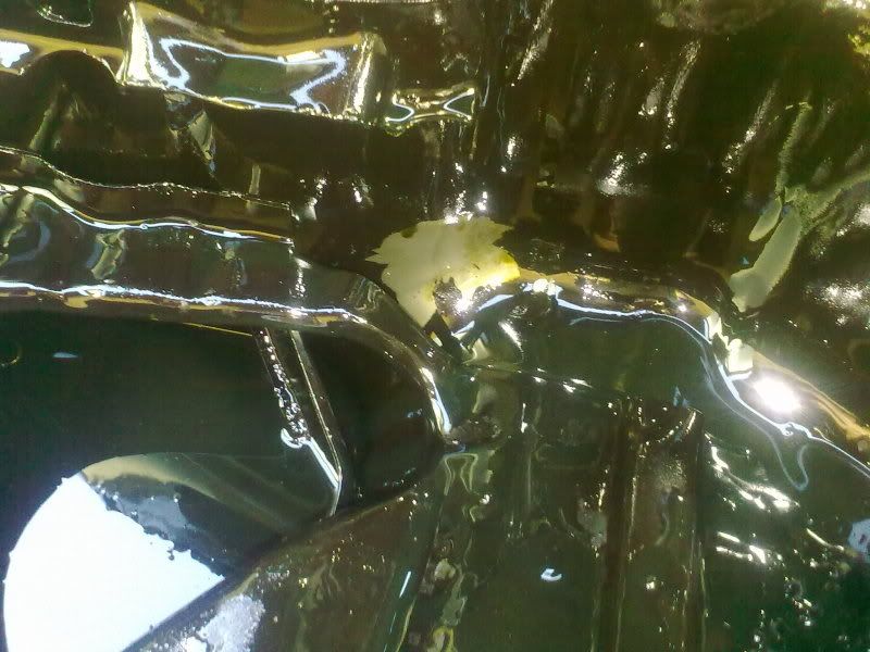

I took down the sump today and the thing is full of crap, only can be described as muck and gravel ,NOT SLUDGE as the car is too well looked after
The oil pick up is near blocked and the pressure relief valve on the pump is jammed shut and the pump itself is hard to turn and the face off it is all scored
Bit of paint gone from inside the sump
