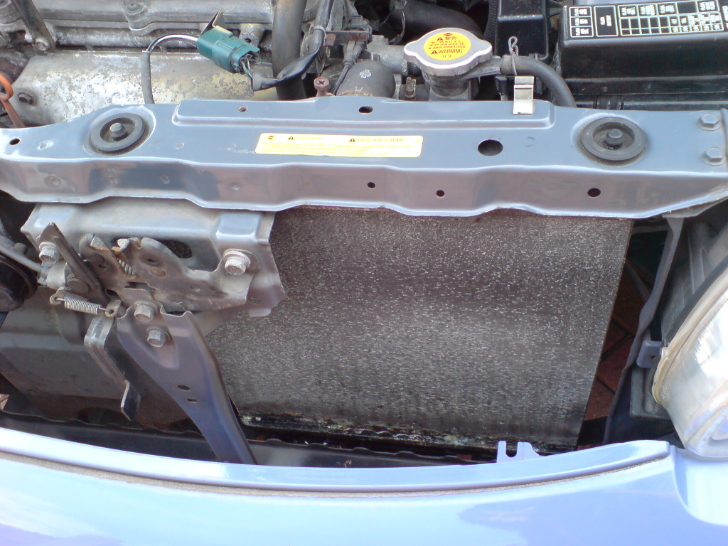

My radiator is the original one that came factory installed in the car (2001 1.0 Y plate). The bottom tank is rotten (see photo below...)
..so I need to swap it out with a new one. Are there any fitting guides here? It looks like I have to remove the slam panel which has 2 bolts on either side and it looks like the right side of the slam has some sealer on it for some reason, I guess I'll have to re-apply that when I've finished. There's two round bolts or studs through the slam with rubber grommets around them holding the radiator in? I'm not sure what they are or how to get them off? other than that there's the electrical connector for the fan and water pipes at the top and bottom held on with jubilee clips and a pipe going to the filler cap held on with some sort of twist on connector. Is that about all?
you take the 4 x 10mm bolts out the top and 2 x 12mm from the brace in the middle and then just lift the slam panel off tezz :)

great thanks, forgive my ignorance... the brace is the vertical support seen in the photo bolted onto the bonnet catch? I take it the catch mechanism will come out too attached to the slam?

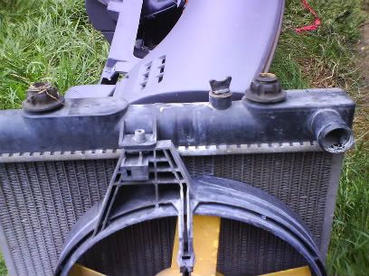

Are those bolts through the slam that hold the tank in place perm attached to the slam and just sit through holes in the top of the tank when the slam is refitted?
Take the rubber surrounds out at the top, it'll make it easier to remove the radiator (it's not actually bolted in at the top at all)

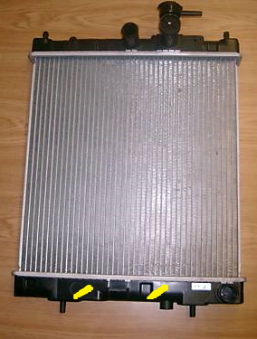

The new rad had two copper connectors on the bottom tank which weren't on the original one? I suppose they are for an a/c or something? The connectors seem to have a hole through the center so I thought maybe they had sent the wrong type and the coolant would just pour straight out so I put some tap water in the rad before I installed it to test and it only came out of the bottom drain hole on the tank where it should do although I didn't fill it much to test it so I'm still a bit unsure that it'll be ok.. I wanted to get the change done quickly as it looked likely to rain again today which it didn't in the end. I've not filled the coolant yet now that it's all installed in the car because I need to order some new in the morning. I hopefully won't get a wet driveway again when I fill it tomorrow.
I should have taken a photo before I installed it really. I've tried to do a quick mock picture to illustrate it instead. Hopefully I've draw it on the correct side of the radiator!
It's basically two brass coloured connectors sticking out of the bottom tank.. Apologies for the crude drawing :grinning:
On the Auto micra i looked at before there was a seperate chamber attached to the bottom (iirc) of the rad, with smaller connectors. Seems to be used as an oil cooler.
Possible you've got a similar radiator setup? :)
Not sure if the chamber was a small as you've marked it though...but then you're not using any measurements :D

Great thanks for that, my other thought was possibly an attachment for an oil cooler. I had an Astra van a while back an the oil cooler was inside the front bumper.
