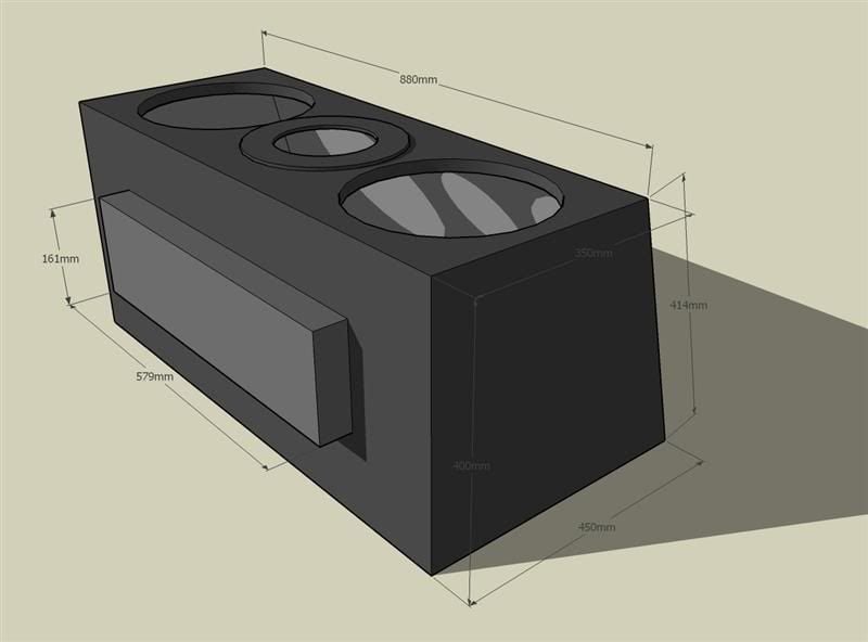

Righty, my subwoofer box design is now complete, with a port tuning frequency of 32Hz, hurrah! My boots going to be full of marine ply.....oops!
I've decided to change the box design and go with one large 6" aeroport and a sloped back...

Well, not quite. The birch ply has arrived, the aeroport is arriving on Monday and my amp is all ready to fit on the box like so....

Box will be 4.8cuft after port and sub displacement, the JBL's like anything from 2-2.5cuft each, so it should be about ideal.
It'll be tuned to 30Hz as I want this box to drop!
