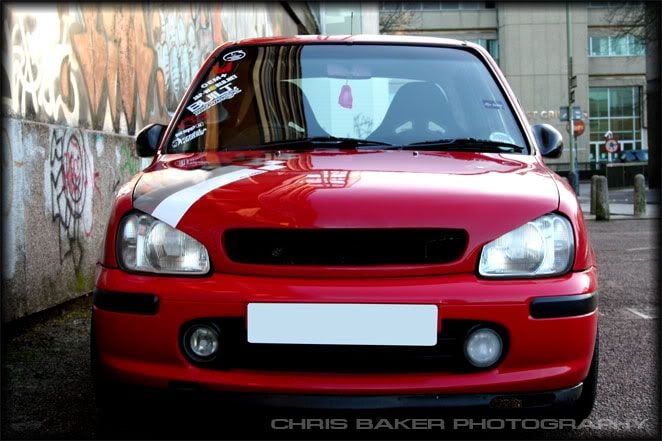

Went for a random drive last night for some pics,K6PFS may recognize this location :p

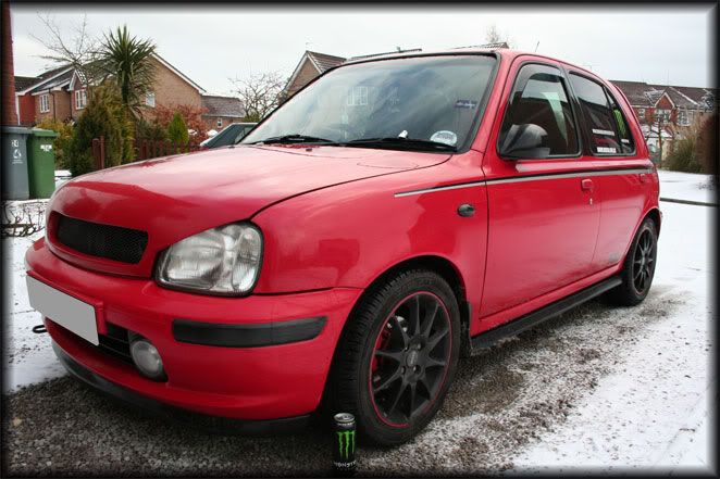

Very nice car good work (Y) Can i just ask after looking through your blog, where did you get the smoked headlights from, i have hunted high and low for some of these and havent got a clue where to get them from? :grinning:
I smoked the headlights my self :) I used a heat gun to heat the adhesive,prised the glass apart using a couple of flat head screw drivers. Removed the 2 small screws holding the reflector on.
Rubbed down the chrome,and used High Temp Paint to paint it black. Then reversed the steps to put it back together :)
Very impressed(Y), but can you actuly buy them already like that or? Cause i think it was Squarepants blog he had lights like that aswell? :grinning:
na bernie you have to do them ya self or buy some for tiawan but they are dif i would just do them ya self it aint that hard chuck

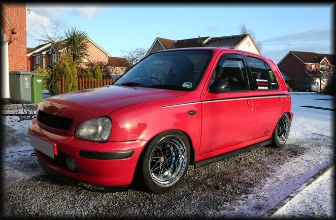

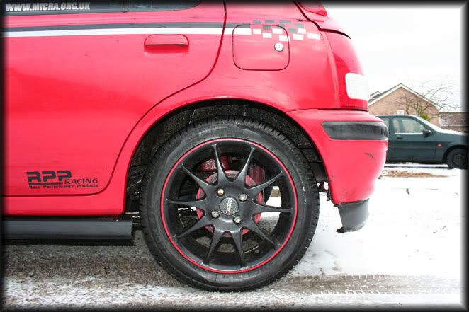

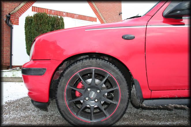

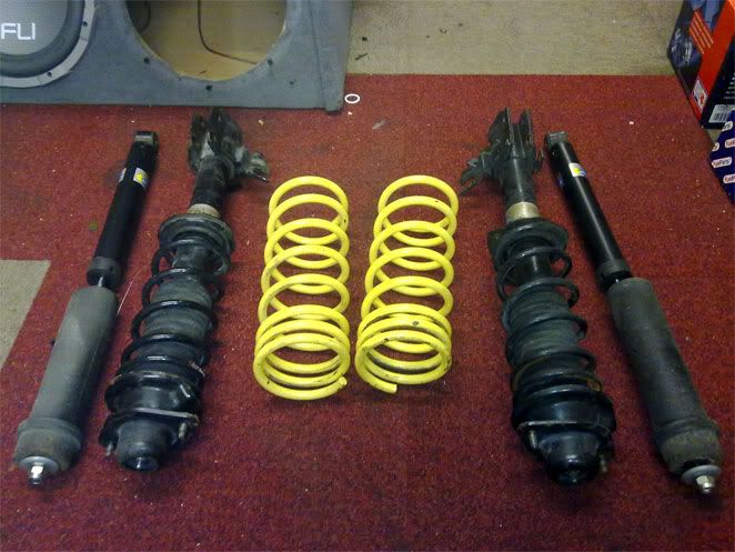

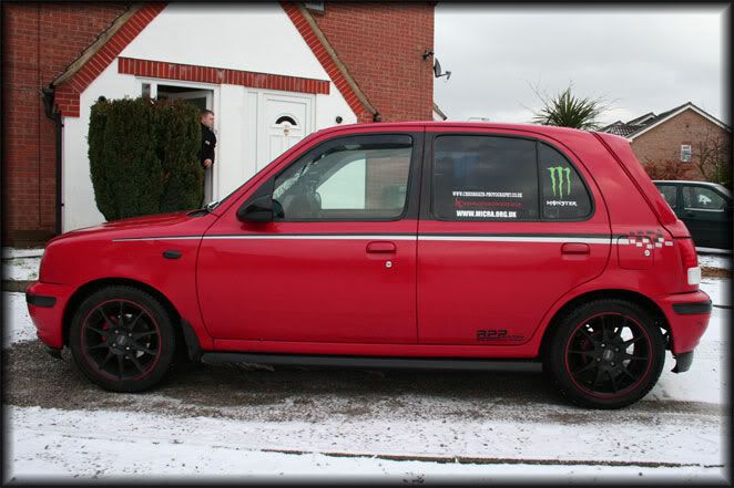

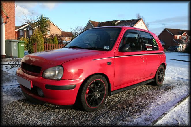

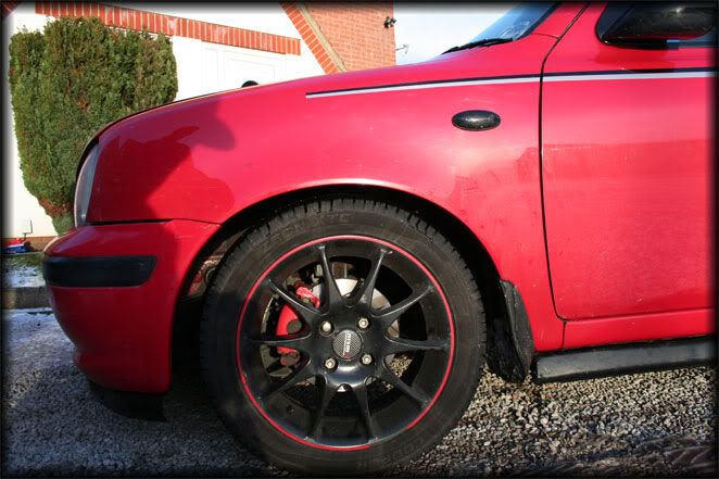

Got the Suspension fitted early which was a bonus! Obviously it'll need time to settle,but you can kinda see a difference in these pics. Pics will be Before and After :)
My cousin fitted it for me :)

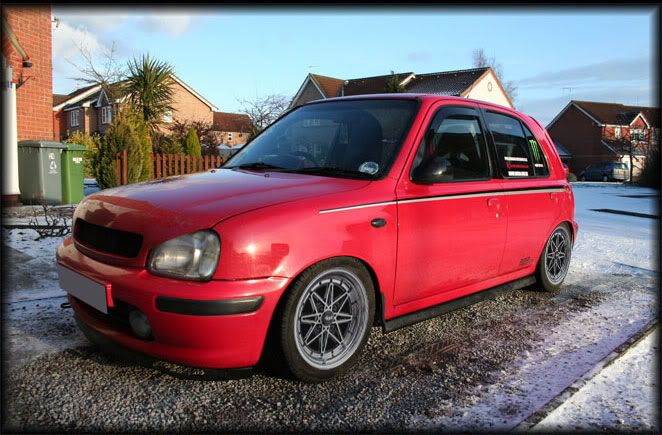

they're polished...not grey btw. But i dulled them down to make the p'shop more realistic. Heres another pic of the original wheel (different source though)
