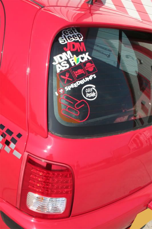

Heres a pic of my back window,added a couple more stickers:
Thats about it for now :)
i like those stickers :D

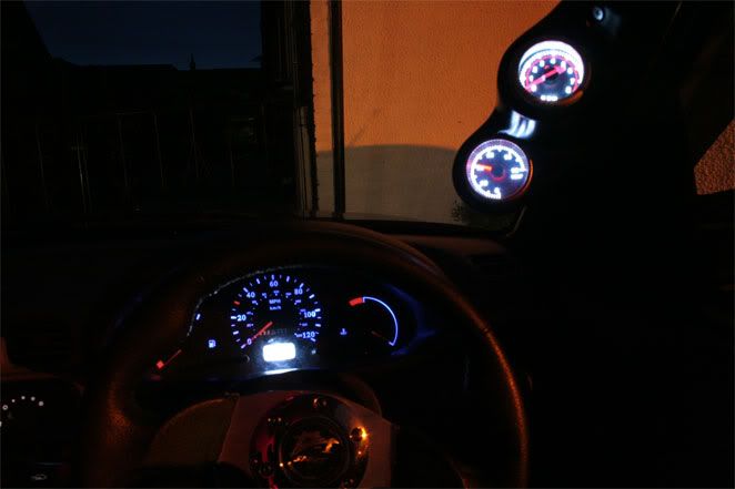

Update with a new mod/addition:
Arty Shot :p
It was quite difficult getting the camera settings right,so the dials didnt glow too much. Will have another try another night.
they look good mate but they look a bit high up or it might just be me being a short ass lol what are the dials one is a rev counter whats the other one showing

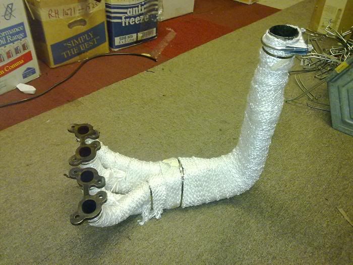

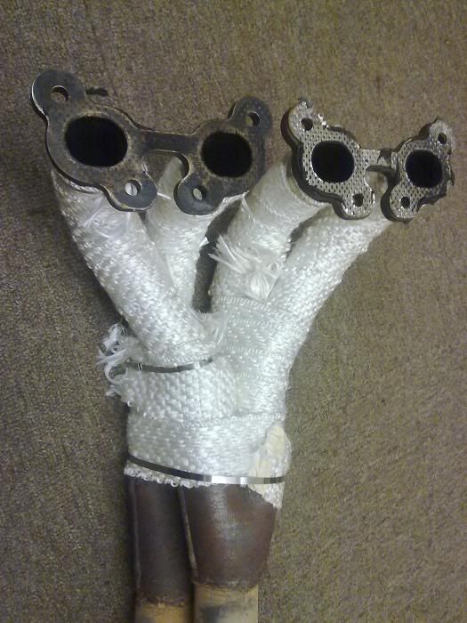

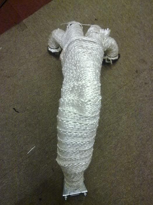

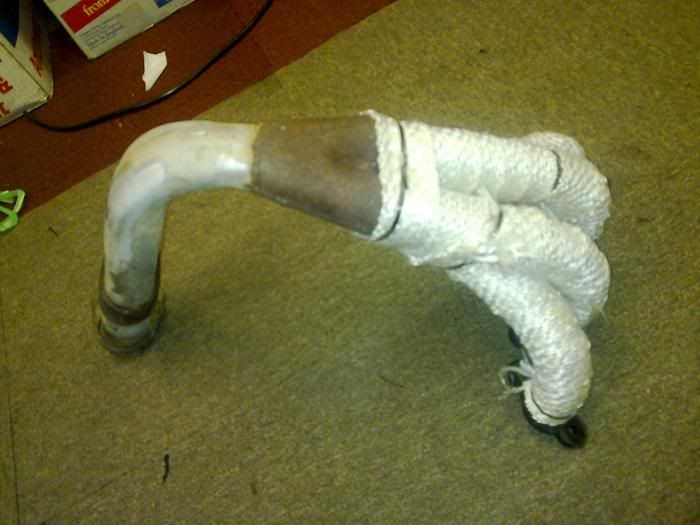

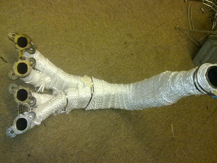

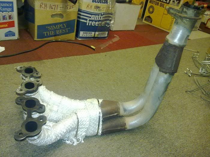

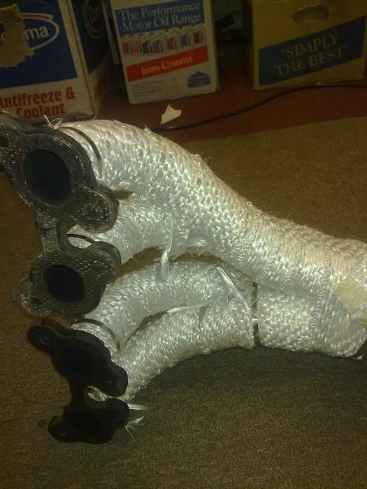

I recently received an Ashley 4-2-1 Manifold (Many thanks to Jowley!) and today at work got the Heat Wrap out and made a start:
Not bad for a 1st try :) I've got another roll on order so should be here tomorrow or early next week
Popped over to a mates today to have the Manifold fitted,decided to remove the Air Con while we were at it aswell.Managed to remove the A/C pipes & Rad,slackened the Alternator,removed slam panel ready to make room for the manifold.
Managed to get the manifold in,but it wouldnt like up to the studs. The alternator was about 1/2 inch too far in,stopping the manifold. Seeming as we've removed the A/C,we're gonna remove the A/C pump,put on a shorter belt. We also need a new bottom Alternator bracket,as the NON A/C Micra has the alternator lower down in the engine bay.
With a new bracket,it'll allow us to move the alternator further down,making more room for the 4-2-1 :)
If you're using exhaust wrap make sure that there's NO GAPS as this can cause a fire risk as the heat will be concentrated at that point, and it needs to be even all the way.
Each wrap should HALF overlap the previous, and do NOT wrap a mild steel manifold.
The pump should be removed tonight when we put the new belt on,new alternator bracket and manifold on :)
