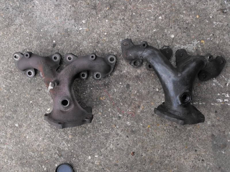

I'm sure if you talk too Frank ^^^^^^ he can sort you out with one of his modified standard manifolds.
You can see the ports are opened up and it can be nicely hidden under the standard exhaust heat shield.

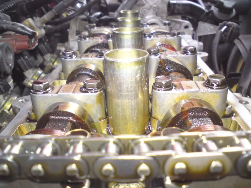

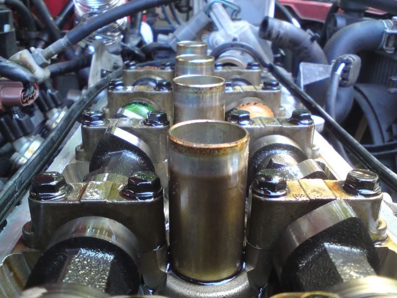

The 1.3 Camshafts fit directly into the 1.0 and make a nice difference too the engine with their larger profile.
Here.
1.3
1.0

seemes like an easy fix yes, but do you have any number on how high RPMs the engine can tolerate before it gets unsafe? Ive seen 7,4K RPM, but thats it.. and Ill check the junkyard nearby monday if they have a 1,3L micra lying around I can jack the cams from

So I went to the junkyard a couple of days ago, and Lo behold! First think I saw when I walked through the gate was a Micra! I asked the guy working there what engine it was, and it was a 1,3l! 1 hour, a lot of blood (bad tools :( ) and sweat later, I got myself a set of new cams! I delivering it to a specialist shop tomorrow so I can get it a bit more lift out of em ^^ I'm contemplating if I should go back and yank the power windows out of it as well, since my car don't have it.. shame the car didn't have a front bumper, since I want one with fog lights attached..
