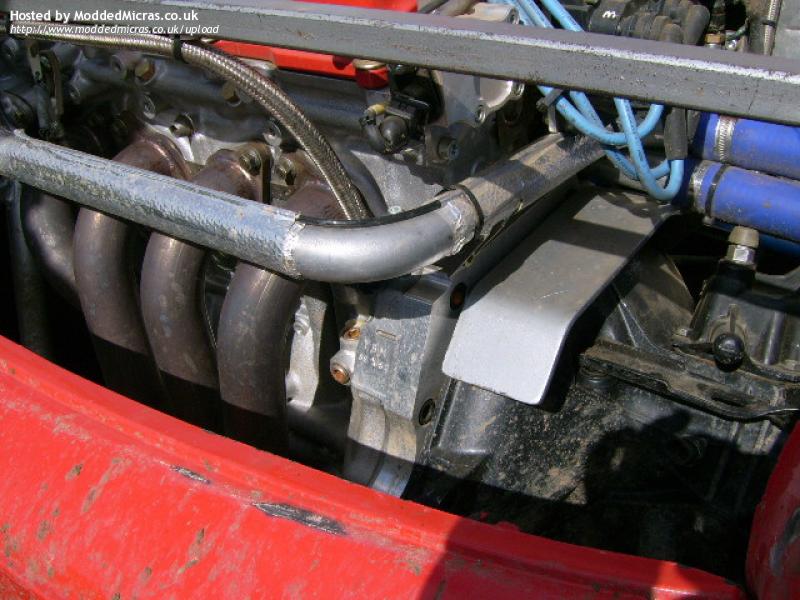

Ok I dont have a MA10 without a box attached and i cant be bothered to undo it, so I tried a ST box on the CG10. It fits perfectly. What I cannot tell you is if the starter will line up or not. I presume it will..
So people with K10s who keep blowing gearboxes a CG13 box may very well be an option (nice to know since I keep blowing the ST boxes and parts are hard to find..)

Well I can tell you now that I picked up the ST box and every bolt lined up with the CG10 block. I dont find it amazing really as a bluebird 1.8 FWD box also has the same bolts, also they are all beased on the RS5F3xx gear set.
