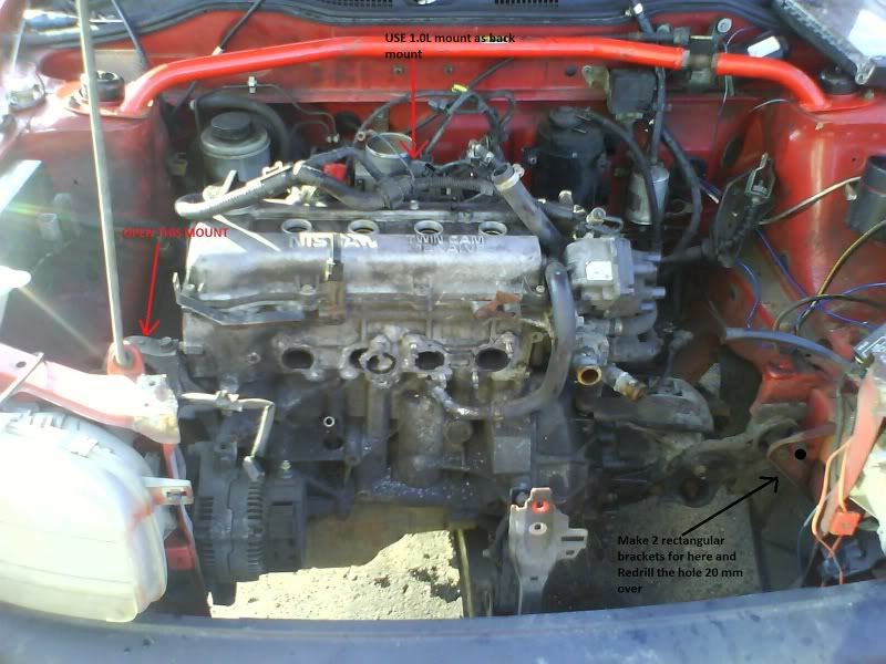

cant you just move the centre member over that 20mm too?? might affect the linkages etc
captive nuts welded into the floor eh stani, far easier to use a strip of 5mm plate to shift the rubber over imo (and welcome back to the darkside btw :grinning![]()
for all it will take to make a front mount
frank what you waiting for, get it done. we know you can do this in 1 day![]()

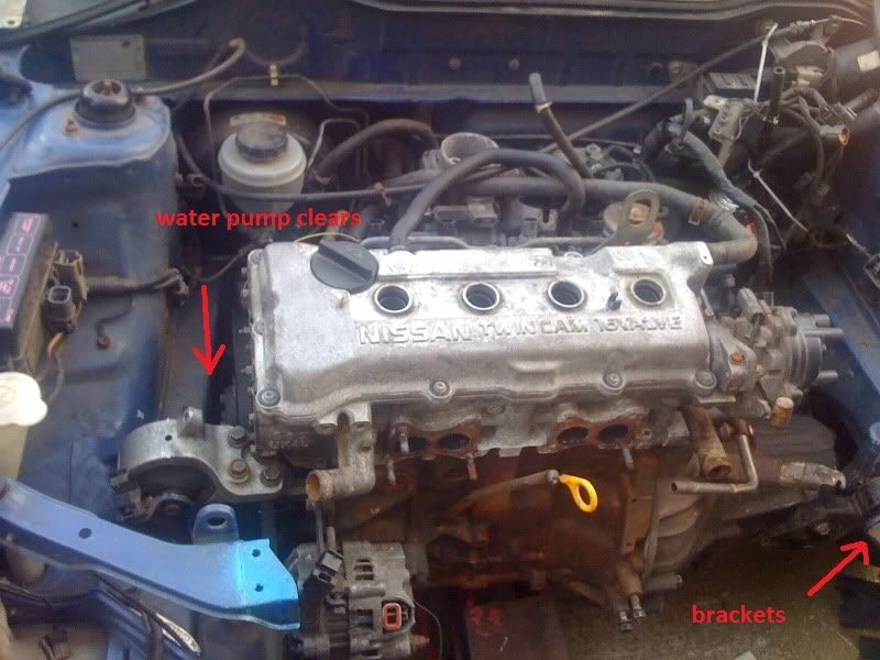

if you look at the pictures you can see the parts that need work. as the engine has been moved over 20 mm then people say you need drive shafts. well this is not true as frank covered ealier in the thread there is about 40mm of space to play with on each shaft means that the original 1.3 shafts fit without modification. You only need to make a front mount but its not necessary to do this. hope this helps a few people.
here,s a pic of one with a chassis cut
next, ive not done a full sr20 swap i just finished one off as im shure you know it takes a liitle more to fit one, i personaly would fit a GA16 over the sr20 for many reasons, more easy, less wireing, weight (as heavy engine up front in a small car handels ####!) and for me and what ive read and talked to other people about is that the GA16 is a stronger block for turboing
