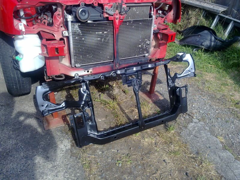

picked it up toady and its the WHOLE front section, from headlight mounts to lower radiator support.
ill post a pic and give progress of it being fitted, im a little skeptical about the quality, so we will see.

Nah, forgot to add that.
it looks OK, but the genuine one has a little more groves stamped in it, so i would assume its stiffer.
I'm weighing up weather to unpick the lower beam, or change the whole front.

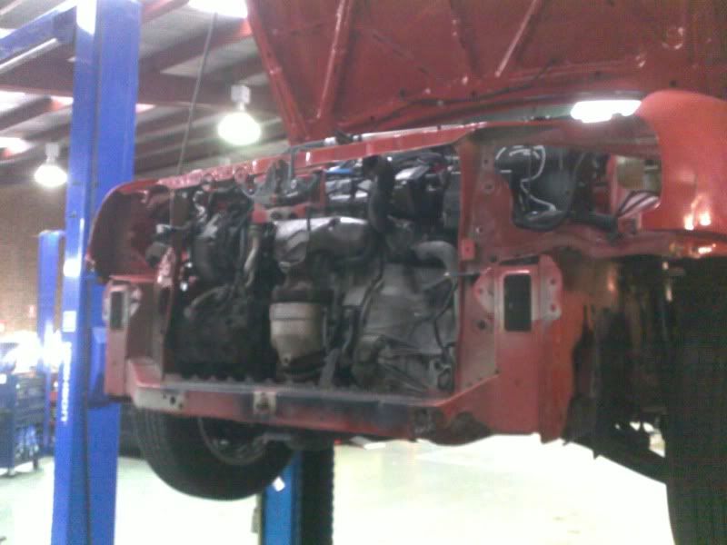

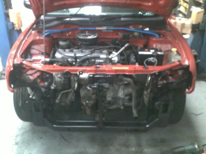

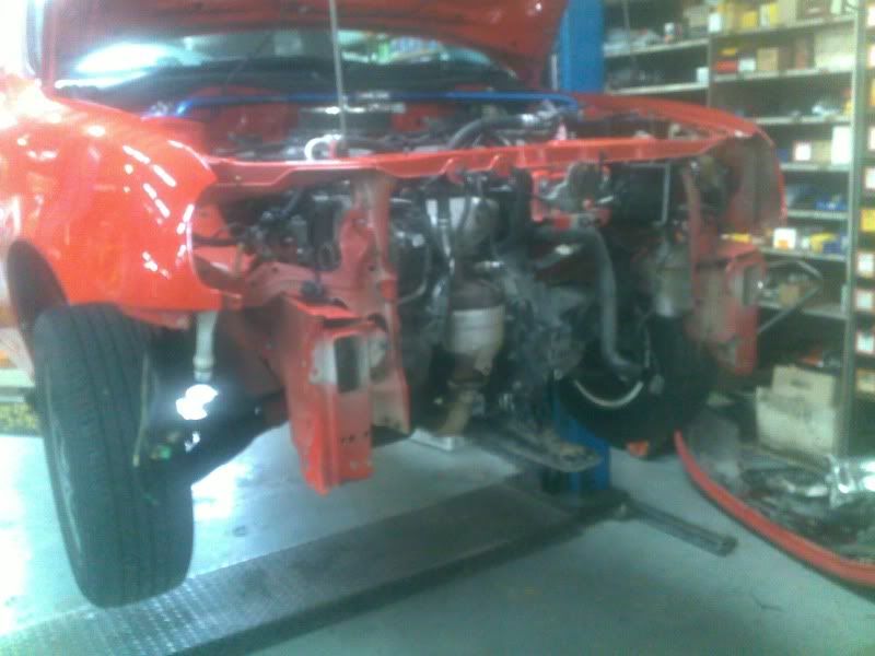

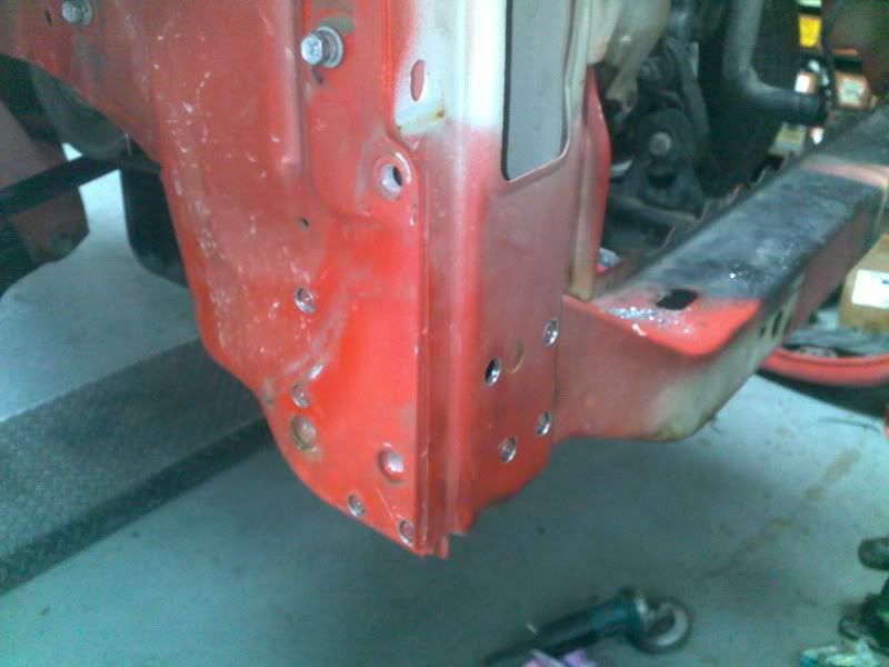

Using a spot weld drill bit, removed the lower piece only.
hope that helps...
Sorry bout the crappy phone pics at the workshop. my replacement part did NOT have the two little nuts welded into the bottom where the tow point bolts up. and i didnt realize until she was 90% back together.

i dumped the A/C and removed the condenser. i wanted to change the coolant anyway.
took me most of the day, by my self.
if the car is straight (no accident) its not too bad of a job.
the tow hook, its now what you call, for decoration only.
people say the two bolts holding it vertically will be enough. i doubt that.
if you all check it before you fit it, you can tack weld some nuts inside the lower section to be sure.
