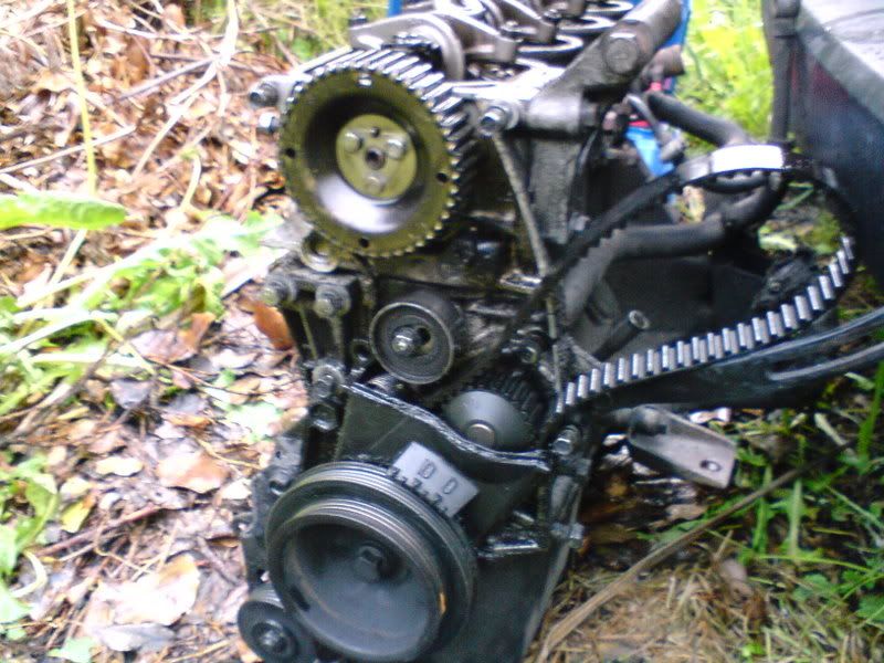

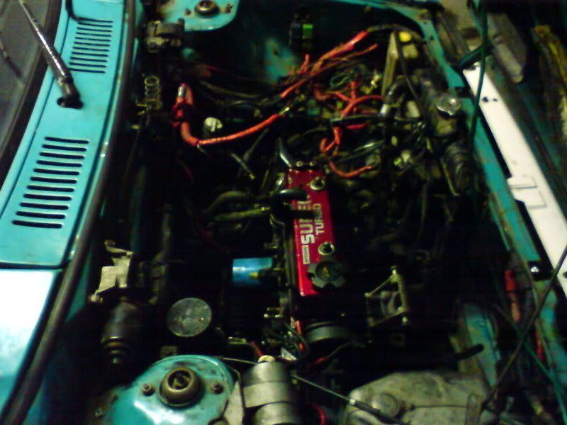

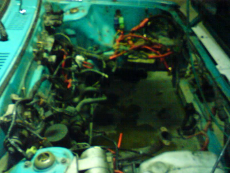

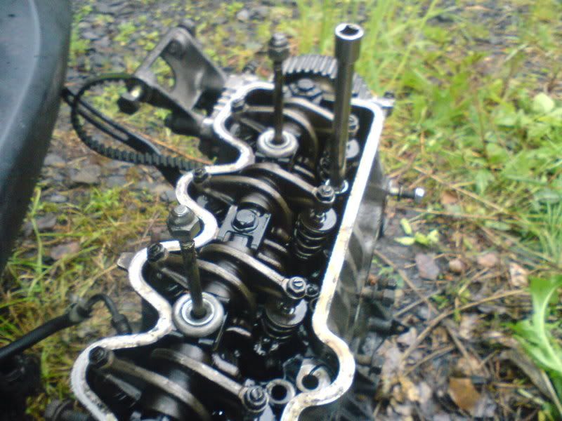

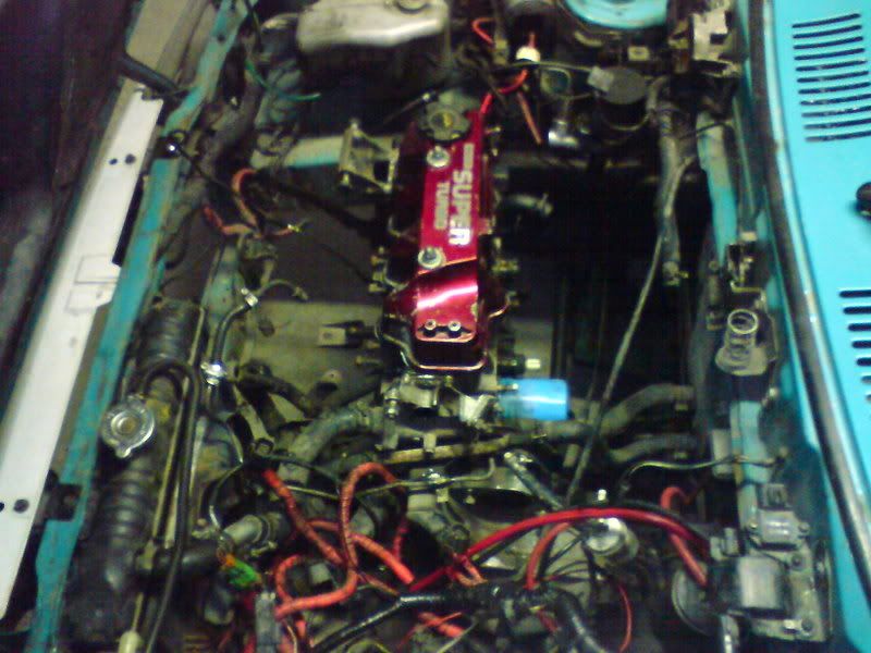

Got most of it striped 2saturdays ago so just had to drain oil from the engine and gearbox then take it all outbt:)

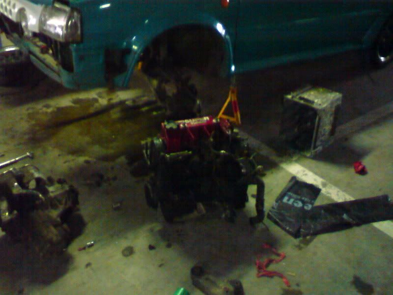

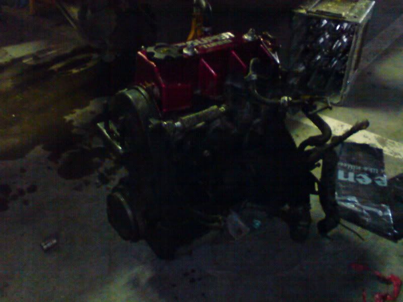

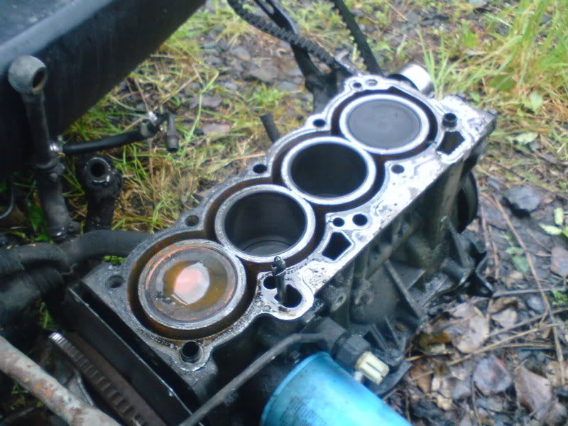

Got the engine out today here's a few pictures on the progressbt:)

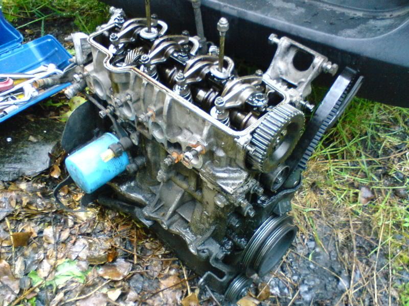

Engine!

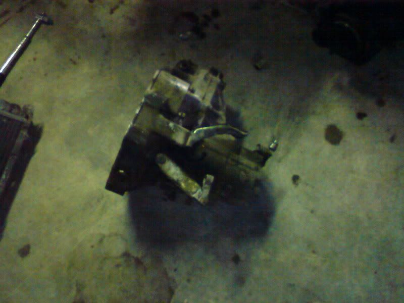

Gearbox
What engine?

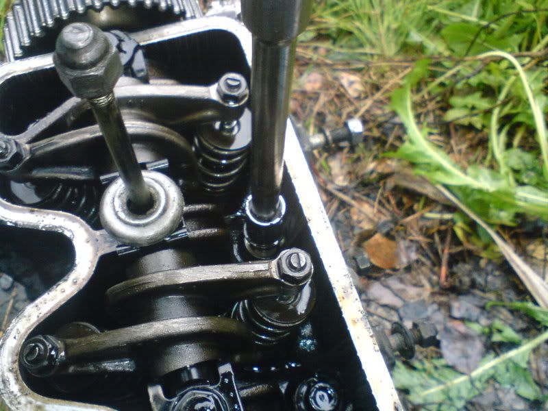

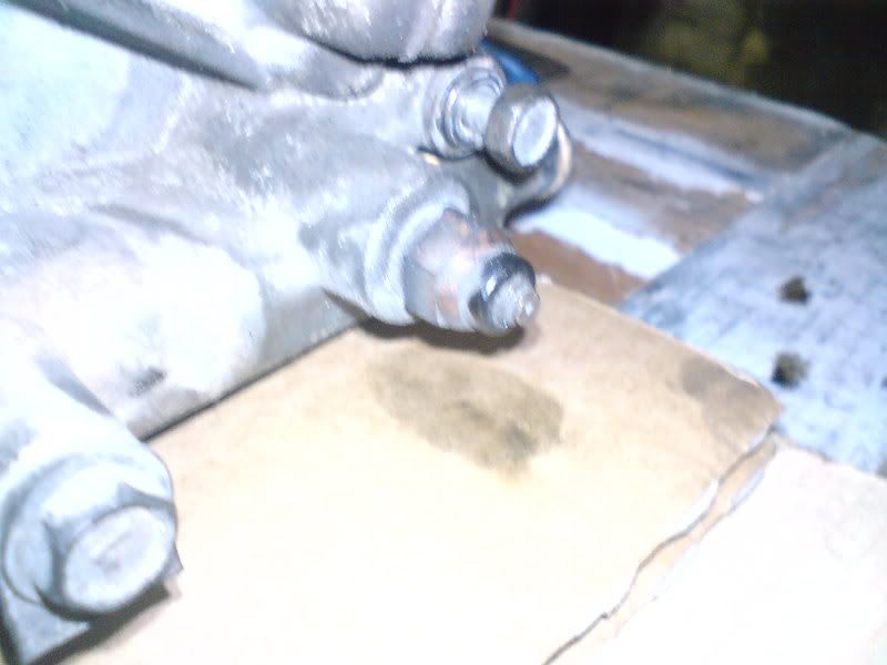

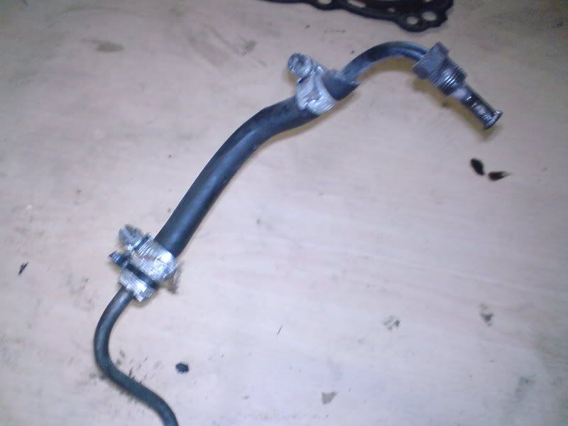

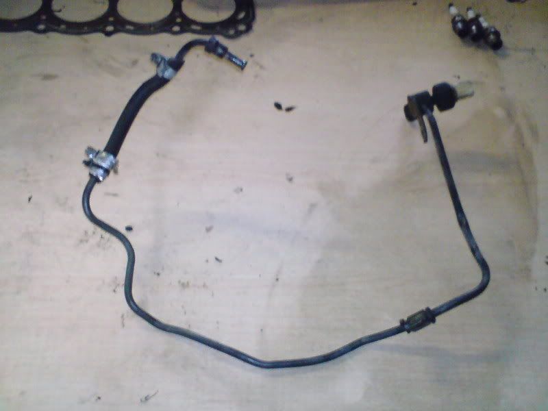

Broken Oil feed pipe. . .oh thats why it dicided to eat a turbo!

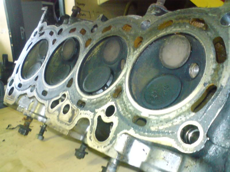

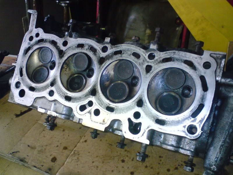

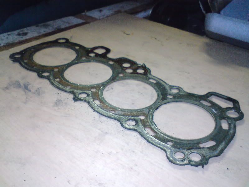

Head gasket actually in good condition

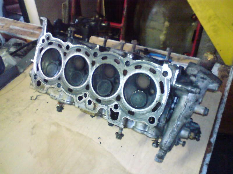

Water temp sensor terminal snapped off!
You should also glaze bust it and put in new rings, however then you will discover that nissan does not make rings for them any more....
Yeah they are discontinuing quite alot of parts now. . .compression was good on the engine its the big end bearing that have gone due to low oil and probably needs a crank also
