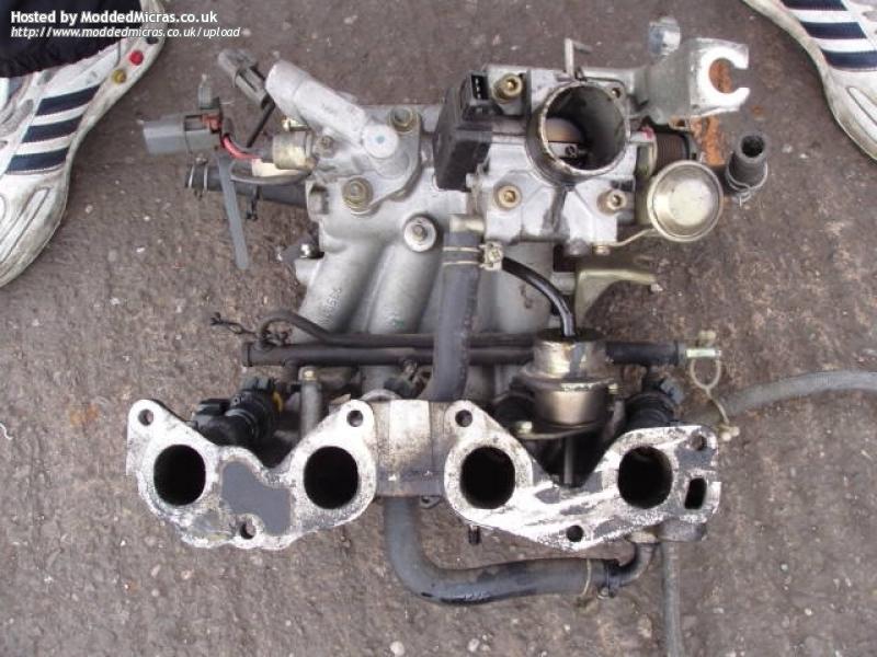

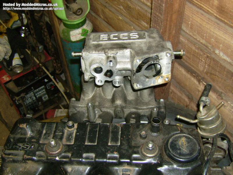

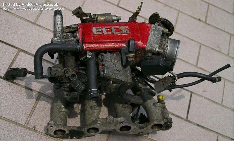

ST is 109bhp stock, FIG is 75, and its much more than just the intercooler. All the ancillaries on both engines are compleatly different. I have a fig inlet manifold in the garage which I simply got for comparison to the ST. It really is entirely different.
would i be right in thinking thats probably because the ma09ert was built from the gound up (or at least more so than the ma10) where as the ma10t is just a ma10 with some uprated internals and a turbo slapped on?
(Im getting the impresion that its different to the K10 inlet manifold...)
Whats the figaro inlet manifold like?
Can you poist a few piccies of the figaro manifold?

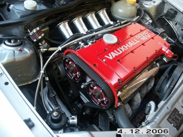

when i had my k10 super s i contacted a few places about getting a c20xe engine in, by far the best idea, theres plenty of places which will do the conversion and a lot of people know how to tune them and theres plenty of parts avaliable,
if your gonna do an engine conversion then you may as well do it properly
