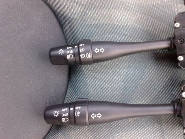

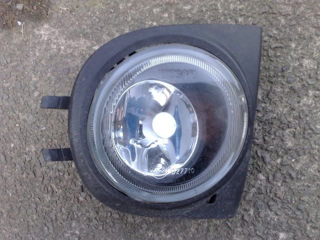

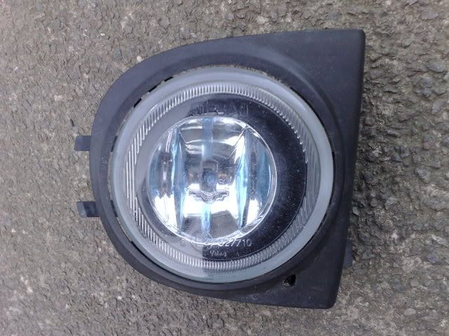

so i fitted a non f/fog light stalk, wired the fog circuit into the main beam and removed the cap from inside the fog lights that covered the bulbs that helps keep them 'dipped'.
hey presto, now i have genuine nissan driving lights that come on with main beam:D. although i may wire up a seperate switch to 'alert' other drivers that they are driving with their fogs on when it's not foggy. ;)

fog lights are like a dipped beam, that's why it's easy to convert a fog light to driving light on mine due to the cap over the bulb not letting light from the bulb travel forwards and the shape of the reflector keeps the beam dipped.
you'd need to make the driving light into a dipped fog light, and that'd be quite difficult.
