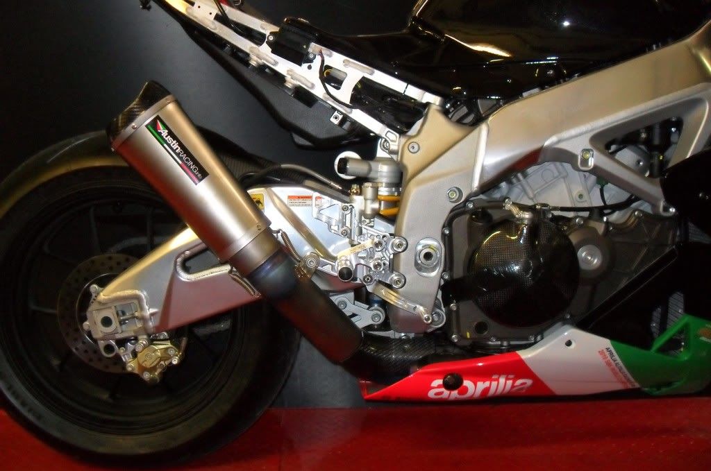

this is the can. its an Austin Racing GP2 open can for a Kawasaki ZX10-R. my brother races national superstock 1000, a Litre bike support series fo BSB. he was in spain testing the new bike and had a bit of an off. basically the only damage to the can is to the carbon-fibre end-tip.
big smiles from me!!!!!!!!!!!!!!!!!!!!!!!!!!!!!!!!!!!!!!
