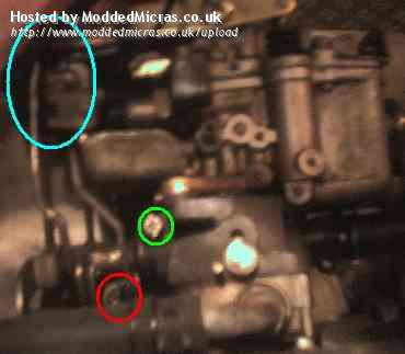

I'll see if I can get a pic or two tomorrow, it's not the most obvious adjuster! Remember when fitting the black cap there's a lug which you need to engage in the end of the spring...

Speaking of James Bond cameras, that's what I'm using :) Hence the blurry image!!
The blue circle is the black disc on the back, the green circle is the idle speed screw and the red circle is the choke adjust screw. My advice would be to take the carb off, it's pretty simple. That's how I did it hence why I thought a description would do!! Follow the steps above & you should be able to see the lever that stops the cam move.
