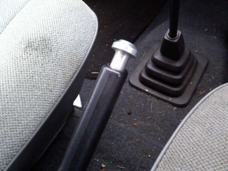

Jdm garage drift button, fly off handbrake mod :D

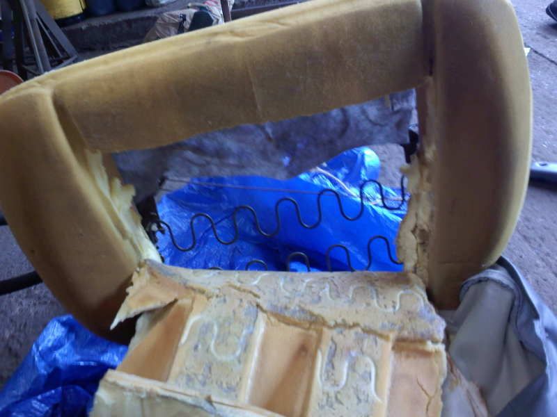

Heres the seat, pretty damn shoddy but it gets me slightly lower and held slightly better, and it doenst look very altered.
I removed all the springs ect and welded in a piece of tin to sit on lol
I will change these for some cobra classic when i find another one, i flattened one out when i rolled my mini years ago.

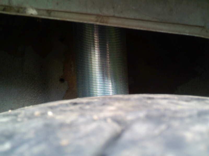

Well it turns out that mk2 golf rear coilies are a pretty bad fit on a k10 micra.
They shock b odies are just too long by about 4 inches, i can make them fit but it isnt ideal at all. I have one on at the mo and damping is massively better its just a shame the shock is leterally about 30-40mm from the ground :( looks like i need to raise the suspension about an inch or two
Nevermind, at least its an improvement and iam sure the fron.ts will fit better :)

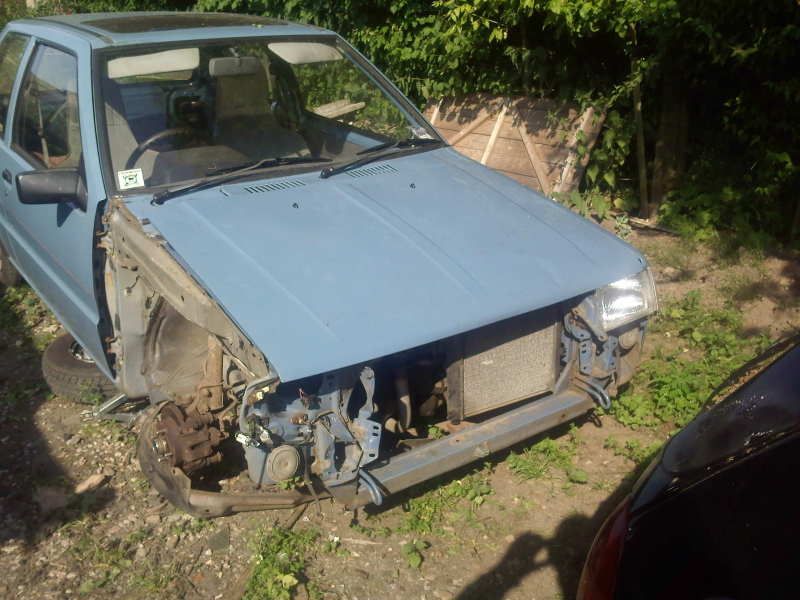

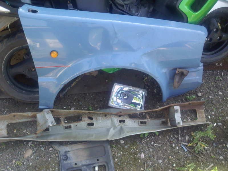

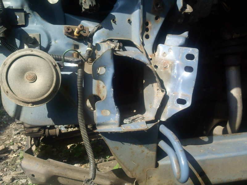

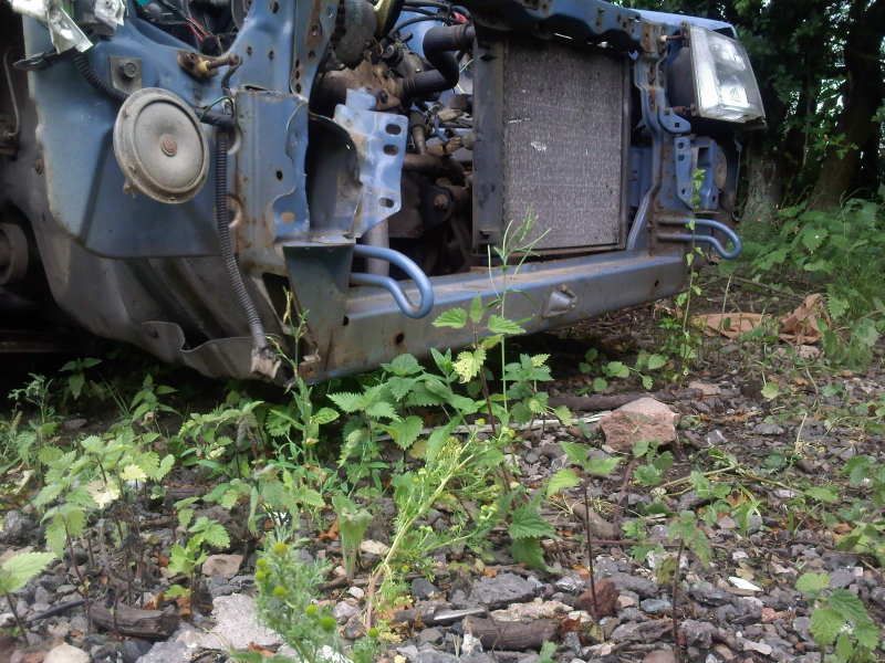

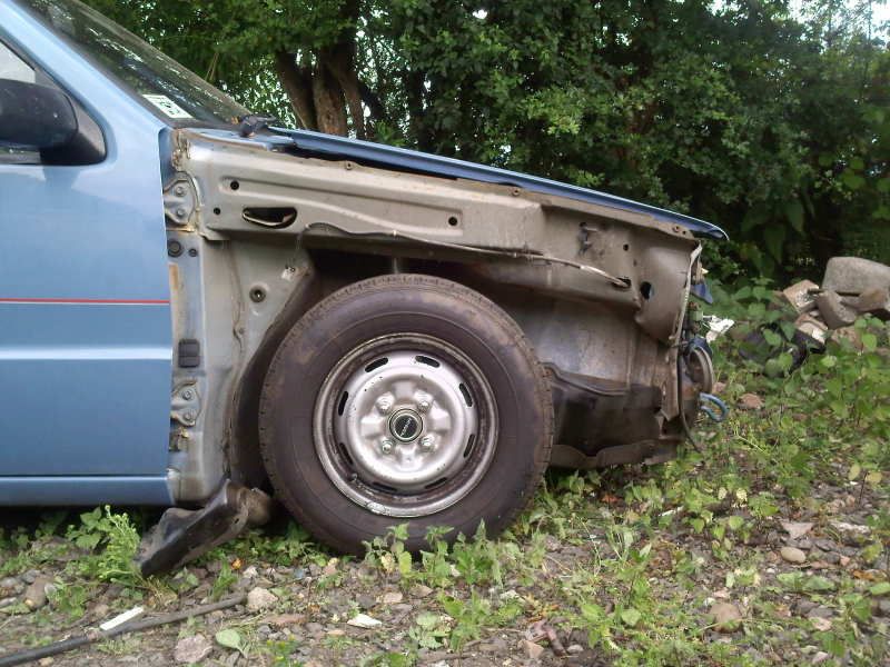

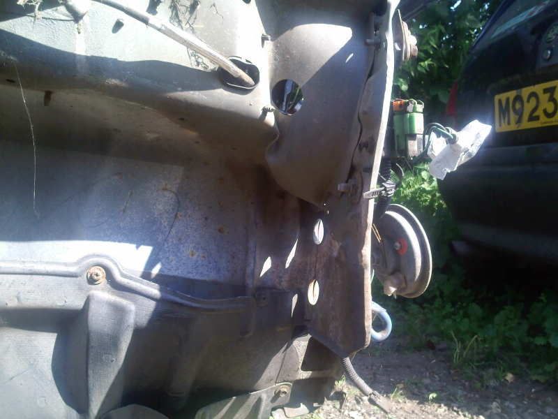

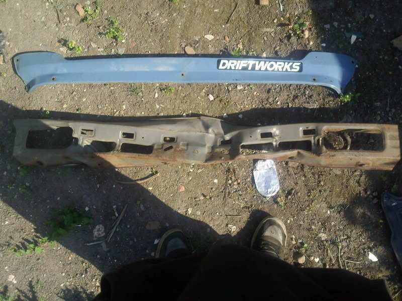

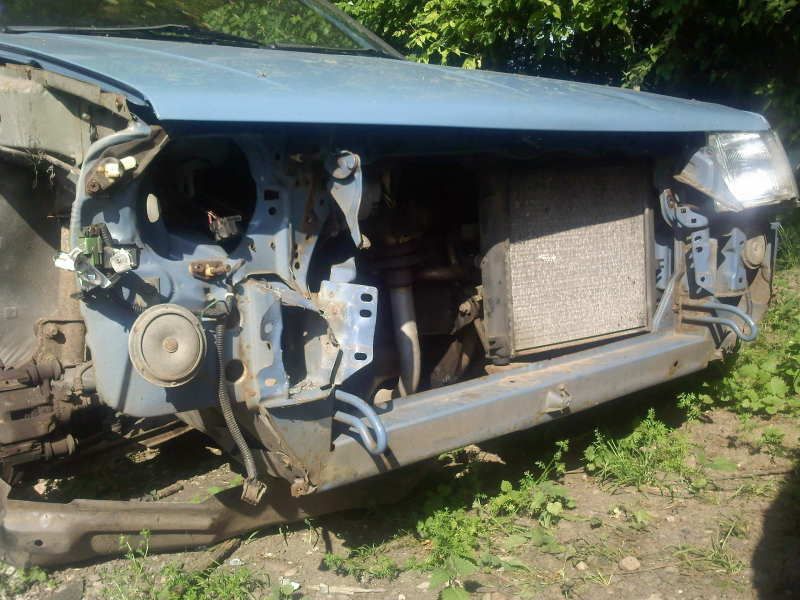

I may have to call it a day and scrap this car :( i have been looking for the parts I need to repair it since friday.
I need driverside headlight, indicator, sidelight, wing and also bumper, bumper bar and bonnet.
Well that and just spending out on golf coilovers that cant be made to fit without MAJOR mods, has pretty much killed my enthusiasm :(
kev

Thanks for the comments guys, i think as i have spent some money and have 11months mot ect i really should try my best to sort this one out :)
I have a corsa that i can drive until its fixed. I have a few plans so watch this space, iam going to get some pics tonight and think about some ideas. Basically iam thinking that if its off the road i can carry out more mods :)
Also i think i can save the front end, it may look a bit battered but i reckon i can make it suit the car + iam a drifter so iam used to having smashed bodywork :)

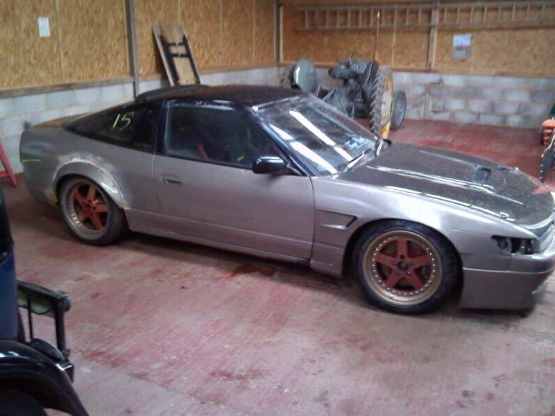

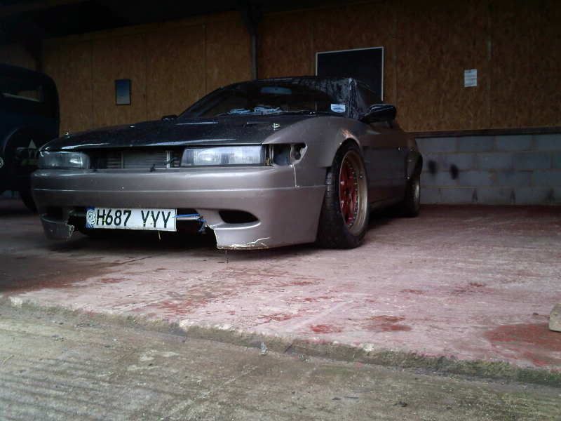

Here is my drift car :) excuse the rear arches they were just temporary measure lol
Its has 300hp skyline engine which ill be tuning up soon, i hope to revamp the whole car in the next couple months, thats why iam annoyed because the micra is my daily driver grrrr

That car is sweet if only i could afford to buy one n run it :( is it an s13? n is it the rb26 or rb25 engine? not that it matters cos its just seriously cool :) I ave almost lost patience with my k10 but i made a list n now im getting back to it. the biggest set back was when a lorry decided 2 re model my n/s/f corner :p its ok now though ;)
correct me if im wrong but isnt that a sil-eighty? how can u lose inspiration? If your bored work on the s13 when you tire of that work on the micra or if you become really bored buy a redtop for the corsa lol either way cool projects and an additional blog shud be made for the s13:grinning: I really want another done but need to get my k11 done first
i'd love a toy like that..how much does it cost to get a nissan like that and set it up for drifting??or are they pretty capable as standard?

haha thats a pretty sweet weekend car Kev! Though I dont know about the rear arches :wow: :laugh:
Shame about the prang you had in it, just get the hammer and zipties out :D
Yes matey its an s13 with an rb25 slighty tuned to 290hp but it needs a remap badly. Iam rebuilding this car atm because its tired in places. Will be more power and better allround when its done.
Yes mate its a sileighty with a supermade instant gentleman kit. I have plenty of inspiration just need time and money :( lol

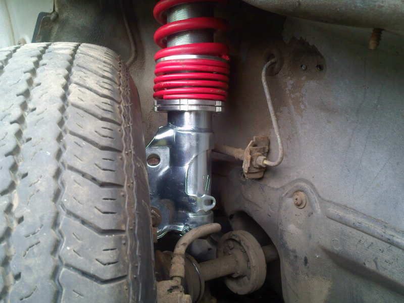

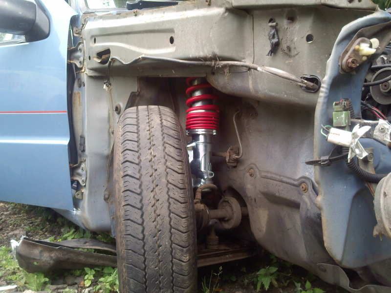

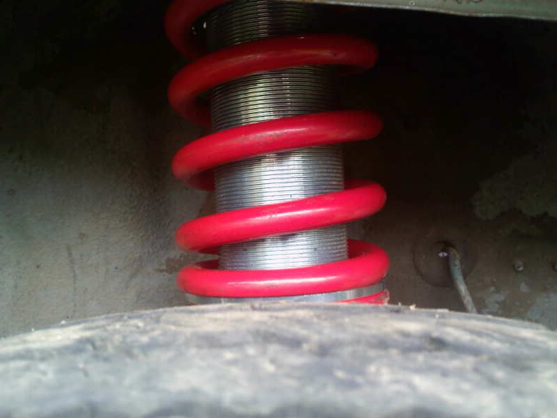

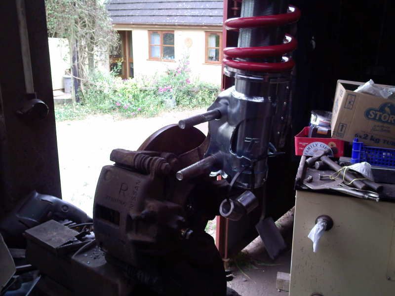

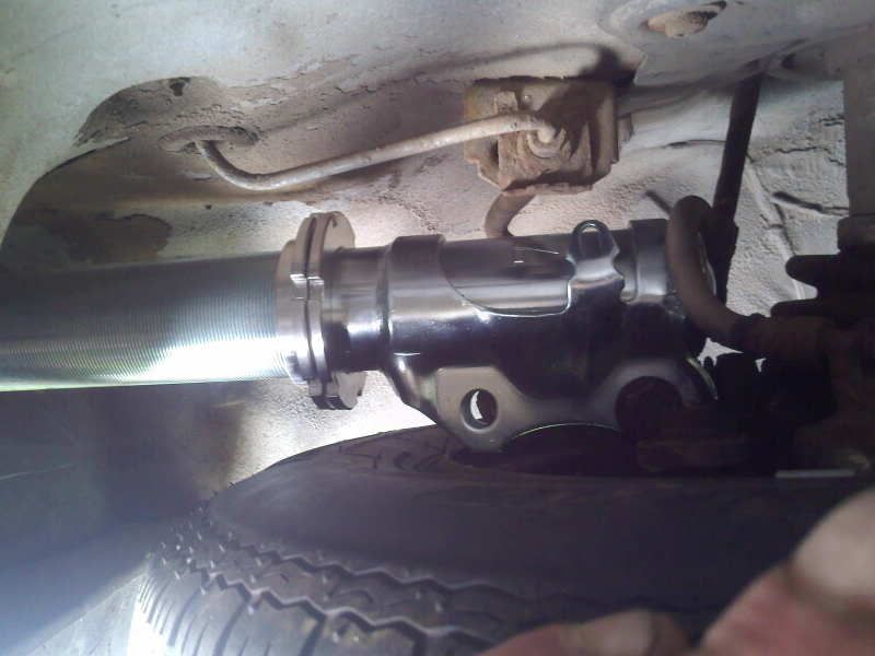

Nearly got the front coilovers fitted. I just need to mod the knuckles so the bolts line up nd i also need to make some kind of topmounts. Ill try and use the original ones first.
This is sat on the stopper/driveshaft so is plenty low enough on the front, will need to turret the rear struts to get them to fit ok :nod:

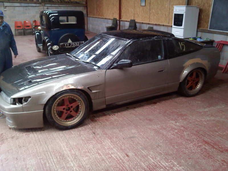

A couple more pics of my drifter.
Iam about to build another one thats very basic for practice days whilst i overhaul the main drift car, ill put up a blog for peeps to follow so they can see how cheaply it can be done :)

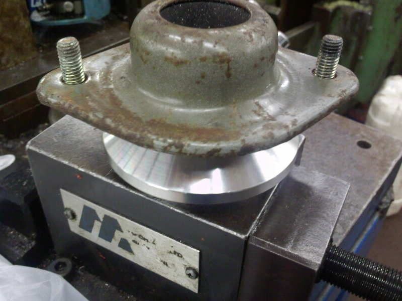

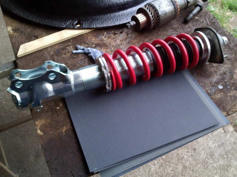

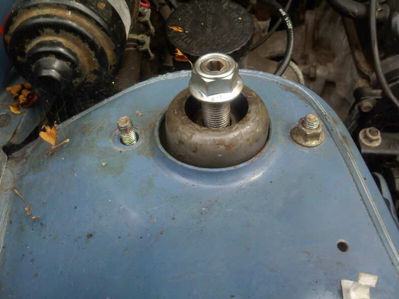

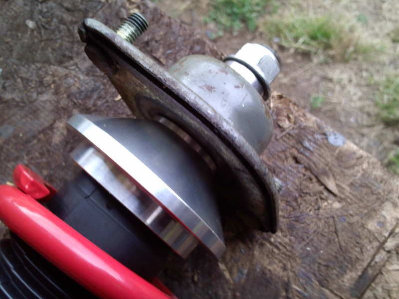

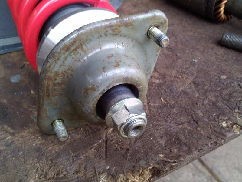

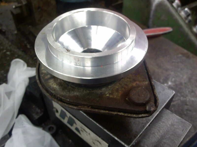

SUCCESS :) i took off the front topmounts and managed to drill them from 10mmOD to 14mmOD :)
which means the coilies are now pretty much fitted on the front. just one bolt hole each side to sort.
Pretty pleased with it tbh full bump is retard low though :D

And yes they are mk2 golf coilovers that cost me 162 delivered from belgium off of ebay.
Although the rears are a bit too long by about 3 inches :(

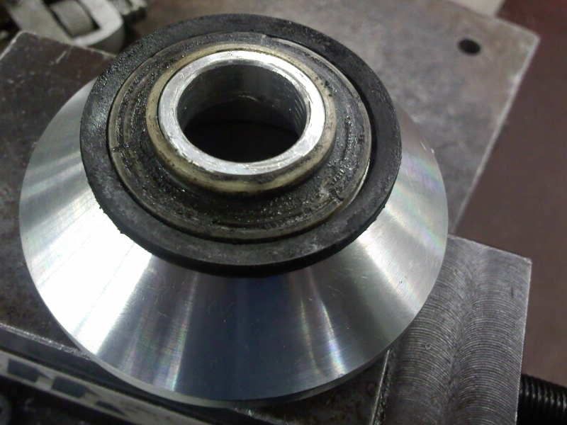

And i got more done to the topmounts, i had to machine a spigot thing on the top spring seat so that the nylon washer fits and it all assembles nicely now.
I cant decide whether to mod the car or get different rear coilies, i have the materials too turret the rear :)

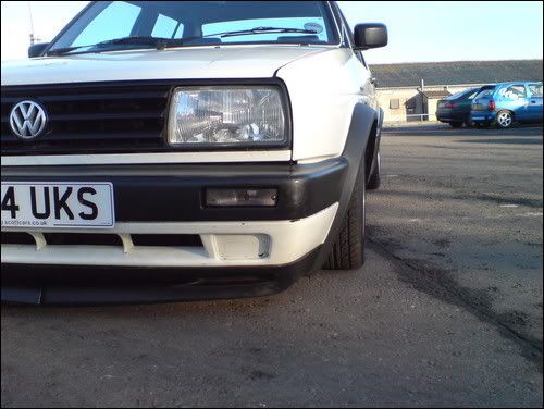

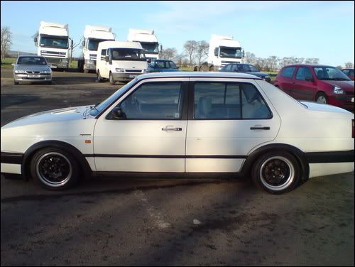

Funny you say that mate. Someone posted this on my sxoc thread.
i wish i had seen this sooner...
If you bought mk4/5 (6n/ 6n2) coilies you could lower the car another 40-50mm at the front or upto 100mm at the back
So on a mk2 golf platform your looking at lowering the car upto 170mm up front and 220mm at the back.
See if you can send them back for polo ones as it will..
a) make you lower
b) give you more suspension travel
c) make you silly silly low on that wee micra!!!
i fitted mk5 polo gti coilies to my mk2 jetta synchro a good few year ago. fronts were down 80mm and the backs were down 50mm and it was slammed!!!

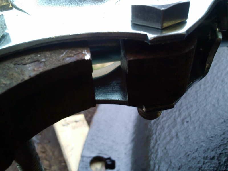

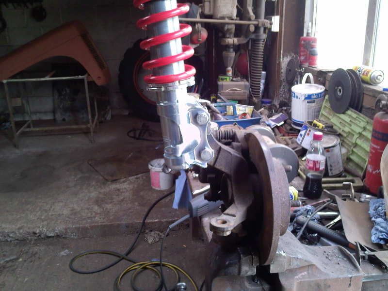

Hubs almost finished.
All thats left is too make the steering arm shorter for quicker steering and too investigate whether i can flip the arm over so that the track rod end bolts in from the bottom rather than the top. This will help to correct the poor geometry of the seriously lowered front end which will help reduce any bump steer. I need to take some measurments to make sure it isnt too extreme.
I allso need to get new track rod ends and lca's. Will probably fit braided lines as well as new pads and discs whilst iam at it.
