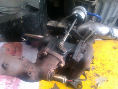

Tonight Iam gonna make a start on the new engine.
Hoping to take off all the ancillaries that aren't needed. The new enginr has inlet and exhaust assemblies fitted so that'll need removing also.
If I have time before dark ill get the head off also. Is there any tips or tricks I should know before I get stuck in? I have never dealt with ohc timing chain engines before! On A-series and cambelted stuffs.
Once its broken down into components ill be able to carry bits too work for quicker progression
On my lunch break today I decided to go and make a start on the new engine.
I managed to remove exhaust manifold, dizzy, loom, power steering, rocker cover, alternator and bracket.
Tonight I may get the head off! Depends how quick it gets dark :(
Then I took the alternator bracket and rocker cover too work with me. I started to machine the alt bracket too make it lighter a' la Frank stylee :)
Also machining the writing off of the rocker cover :)
The new engine semi stripped down
Half finished alternator bracket. Need more time at the milling machine :)
Rocker cover almost ready for paint, bit more cleaning needed
