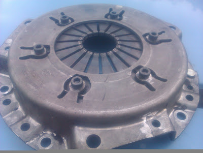

Looks like Iam gonna have no choice!
what do I need?
Cg10 cover
Cg10 friction plate
cg13 friction plate
what size bolts to replace the rivets?
I guess I just need to die grind the cover a little and face off the flywheel to remove lips?
anything Iam missing?
getting scrap parts tonight so I can have a play around![]()
has to be factory LUK parts kev, and m6 bolts, and i shaved the 1 side down to 170mm so that it fit under the pre-98 1.0 cover and mate with its face
